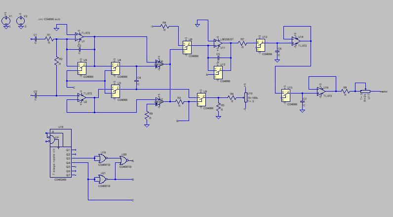

    I will try to extract the meter circuit from the Big Bud schematic. Try to understand what's going on there.

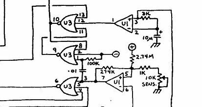

      Another interesting approach without a micro. Uses comparators to measure the ratio of X and R.
      https://patentimages.storage.googlea.../US6421621.pdf

        I've done a preliminary sketch of the Big Bud meter circuit. Still need to figure out few details, but the actual barebones circuit can be seen here
        What is interesting is that this circuit somehow is integrated with a CD4024 which in turn appears to derive it's clock from the TX oscillator. Incidentally, the TGSL also have a CD4024 counter running from the TX oscillator. Both big Bud and TGSL use half wave demods.
        So this big Bud meter circuit might actually be a better candidate for adaptation to TGSL.
          Yes, I remember that patent. Never got around to making it. But I remember someone had made it using LED and posted a video. Seems to have worked pretty good.
          The Big Bud also is using comparators in the meter circuit along with some sequential switching.
          This method apparently worked quite good.
            Back in the olden days before TID this is how variable disc was done. Put a pot between X and R and vary it to set the accept-reject point.
            The patent above "digitizes" the pot and creates multiple discrete TID points. You pick the resistor values to determine where you want those points to be. It's called "flash phase" analysis because it exactly emulates how a "flash ADC" works.
            Another way to do it is to digitize the X & R signals into a micro and do everything in code. Way more flexibility, and is how modern designs do it.

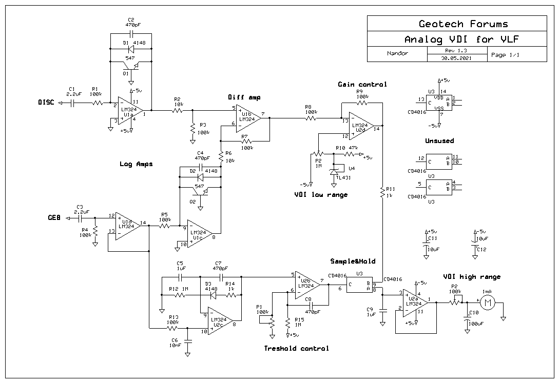

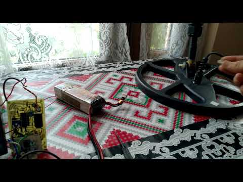

                          • It's alive and kicking finally!
                            Here is the test video of my final version. Did some modifications to the original schematic I used that was shared by Mr Gurdal. Working pretty good, maybe treshold level should be adjusted a bit more for better range.
ID:	361539This is the schematic I used. Little changes to the original circuit: BC547 for the Log Amps, 470pF instead of 330pF capacitors, VDI low range trimmer is now connected to minus rail instead of ground for more voltage setting, 1uF capacitor in the Sample&Hold part instead of 470nF and 100uF for the Meter not 22uF as in original schmatic. I will upload in the future some scope pics of the circuit.
