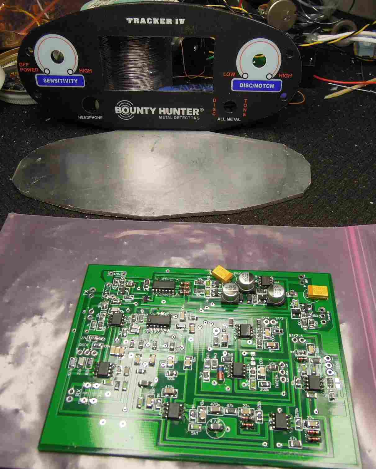

                          So here's the Bandito SMT board almost ready to upgrade the Tracker;

                          And a new Front Panel!
                            [ATTACH]29898[/ATTACH]
                            that's some upgrade

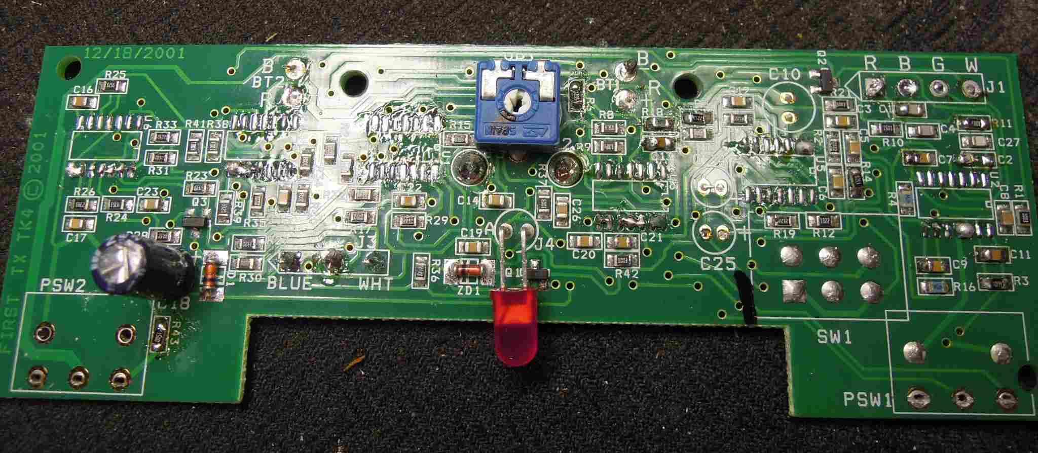

                              Here's the Tracker board stripped of chips so you can see the etches. Now I can pin it out fully.
                              But I'm not going to re install this board so why do that?

                              Now lets see where is that bandito board?...
                                nice work sd, scans of the board and pinouts may be useful, if not for reverse engineering, it may help repairs,after all, all correct information is useful information.
