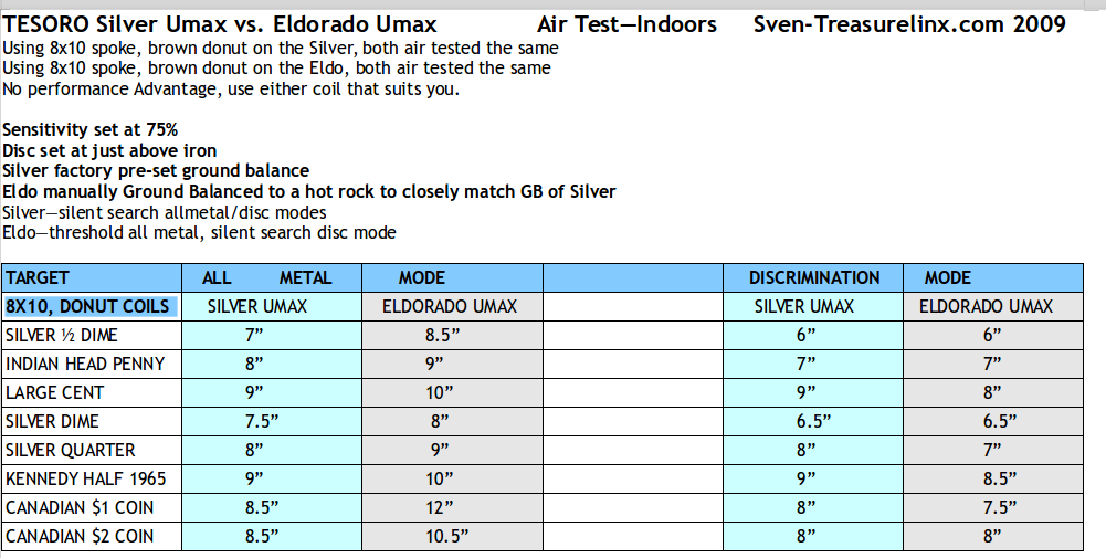

    Please note his Silver was a below average performance unit when it was stock. After modifying it was as good as the stock Silver I had. Tesoro is known for having a wide range of quality control OK for selling. You will get mostly an average , some below average and some above average performance.
    So if your Silver Umax in stock condition will get similar air test results as seen in my attachment, then its worth modifying. You'll see more improvement. Otherwise don't waste your time on it.
      Thank you very much for all colleagues, I think it's better not to waste more time, I learned a lot with you.
