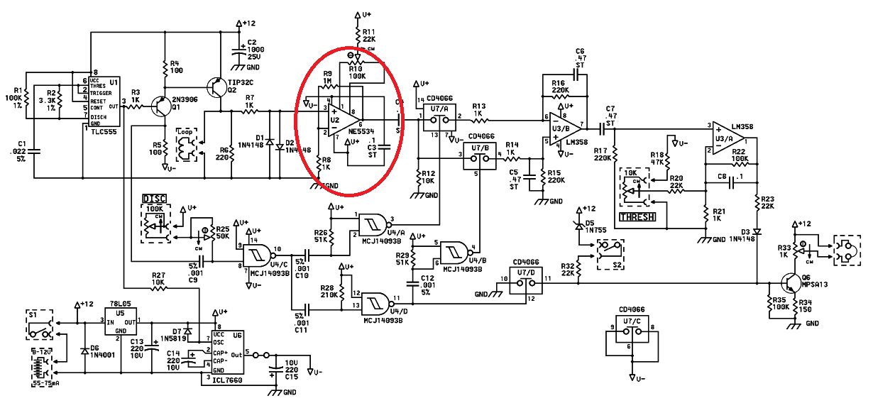

                          May be a dumb question but what chip on the board is the preamp? I'm used to working on radios and old tube gear.
                            The preamp is the first opamp the signal hits as it enters the board;
                              [ATTACH]36602[/ATTACH]
                              Thanks Bob
