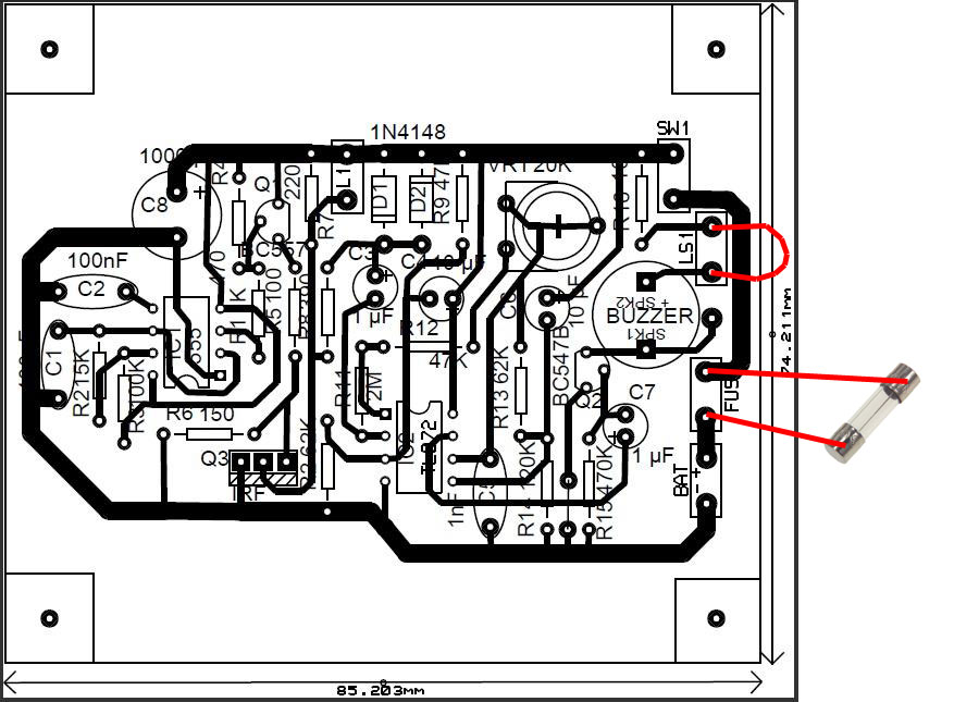

          Someone will answer me what those things where I remarked?

              This is the scheme found it here in the back pages
              • Originally posted by farafero View Post
                http://pics.data.bg/categories/1/%D0...08a46dd/2_silk
                Fuse and loudspeaker.

                  HOW TO CONNECT Click image for larger version
                  • so TNX !!!
                    • I did it finally. When you get close to the ground reacts constant soil Is this normal? When I tested the soil was wet after rain?
