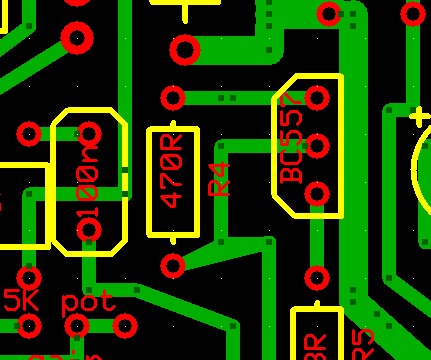

                • Tim,
                  I've reviewed your Express PCB design and I saw that you have to update the emiter connection of Q1 to the + supply.
                  In te components placement it is correct
                  But not in the Express file
                  So component values in the schematic don't agree with the values in the PCB drawing
                  José
                  • That may be so Jose. I have not had the opportunity to check or etch this pcb. It was just a concept when I had limited success with the TL072 version a couple of years ago. I hope you have PCBExpress available to correct any mistakes should you choose to use this template.
                    All the best.
                    • Tim,
                      Yes I am going to design a new PCB for a Pirat pinpointer. Although I think someone has done it before, I like to design my own PCBs. Yes, I will use Express, it is the SW I like more, and your design could be a good starting point, althoug I try to have a more slim PCB to adapt it in a pinpointer enclosure shape.
                      About component values, it looks like that those in the PCB are more coherent than the values in the schematic. But otherwise Eddy said he has used sucessfully these schematic values in the TL072 version. Perhaps he can provide us more information about this issue.
                      When I have ended my design I´ll try to provide the information.
                      King regards
                      José
                      • As starting point, here is the schematic drawn in Express PCB and translated to PDF
                        Any suggestions, errors, value comments?
                        Contributions are welcome, specially from those who have working the circuit sucessfully
                        José
                        Pirate_PI.pdf
                        • Here is the new schematic version with minor corrections, and the PCB design is finished.
                          PCB is 1" x 3,35". Here is also a Top cooper view and silk as advance of information.
                          I have two more projets on-going. These are a bit more complicated than RU-Pirat. When I finish both projets I will made the Pirat. When I test the working of the circuit I will provide the complete information. I don`t want to provide a PCB drawing with erros, I prefer test ir before.
                          In the mean time if there is any contribution to the proposed schematic it will be welcome
                          José
                          Pirate_PI_V2.pdf
                          Previa.pdf
