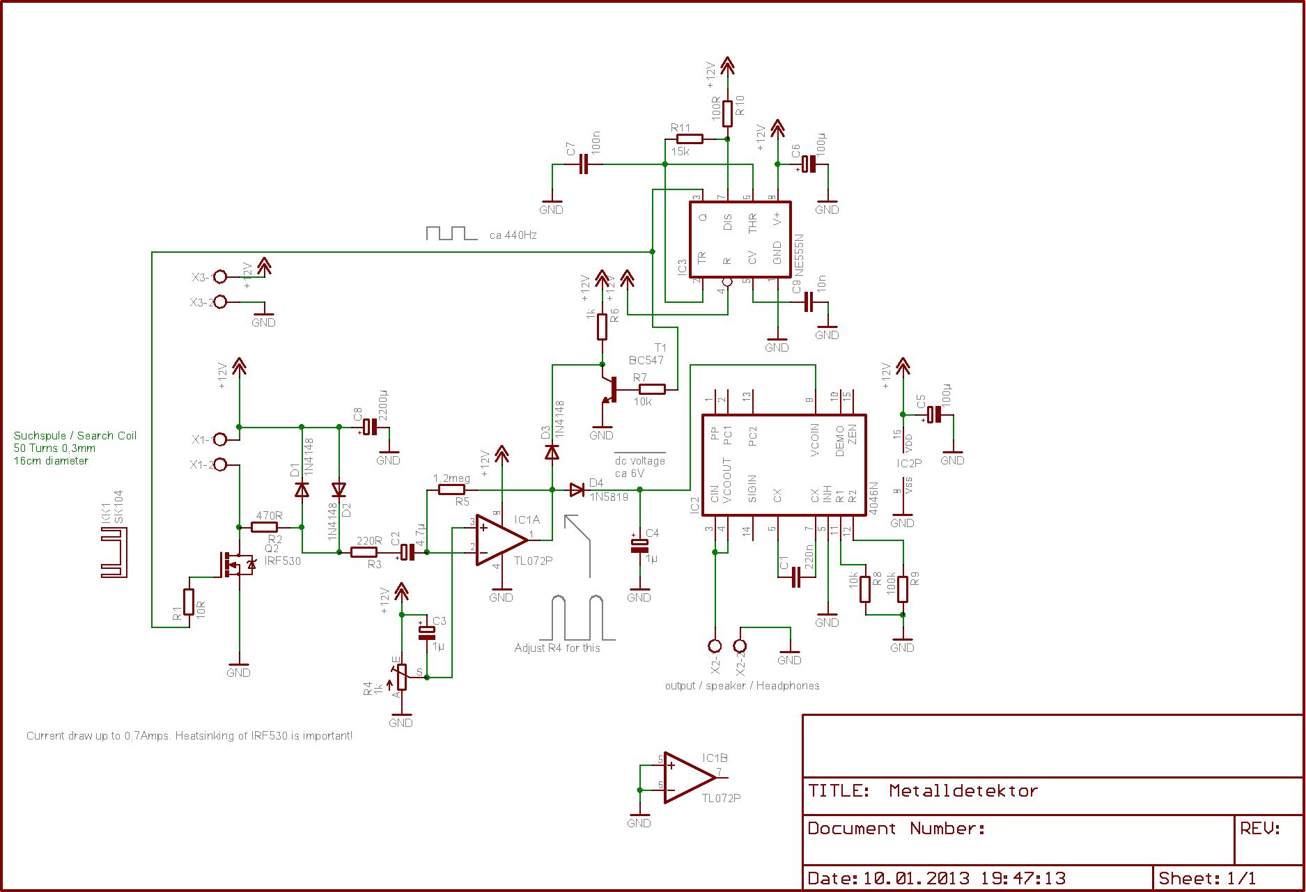

what is stability of this detector when you run it for long time?
and coil information (number of turns,wire gauge ) ?
is it suitable for large coils?
hi all I'm a new member and I read with interest all the posts for a simply russian MD.
Bernte_one has done a lot of tests. But is there a definitive project? can you publish it? thank you all

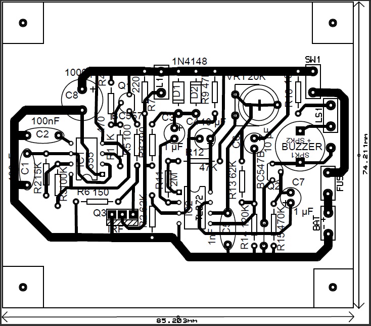

If you want to build the Russian Pirat then use the Layout with the K157UD2, it works better.
25cm for a 1 Euro coin. If you want more then build the surf pi or maybe the barracuda.
There are also Kits at ebay for the Pirat Pi with K157ud2.
