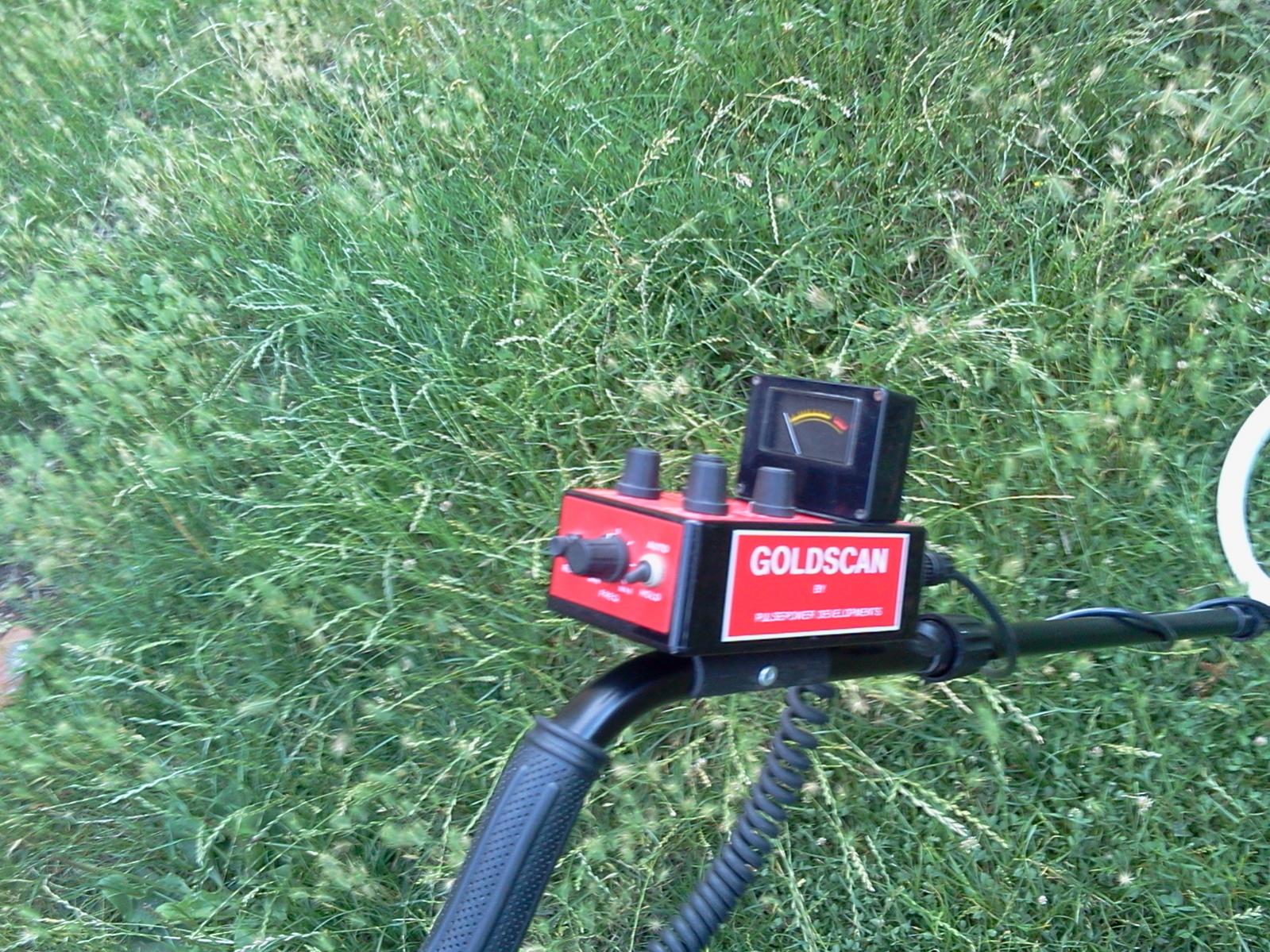

                        most of from the forum I believe that they are not view never how it works
                        Original goldskan 4 .
                        imagines the it should be like the VLF but not so !to really work you will see these days recorders
                        klip with the original goldskan 4 detektors to actually work ,To have insight What to Expect !Click image for larger version

                        • #57
                          Orbit on your homemade GS-6 do discrimination mode working??
                          i also search GS4 pcb layout without SMD parts.
                          I see on youtube Jose make good GS4 but i dont know what version pcb he used.
                          • #58
                            working as well as the GS 4 !
                            Original gs4 is not SMD which is a version of has made Jose I do not know .
