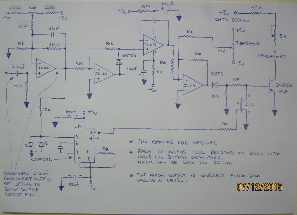

      @Bayu, what did you use as your schema for the VCO? Please show us.

        • Master help me please polones,how to set deep, use coil dim 50cm, how to set master please help
          How many uH to coil and set componen ??
          • Originally posted by Bayu View Post
            [ATTACH]54610[/ATTACH]
            good job thank you
            where is that 2.2uF SAT cap left side connected? pin 6 of LM741 integrator?
            did you change the original integrator before that 2.2uF SAT cap?
            or this section is just a plug in
              I am seting freq 750hz 33k pin 1 from4011 use 10k
              33k use trimp 50k to setting
              330 from 6 lf357 replace 10r
              Detec ring 1,8grams 18k 17cm in red ground
              thanks
              but with this low delay it will easily respond to ground and become annoying even with the SAT i think
              do you shield the coil?

                No i dont use shield, mybe next time, i try to add ground balance and 4046vco,
                • 7
                  Originally posted by Mr.Jaick View Post
                  good job thank you
                  2,2 uf audiofhiler conected 1k after 741. This vco must be use GB so that soil minerals are not read as targets

                    i don't think the ground issue is coming from vco, because it can be sensitive to ground or old clays with the original vco
                    if it's too sensitive to coil distance from ground then shield the coil it might help but for mineralization only GEB can help
                    about depth i'm not sure what you have done there but basically you have to get things right
                    coil, damping, sample delay, sample pulse width, gains and every thing else
                    one major depth limiter for you can be the VCO
                    I tried with the 4046 it was working good but at cost of lower depth (audio problem)
                    in my opinion the Audio section of any metal detector is as important as other parts if not more
                    cuz it's the only one who talks to your ears and tells you if there is any faint target down there
                    basically the middleman between detector and you

                      here the soil minerals are very high, so VCO without GEB will be difficult to control because the empty land from the target can be read by a machine, if the sens is set according to the soil, if we move the coil sometimes there are higher soil minerals, variations in soil types here are very make it difficult, I use ic lm324 for vco the result is better than using 2 opam ic, thanks for the advice

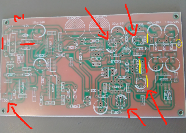

                      • Hi all,who have more information about this variant?sch,pcb,,,,,Click image for larger version
