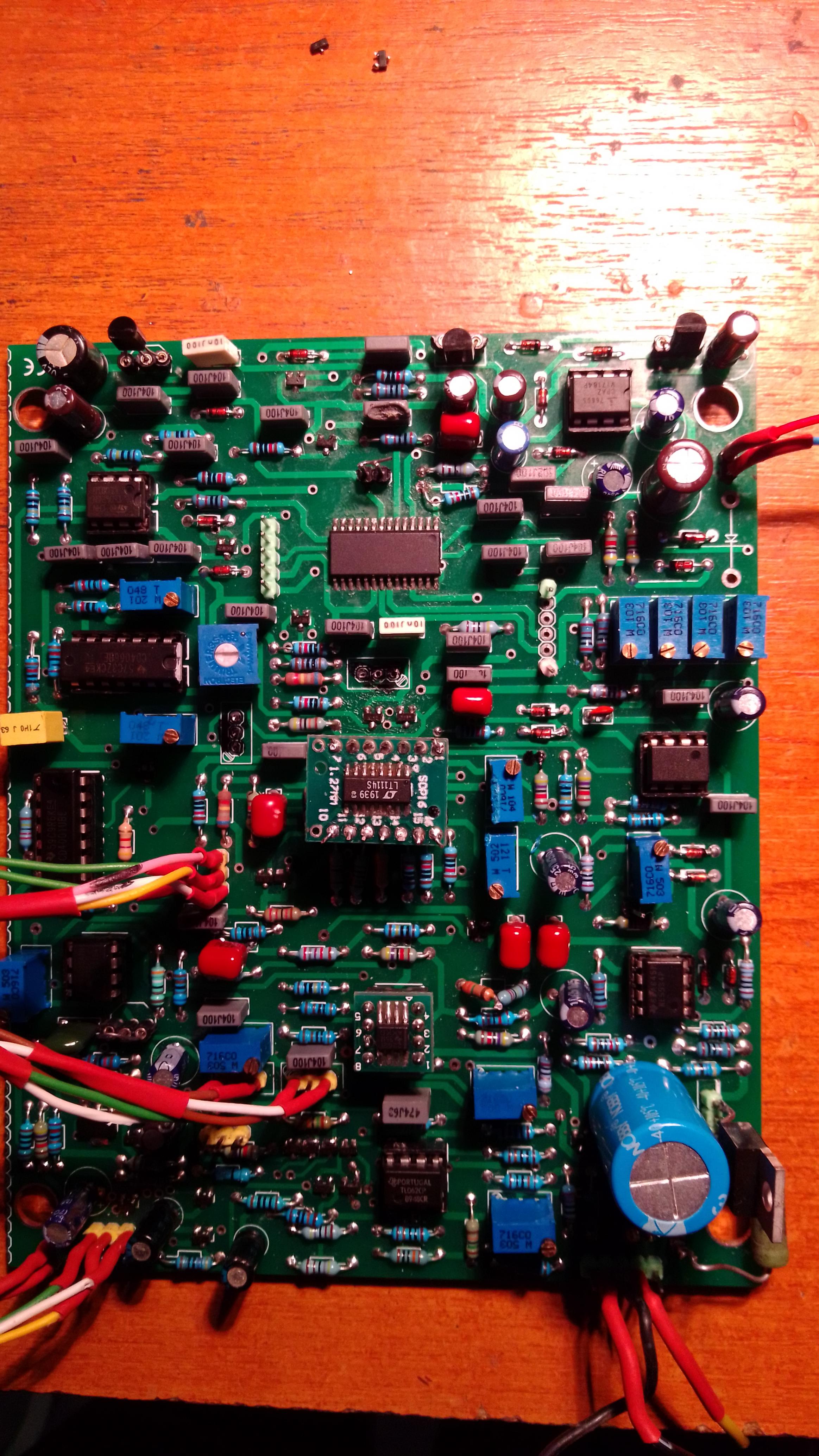

                          • Another version of the TDI -PRO with a new controller ! Click image for larger version
Name:	TDI -VER-04.jpg
                            • did you design this TDI..Orbit ???
                              • Of course,and now I'm drawing a TDI -SL original, I intend to draw several versions, one will be with bipolar transmission similar to fisher impulses!
                                otherwise on the drawing is TDI -PRO except I use my controller and little modification in the power supply and I don't use an integrated circuit for sound as with pro already from the TDA family- ....I can set different times with my controller and a frequency of 800hz to 3.3khz..I have drafts of several versions from the original to my modifications which mainly relate to noise reduction!
