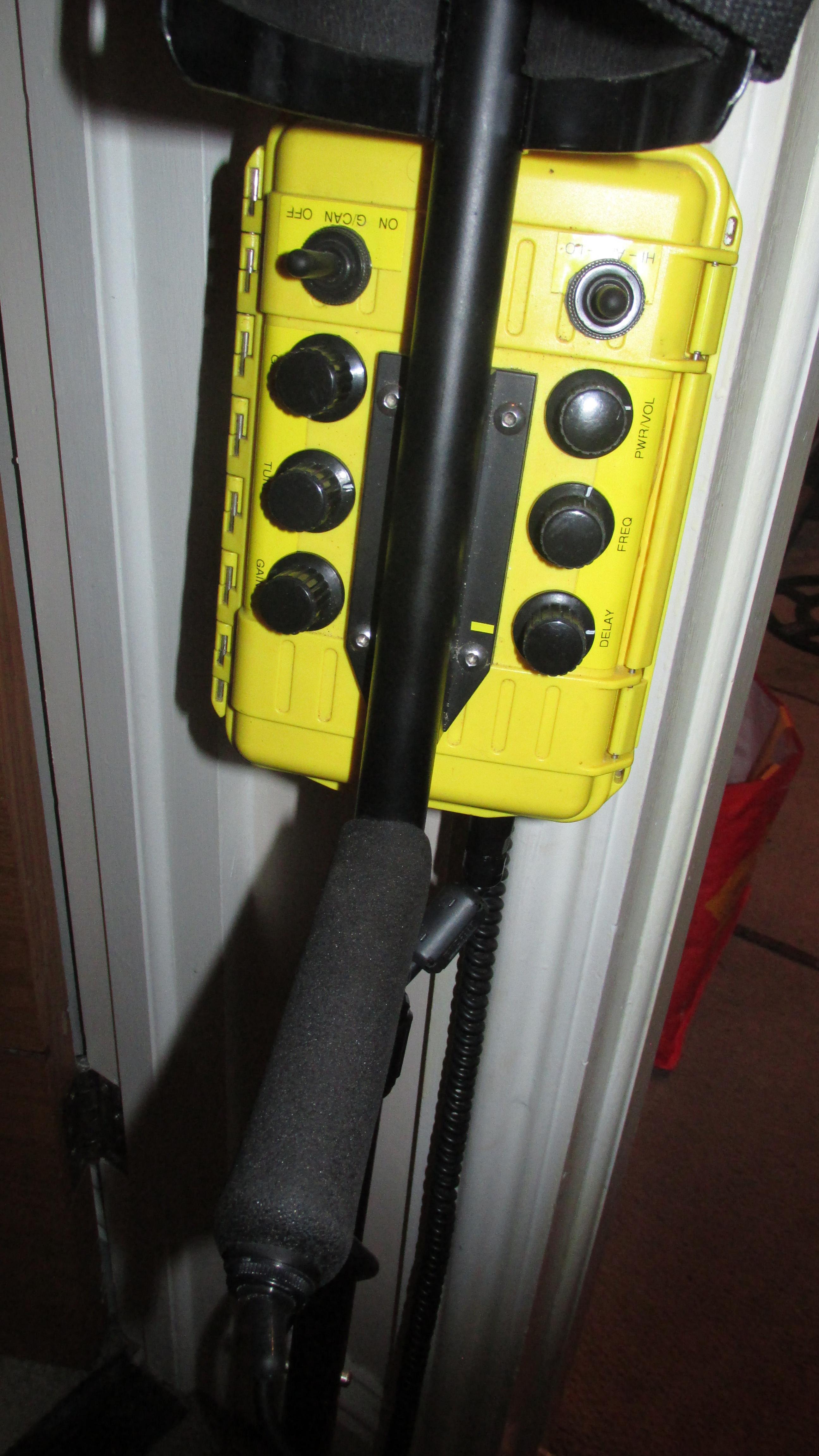

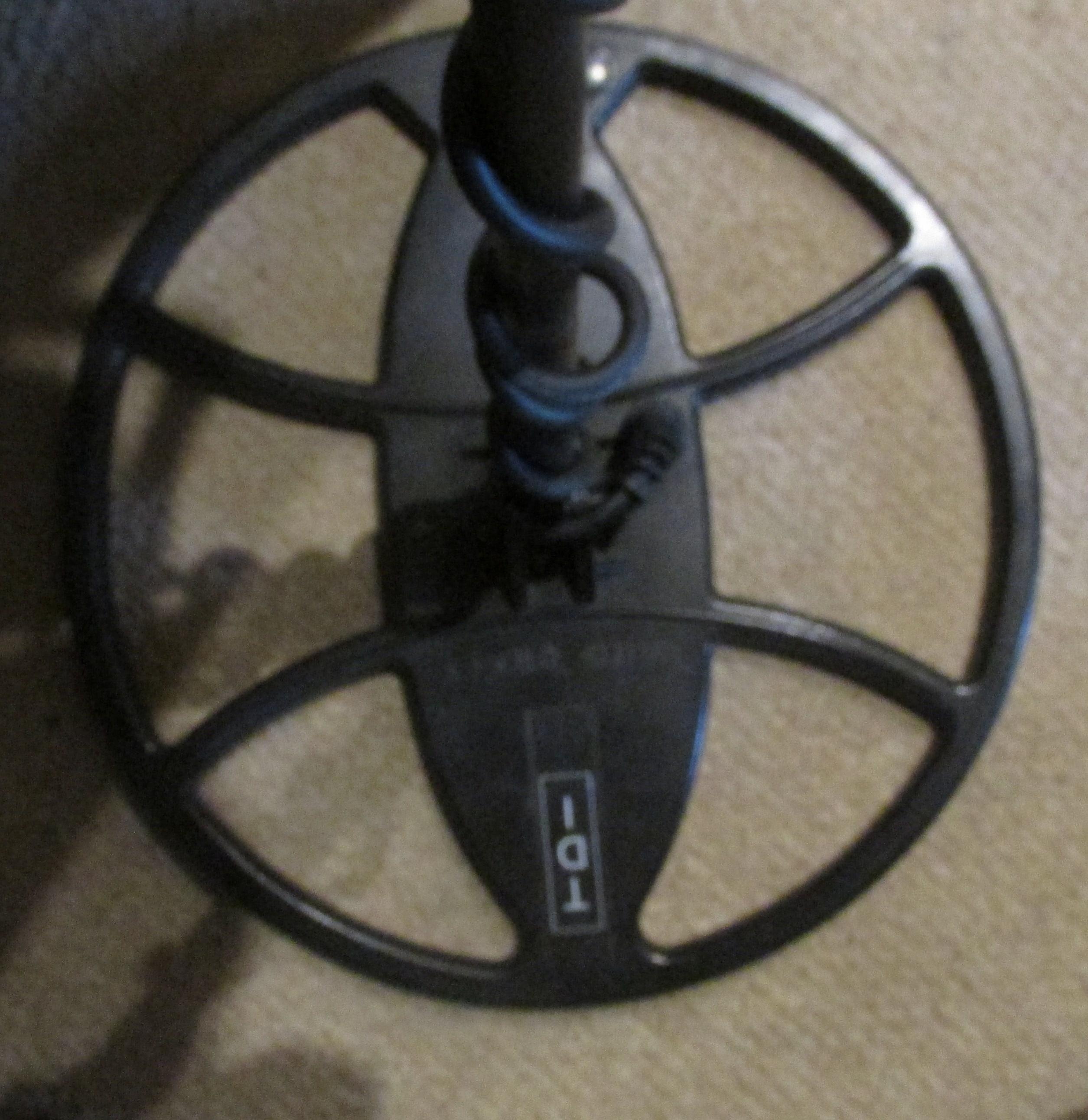

TDI PRO PROJECT COMPLETE
    Hello Daverave, your project looks very good !.

        Hey daverave what's the part number of the waterproof box, or where I can get one of those if you know?
        Thanks.
          i have two tdi's and i use different boxes for both...one is a whites's beach hunter ID box...and the other is a ultra box 308....for me the ultra box was better and also its got a better waterproof rating.
            Thats nice i can obtain the ultrabox. I need to figure whaterpoof connector and pots.
              i used the chinese waterproof sockets and plugs...the pots are normal but i used silicon washers around the pot spindles and also used silicon sealent.
Name:	TDI PRO 1.jpg
ID:	359462Click image for larger version
Name:	TDI PRO 2.jpg
                  Looking good Dave! I'll be shooting for the same appearance.
                    its a very good box to use and i found the detector not too heavy and very well balanced...be nice to see a photo of your detector when completed.
