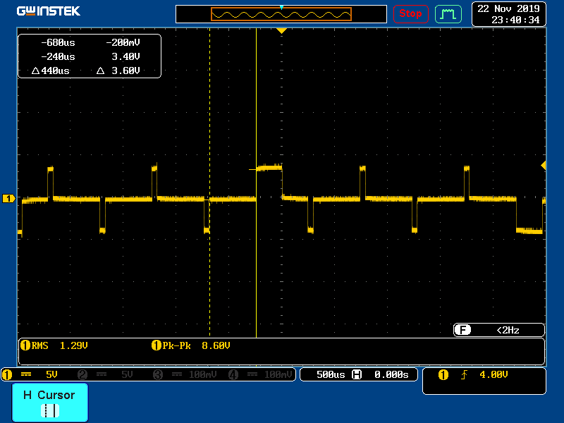

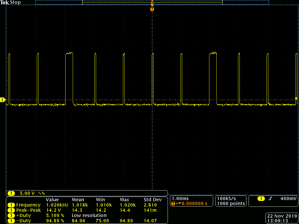

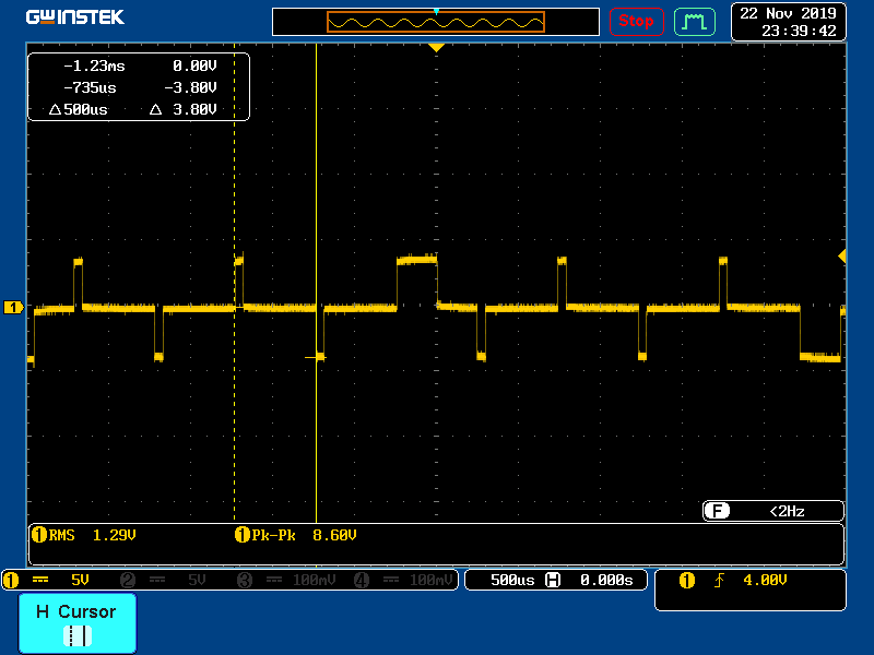

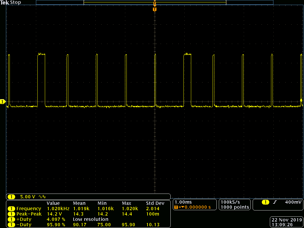

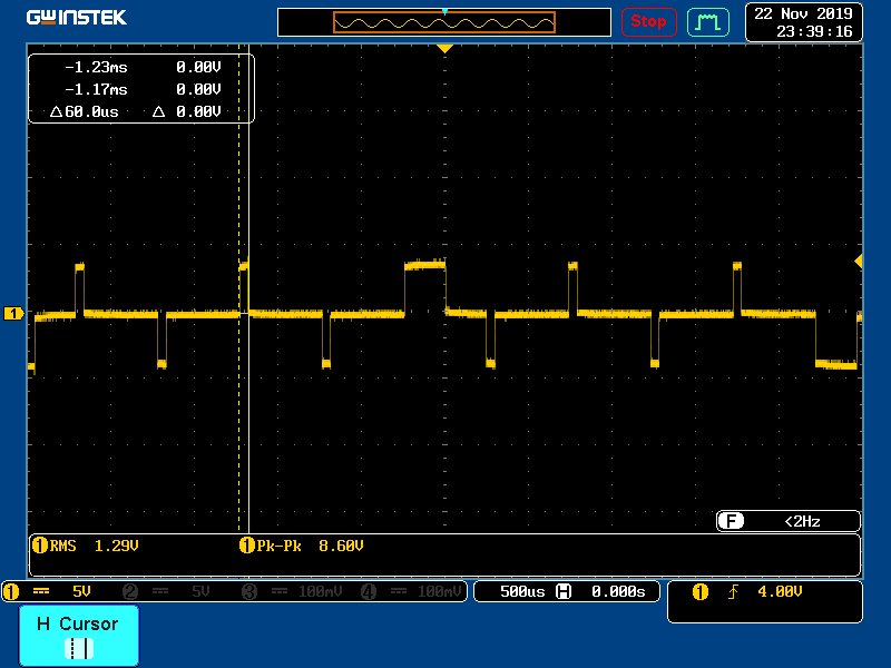

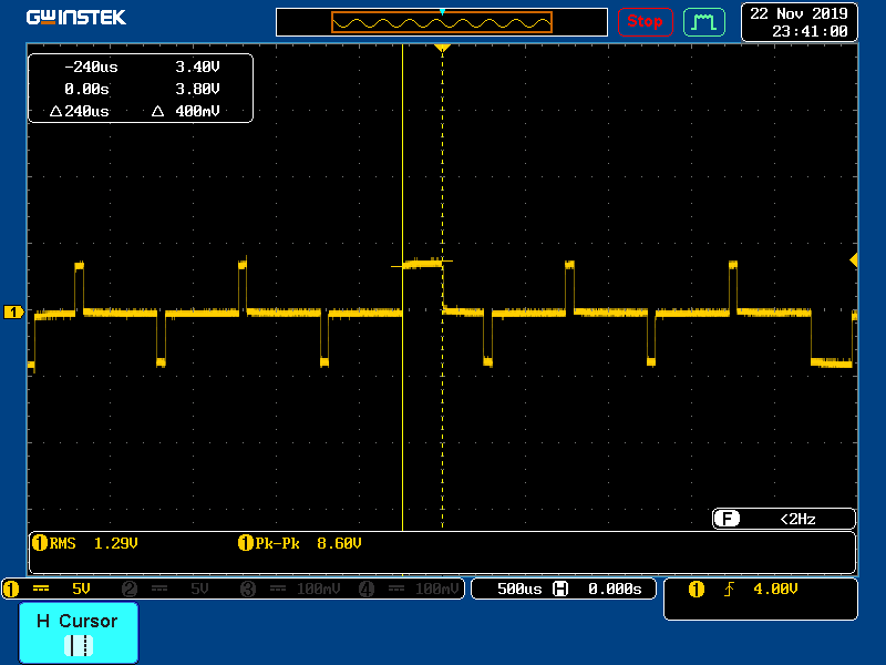

                Ok, found the Tek scope probe..

                  I am assuming that this is with a live coil. If that assumtion is correct, would it be possible to get the same measurements without a coil connected. I suspect that the gate drive to M1 and M3 are too low. It appears that we are only getting a little over 5V effective pulse between source and gate. By observing the gates without the coil connected, we take the voltage drop across the coil out of the picture and makes things a little less dynamic. Without the coil, I would expect the source for the active boost MOSFET to be a 5V, then we can see the effective voltage between gate and source.
                  By looking at the pictures of the pulse transformer, it appears that your primaries are 5 turns... I think 4 would work better and give us more drive. Are the primaries 24 AWG or larger? I used 22 awg and 4 turns on the primary to get my 15v on my test jig (secondaries had 14 turns of much lighter wire just like yours). We may have to get more turns on the secondary to achieve what we need... I was hoping that would not be the case. When i was looking for available toroid inductors, I was looking for 16 - 18 turn secondaries and planned on 4 turn larger awg primaries but could not find any... had to settle for the 1.4mH 14 turn. But had in mind that we could rewind them with 16 if needed (still using 4 turn heavy guage primary).
                  Also if the coil is connected coud we get a shot at R9 or R11 for a guage of coil curren and profile.

                    Thanks JL.
                    The shots in last post were all without coil attached.
                    All measurements referenced to 0V.

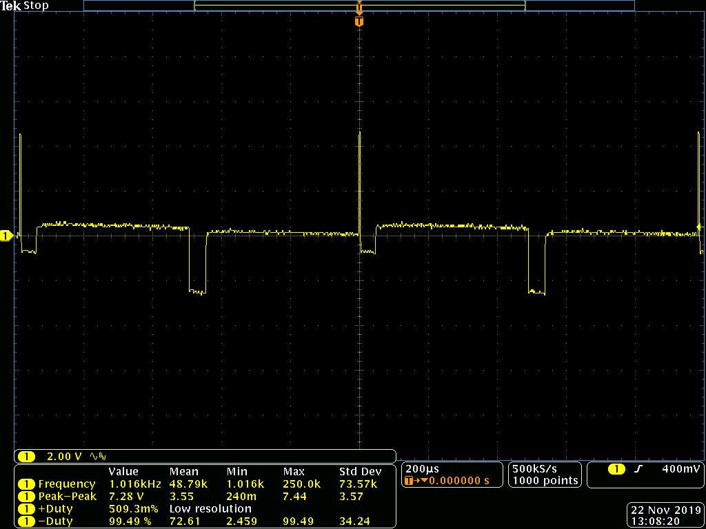

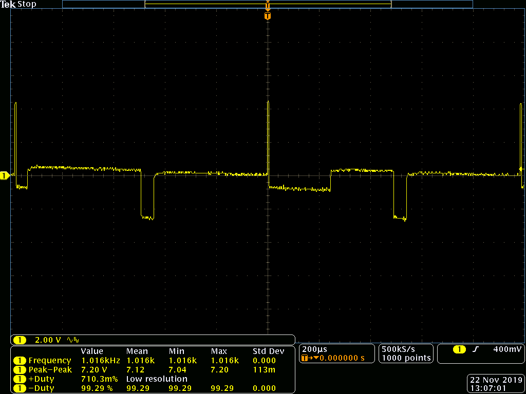

                    The primary windings did have nearly 5 turns when you see the way I looped the wire to pads, this has been changed back to 4. The wire gauge is 25 AWG. I will also change this next to .63 (22 AWG) next.
                    I soldered some wires to the PCB to connect to a .1" female header so I can probe the relevant areas without slipping the probe off everywhere.
                    Here are some shots across TX_COIL+ and TX_COIL- no coil attached...
                    I will rewind the transformers tomorrow and measure the gate voltages again but I do see an improvement with just reducing the windings back to 4.
                    I will also measure the coil current once this is done.

                      Great! The waveform across COIL_ & COIL+ is just about what I would expect. Now the gate drive for M3 (Boost_A_G) to ground will be riding on top of (in reference to) TX_COIL- to gnd and the gate drive for M1 (Boost_B_G) will be riding on top of (in reference to) TX_COIL+. In the mean time I am doing to see what info I can find on Amidn's site to research some aspect of toroid cores available for our purpose, just in case we have to wind our own. If we have to go that route, I would like a core just a little larger OD (~20 - 24 mm) & ID (~11 - 13 mm) and a ui such that 5 turns would yield between ~70 and 90 uH primary with a 3.5: - 4:1 turns ratio.
                            Looking good... Yes the gate drive in reference to TX+ and TX- is as you describe, I will setup and take some more detailed measurements and take notes. At least we are in the ball park now.
