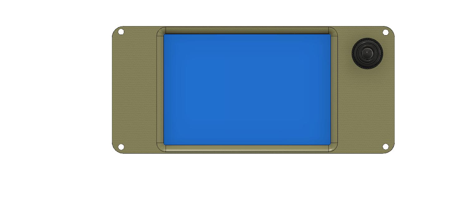

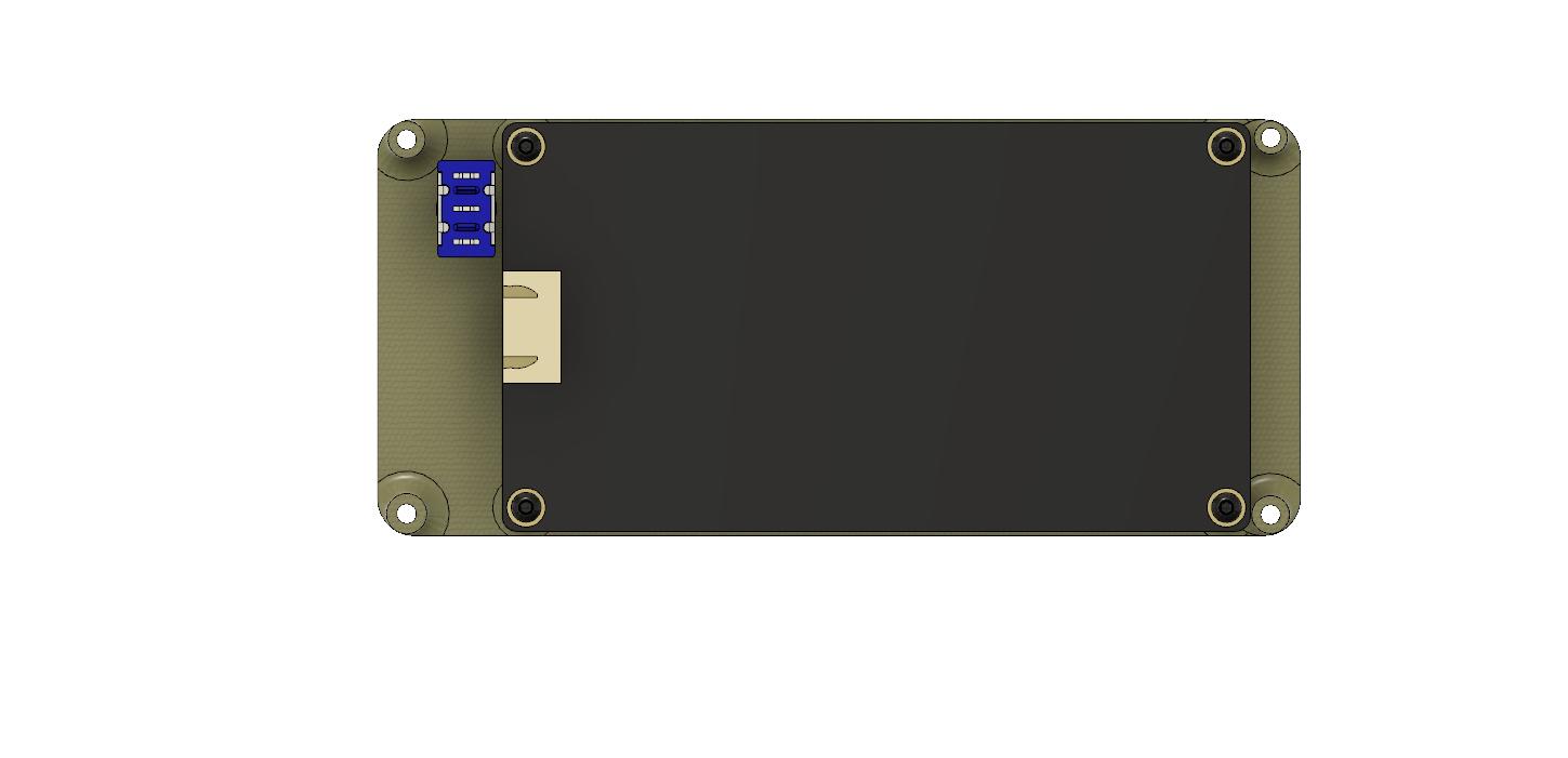

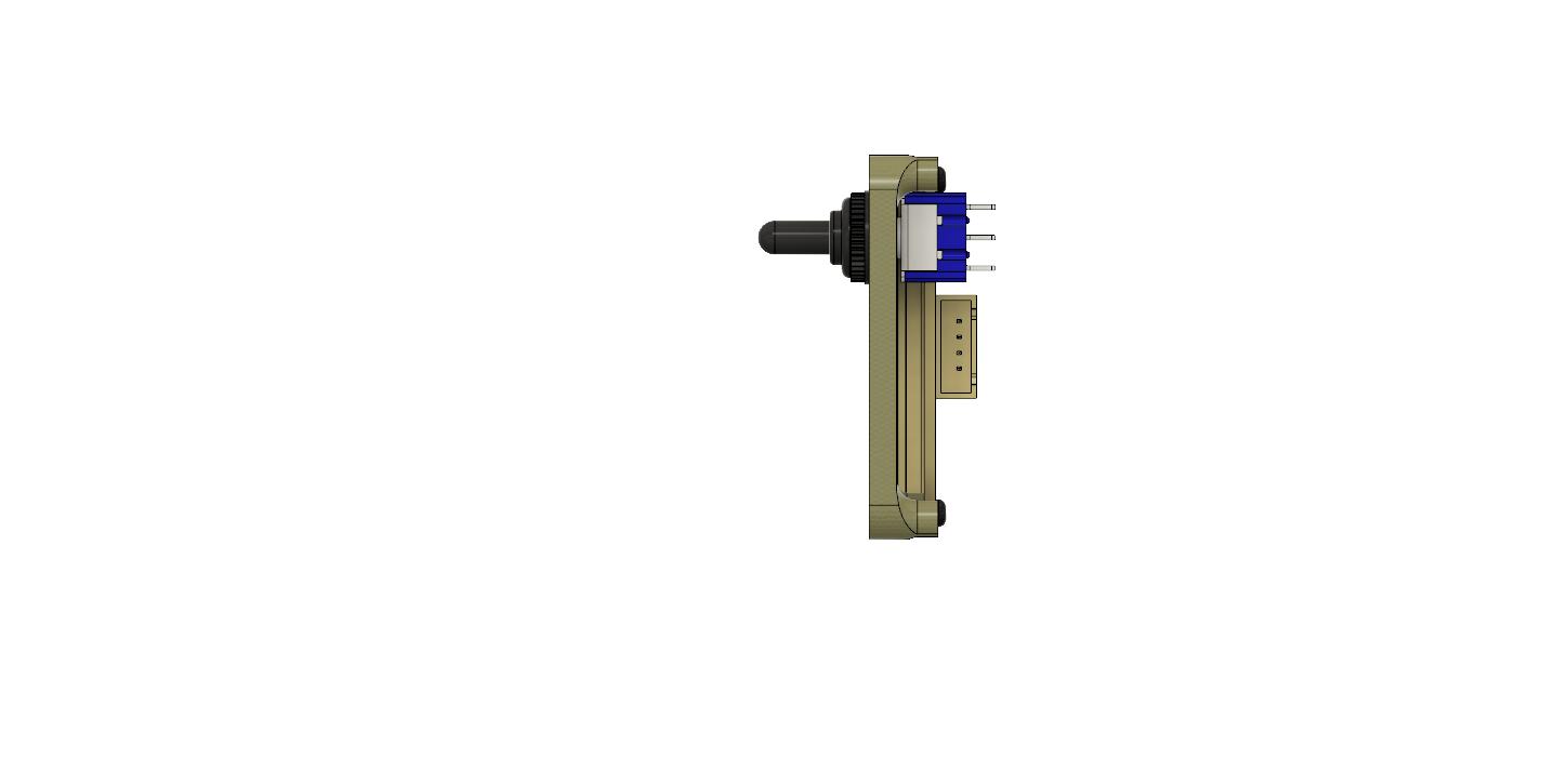

      I have modified the front panel to suit the existing housing.
      Unfortunately it's landscape orientation which will mean a change to your screens.

      Once we have it up and tested, I will do another complete design with any/all changes required with portrait aspect, separate display head and control box etc.
      I will then post the STL files for those who wish to 3D print the enclosure.

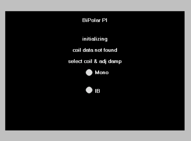

            The "Init" page reads the EEPROM to get saved parameters for STATUS, PRT, DAMP timing, S1 timing, S2 timing, and the previous sample GB data. If parameters are found, they are read into page variables. The mcu (Cmod-A7) is sent an event notification whereupon the mcu application issues a "get" for each of the parameters. When all parameters are retrieved, the mcu applications issues a click of ID 0, where upon the Nextion issues a page "Normal" command.
            If the "Init" page does not find any stored values (1st turn on of the system), the post initialization code initializes all parameters with default data and presents a set of 2 radio buttons to select the type of coil (Mono or IB) in place. When the coil is selected the event processing for the radio button sets the status bit in the STATUS parameter, notifies the mcu of the event, and stores all parameters in EEPROM. When the mcu indicates that all parameters are received, the Nextion code issues a page "Damp" command.
            The Init page presented to user if no parameters are found:

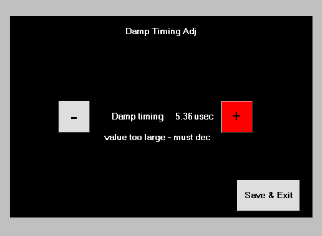

            The "Damp" page notifies the mcu of a ID 0 event so that the mcu can insure that the TX is in "Mono" mode and also starts sending S0 data to the sys0 variable. Every time the sys0 value is updated, the mcu issues a "click" ID 0 command which invokes the Nextion touch event for ID 0 that updates the page. If the S0 data is negative the "+" button ihas events disabled. Each time the "+" or "-" button is pressed, the ting value is incremented or decremented and the mcu is notified. The mcu issues a "get" of the timng value and sets the TX parameter.
            The normal procedure would be to increase the timing until the timing value is too large ("+" button disabled with a red background). Then decrease the value until the "+" button red background returns to normal . At that time "Save and Exit". The "Save & Exit" event saves the parameter in EEPROM, notifies the mcu, and executes a page "GB" command.

            DAMP page with damp value too large:

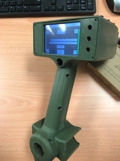

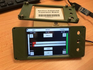

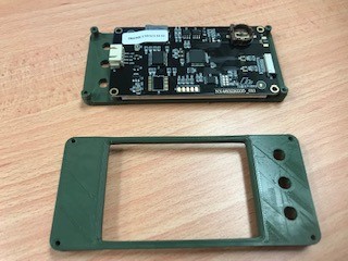

              • Modified the front panel and 3D printed a couple of drafts which will aid in positioning graphics buttons.
                The screen in this photo looks dull as it still has the protective film on
                All fits well, I added a couple of extra holes for power switch (top or bottom) and low profile push buttons.
                It is a tight fit but its fine for testing.
                @JL, on the main enclosure, you may need to trim away a bit of material directly behind the on board battery holder so the front panel sits back in from the front edge.
                Alternatively, add 4 spacers between the stand-offs and enclosure. Either way will work.
                I prefer the panel sitting back. The panel can move back approximately 4mm from the position shown in last photo.
                One last note, the bezels were printed with 100% infill, so if you want to drill more holes, you can without damaging the part.
