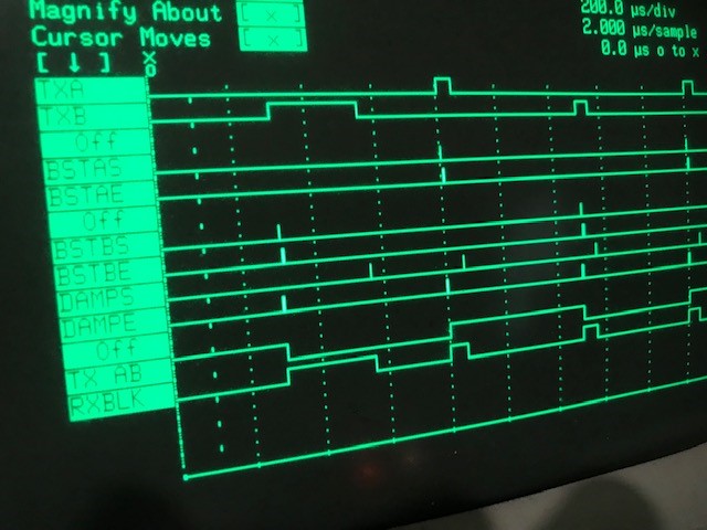

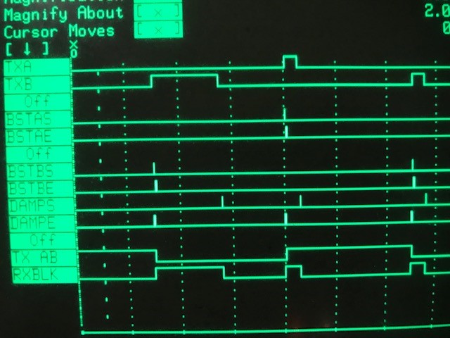

          I have setup and tested the outputs for current and last posted (12_3_2019) Vivado project.
          Still haven't restored my GPIB software atm so this is just a snapshot of the Aux outputs but looks good.
          Timebase = 200us per division

          Once I figure out whats going on with the GPIB capture, I'll post some better shots.

                    I like your logic analyser, is that an Agilent?
                      I'm going to wait and see what JL comes up with his tests. Type "J" or T35 may be a better choice? Mouser also carries the TDK cores.
                      The logic analyser is a vintage HP1630D with the added 2 analog channels. Cost me more than my car back in 1984 lol.
                      I have some top end modern gear but this old beast has a sentimental place on my bench and is fired up every now and then.

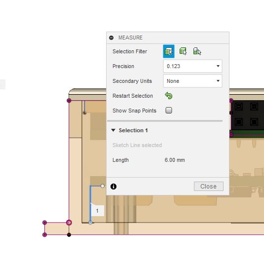

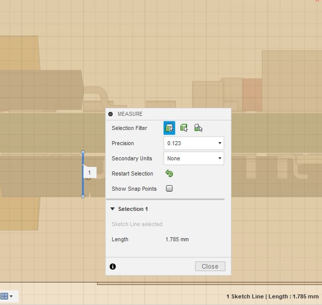

                            For our application (Bipolar PI), we have to be careful of the height of the core as it is on top of the driver IC and must fit within the enclosure.
                              Yes, I think we are limited to 6 or 7mm, I will have to check.
                              • Originally posted by Mdtoday View Post
                                It is 6mm with room for 0.5mm spacer if required
