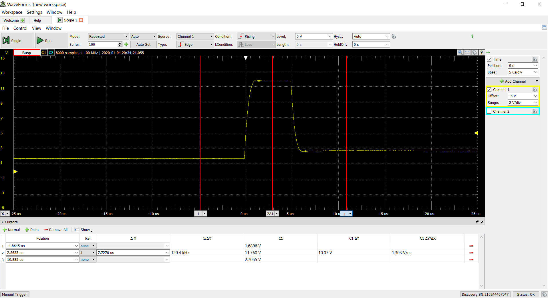

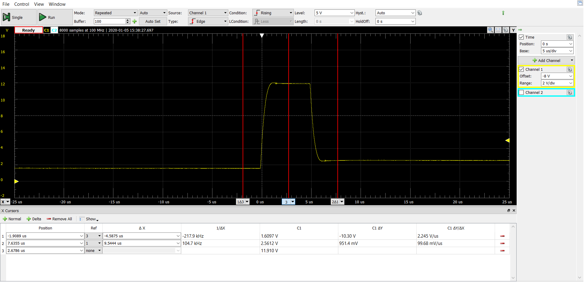

    . Checked drive to M1 (I can actually get to that signal) and got about 9V. I need to reload C29,C32,C35,C38 with 2n2 ( I had originally loaded with 5n6). Progress... (slowly)!

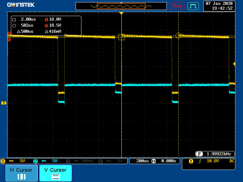

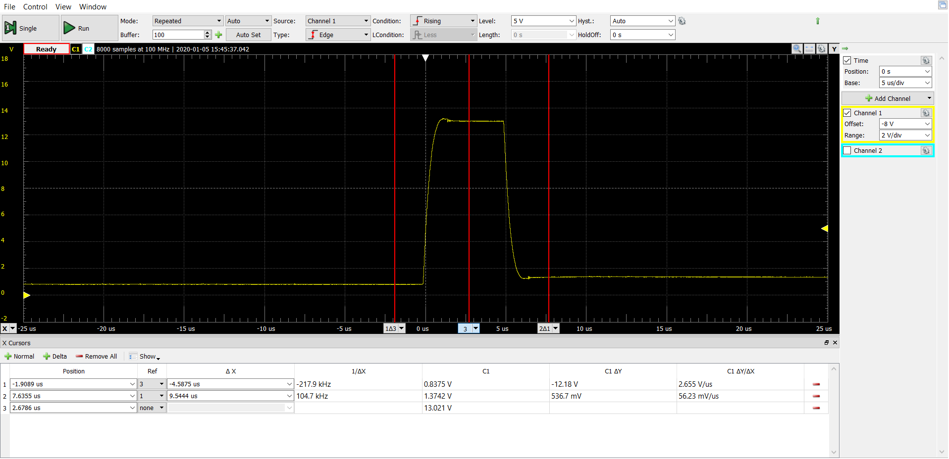

    Reloaded C29,C32,C35,C38 with 2n2. Measured drive between M1 gate and COIL+ (M1 source). I am satified that the drive from the pulse transformer drive circuitry is adequate. 5V set exactly to 5V... anything above 5V increases the drive output. I will now start loading the rest of the TX components. Further testing of the MOSFET driver levels will await until the TX components are loaded and I receive some 127mm pitch 20 pin (2x10) female ribbon connecters so I can easily get to test points on the bottom of the TX board.
    Pulse Transformer M1 MOSFET drive output:
Name:	M1 drive.png

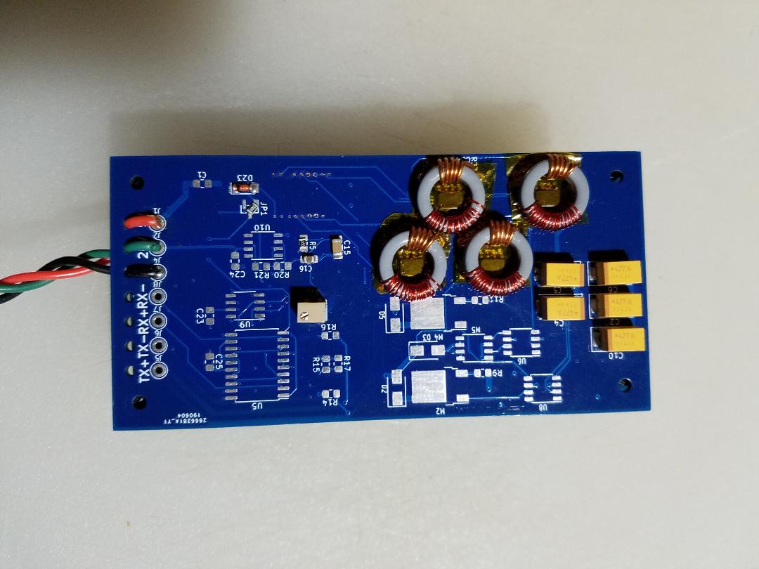

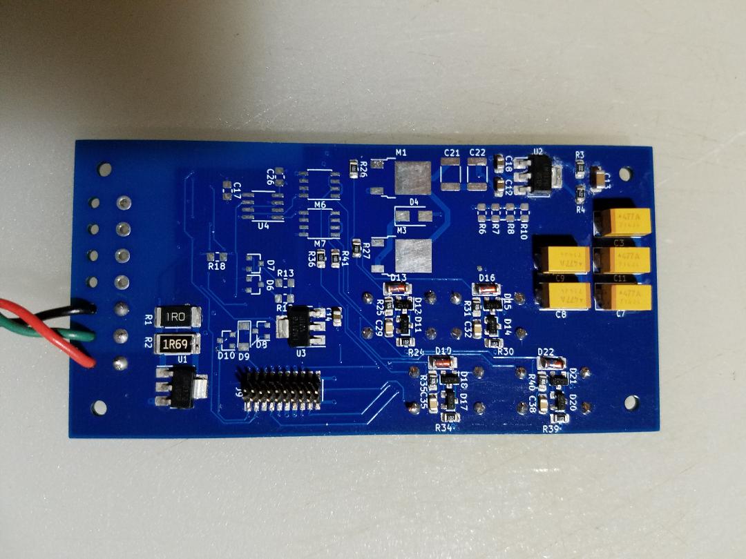

    Current status of top and bottom of TX/RX board:
Name:	TX(top) toroid.jpg

      Your board is Looking great, I will leave the toroids on the little carrier boards for now and just change the caps back to 2n2F.
      I have almost finished loading another set but will wait for further testing before I complete that one.
        ... Further testing of the MOSFET driver levels will await until the TX components are loaded and I receive some 127mm pitch 20 pin (2x10) female ribbon connecters so I can easily get to test points on the bottom of the TX board...

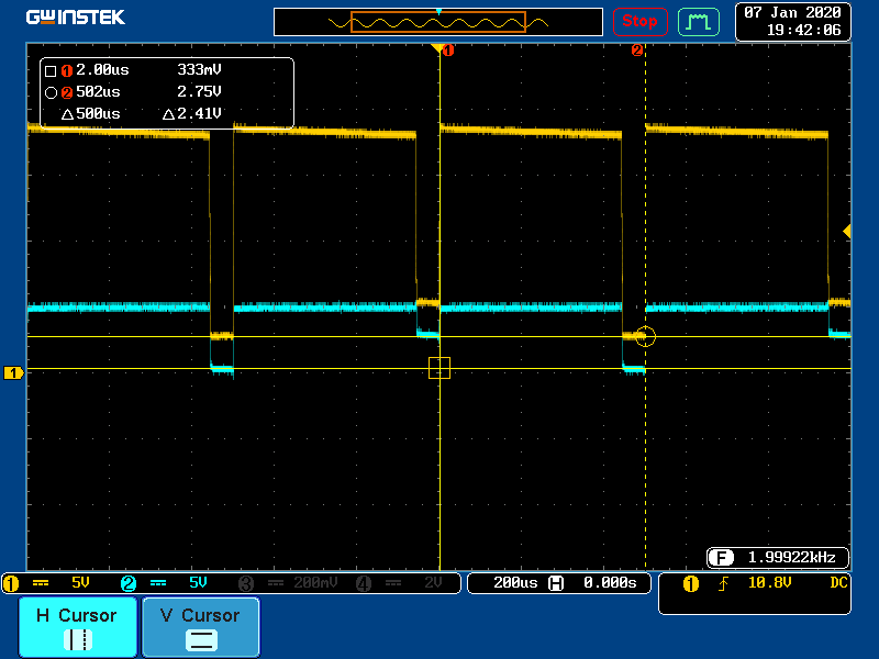

        As much as I hate to do it, this AM I am going to lift the toroids, replace the 1 ohm resistors in the primary circuit with 0 ohm shunts, and then re-install the toroids. Then I am leaving the circuit alone! Indications are that this could increase the primary current by as much as 50 ma and should drive the difference between gate and source to less than 1 V.

            Only marginally better... drive increase of ~150 mv... off time difference gate/source reduced from 1.689v to 1.609 mv.
Name:	M1 5V 0R.png
            Also tried raising 5V to 5.3V. Two reasons for trying this: (1) The differnce between gate and source during off time is caused by insufficient drive from the pulse transformer. At 5V, the EL7202 is at the bottom end of the voltage operational limits... a slight increase in voltage makes a significant (relatively) difference in drive current to the pulse transformer. (2) The plus 5V will probably have to run at about 5.3V to maintain a 5V level being supplied to the CMOD-A7 thru D1 of the I/F board. With 5V at 5.3V, the difference between gate and source during off time is reduced to 0.837 (extremely acceptable) and drive is increased by ~2V.
Name:	M1 5.3V 0R.png

              Looking good. for all my tests I had set the 5v supply to around the same (5.4v) so that there was 5v at the CMOS-A7. So we are at least getting consistent and similar results.

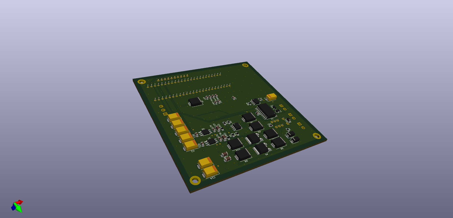

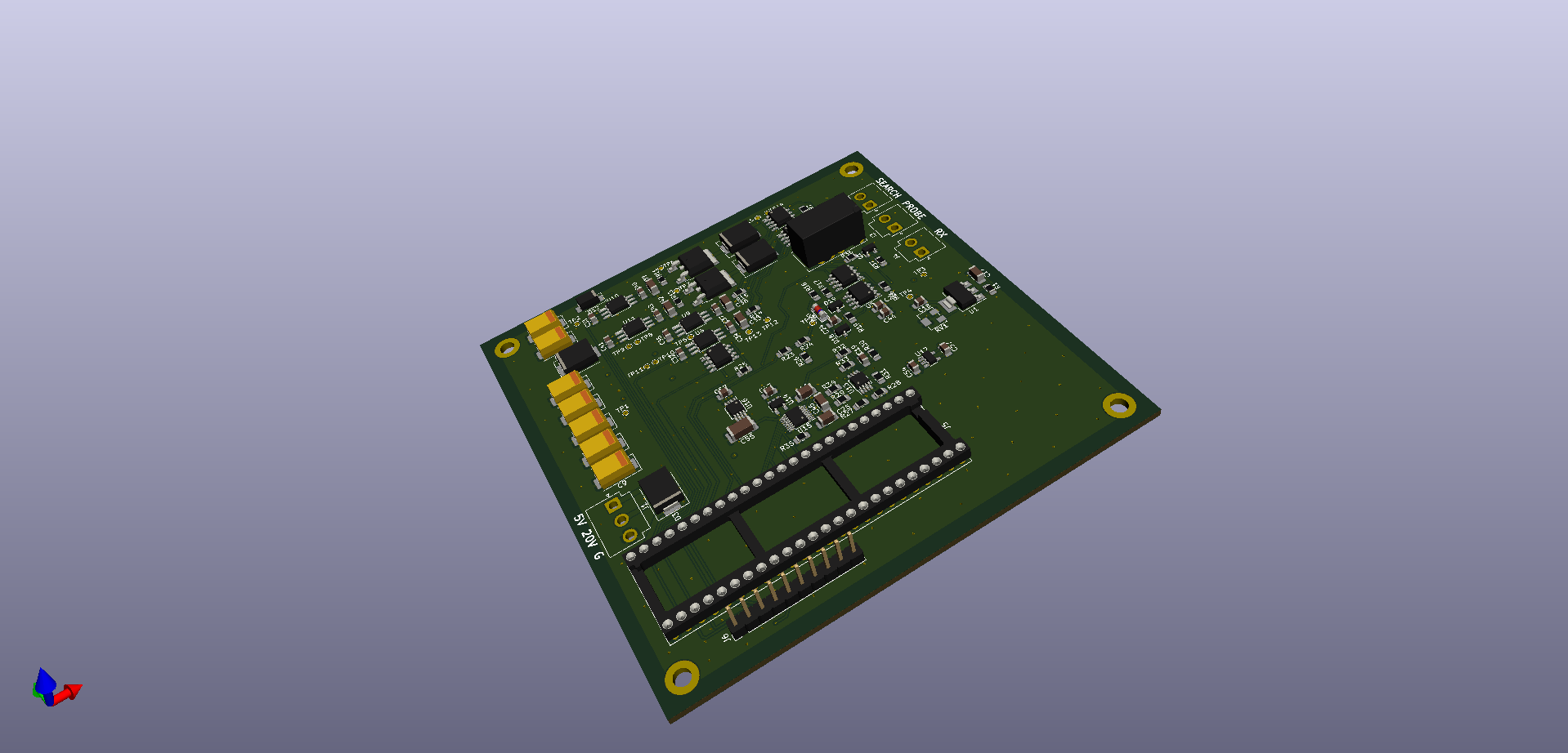

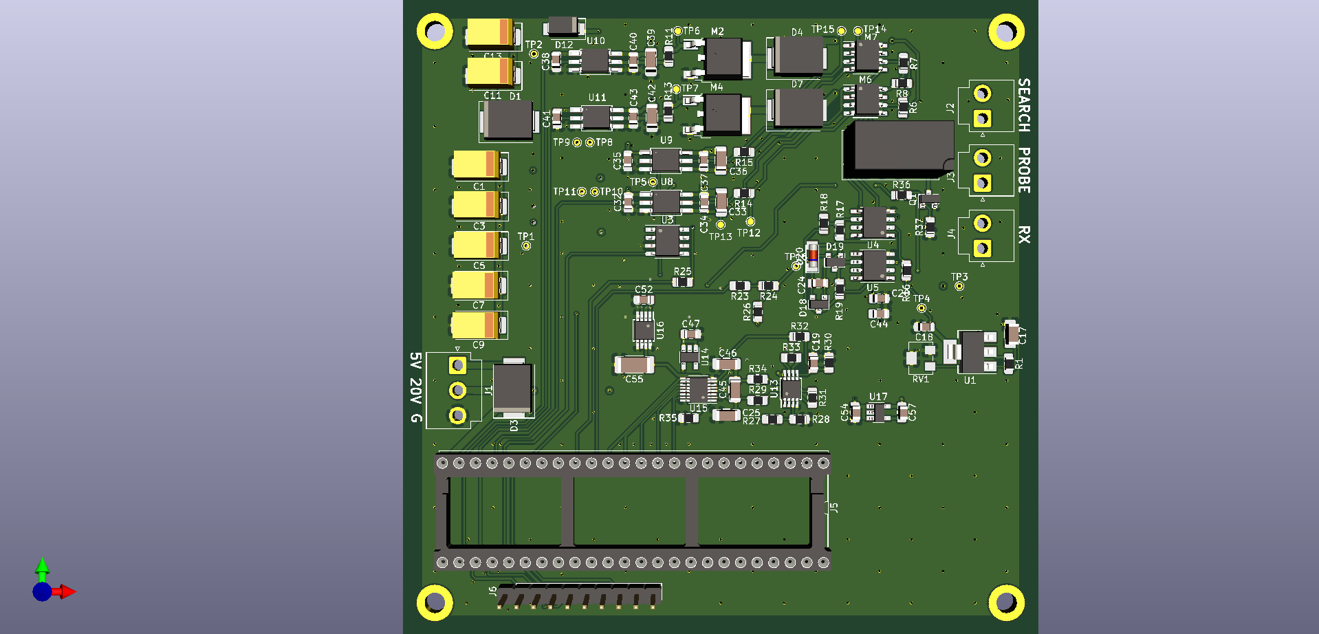

                      • Single board version of Bipolar PI version 2
                        I have had at least one response indicating a preference for a single board version of the Bipolar PI. After some thought, I also see a benefit to a single board. I have included all of the features that we had in the two board version and the use of the ADuM4120 for the isolated MOSFET drivers. The layout is on a 100mm x 100mm 4 layer board. The option is there to not populate the 20 bit ADC circuitry and to use the CMOD-A7 XADC (12 bit) to process the RX. There is a 3mm keepout on all edges of the top and bottom layers. Top and bottom layers are GND filled and stiched with with an array vias. A 10 pin header strip is included to bring out all of the CMOD-A7 timing signals for testing as needed. The power connection, search coil connection, probe coil connection, and RX coil connection are now via JST-VH series connectors. The power connection is a 3x1 connector, while the 3 coil connections are by 2x1 connectors. 3.2MM mounting holes are at all four corners of the PCB. There is only one feature yet to include on the board... an RF shield cage for the analog circuitry.
                        The 3D veiws of the new board implementation:
                        Top veiw
Name:	TX sinle board(top).png
                        Bottom veiw
Name:	TX sinle board(bottom).png
                        The schematic:

                        This layout/design needs extensive vetting/validation. PCB production is not envisioned until we are finished with our proof of concept testing of version 1.
                          Very nice work JL! I like it a lot.
                          • Everything JL does is magic, however I'm going to point out something I don't like.
                            I don't like the fact that there appears to be 2 U15's on the top side. At least that is what I see. Maybe one of them should be U14.
                            I don't like that all chips are aligned unidirectionally except for one of the said (U15), it looks like odd man out. (Excluding the CMOD-A7)
                            Not that this matters.
                            Otherwise it's brilliant. Fantastic work JL.
Name:	TX single board(top)1.png
                                [ATTACH=CONFIG]49098[/ATTACH]
                                Well I only clicked on the photo in #686 above, which give different angle view of top side. Now I see there is no mistake.
                                I should have known, the software is not likely to allow such a thing to occur.
                                Again, very nice.
