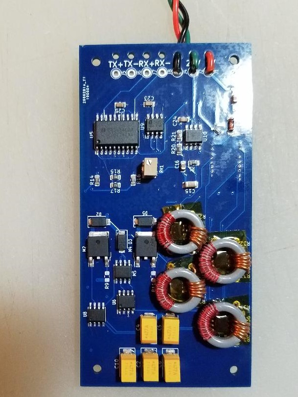

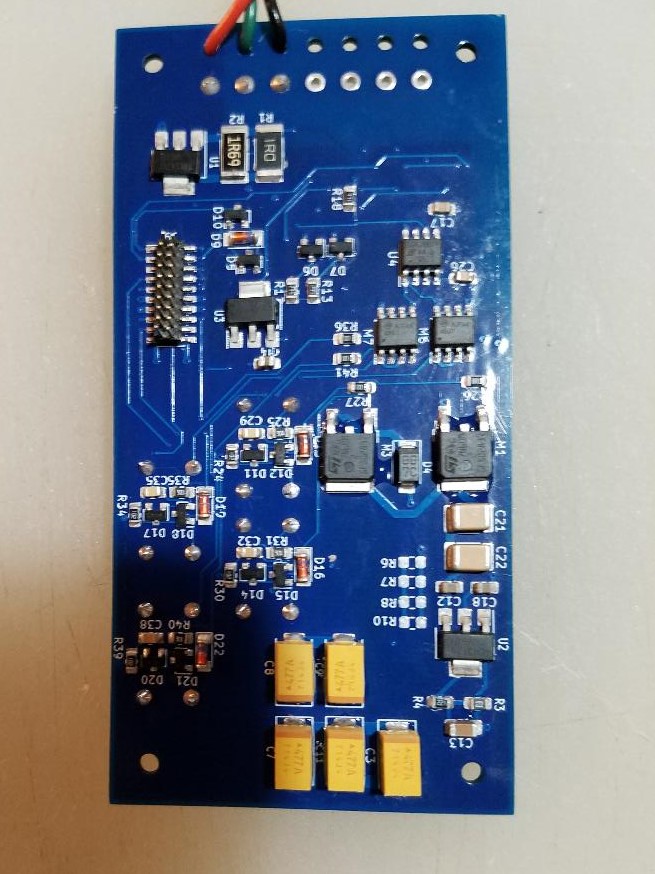

                    • TX/RX PCB Loaded
                      Finally finished (almost) loading the TX/RX PCB. R9 & R11 yet to be loaded as I am waiting a shipment of 805 & 1206 resistors kits. They have the <1 ohm values needed.

                      Still need to wind a mono coil for testing. Target parameters for the coil are 10.25" diam, 320 uH, 1.5 ohm.
                      After preliminary checks and firing up the TX, I will focus on validating the timing of all of the TX/RX signals and the software code to auto tune the start of the DAMP signal. That should all start happening in about 2 weeks.

                        Looking good! I have wound a mono 300 mm coil at around the same specs 328uH 1.7 ohms ready for testing but over the last couple of days, have been busy getting the vacuum former ready to do some coil shells while the weather has cooled a little, It's been hot so progress has slowed for workshop machines. Tonight I might hook up the test coil and take some measurments.
