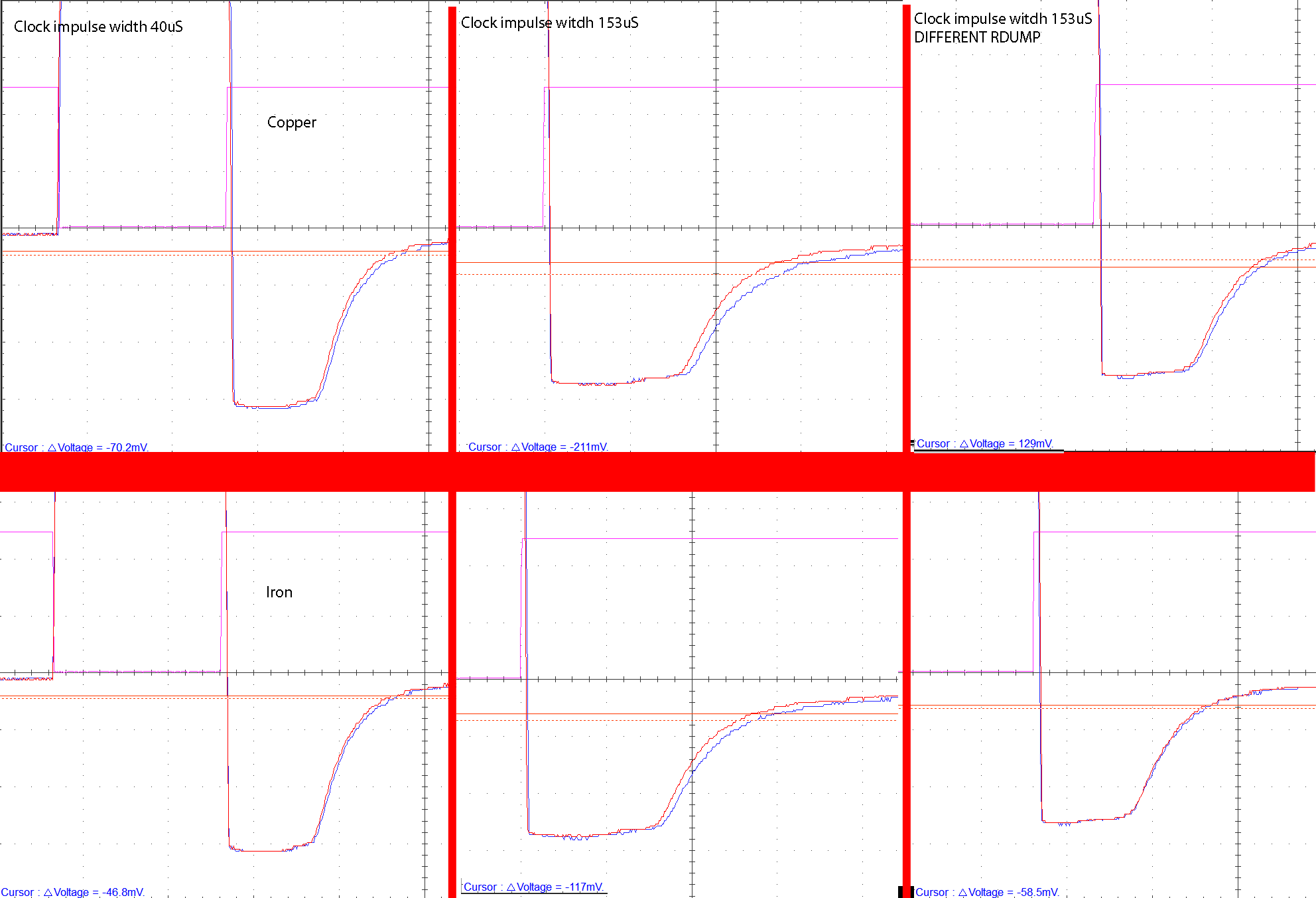

                  Hi everyone, thanks Carl to share your knowledge... it's the real gold for me.. I've a couple of questions:
                  - with the term "tank cap" you mean the big capacitor in parallel (usually 1000uF)?;
                  - what change increasing impulse width? because i tried to change it and this is the result. I think the reason is longer pulse, much eddy current stored in the targets... is it correct or I wrong? thanks a lot. I hope I'm not off topic with this last question.
                  In the picture comparison between pure copper, iron and no target curve with different pulse width, RDump. (NoTarget line in red, target curve in blue)

                    Originally posted by Old cart View Post
                    Will this article continue?
                    Yes, better late than never!

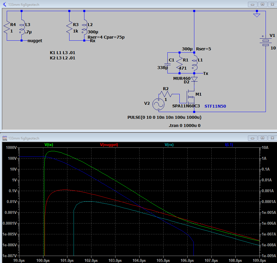

                        An attempt at using spice with your example. Included target and separate Rx response. Change in Tx current charges target(I/T=E/L)E=coil volts-(coil current*coil resistance). Fly back volts charges target. Coil volts during fly back is more than 100 times coil current*coil resistance so can use coil volts for calculation. Coil volts: 300/.0003=1A/us, 30/.0003=.1A/us. Question, is the coil still trying to charge the target at 30V fly back? Simulation suggests, could use a shorter delay with a separate IB Rx coil. Question, was any of what I posted correct?
                            Sorry, I don't understand.
                                Don't know if I understand. I'm trying to understand when the coil discharge stops charging the target. With spice, it appears not long after coil volts peak and start to decay. Does the energy stored in the coil after coil volts peak charge the target or is it wasted? Been stated, don't let mosfet avalanche. Is it because we don't want fly back to flat top or we don't want avalanche? Peak current is limited with a fast Tx coil if we don't avalanche or snub close to avalanche.
                                Think I see one of my problems, been looking at log amplitude. Target starts to fall of around 200V Tx not peak.
