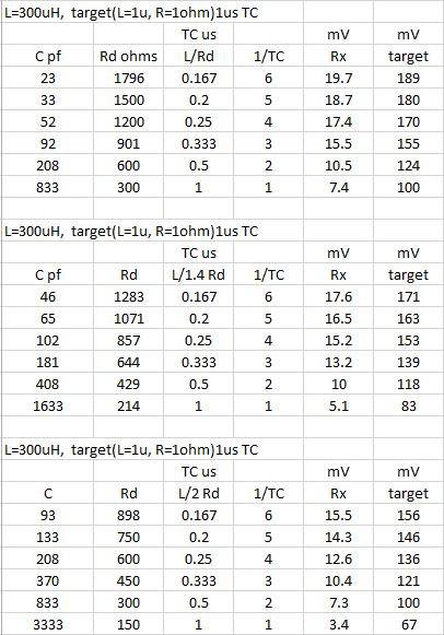

          If target tau is 1us, what formula should be used to calculate coil discharge tau(L/Rd, L/1.4Rd, or L/2Rd)for .2us? Assume separate Tx, Rd only no input resistor. I was thinking L/2Rd(critical damped), maybe not correct.
            In another thread Joe/bbsailor suggested you want the turn-off time to be at least 5x faster than the target tau you want to detect. That's pretty fair, as anything better than that is hard fightin' for minimal gain.
            Used spice and Excel to compare(L/Rd, L/1.4Rd and L/2Rd). Don't know if it's an accurate comparison. Looks like using L/R is better.

              1/2*L/Rd
              Always remember that Rd is ALL damping R, including the input resistor.

                          Looked at data again. bbailor suggested Tx turn off tau should be 5 times faster than target tau. He was using L/R. If use L/2R, would need turn off tau 10 times faster than target tau. Turn off tau,3 times faster than target tau isn't bad with L/R. Turn off tau, 6 times faster than target tau with L/2R is same. Maybe it wasn't completely worthless.
