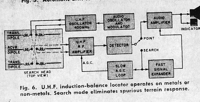

                  When I was involved in industrial metal detectors, one of the areas we were asked to investigate was that of detecting surgical instruments, including needles. These are invariably made of high grade stainless steel which is non-magnetic and low in conductivity. Even recently, I have been asked if it is possible to detect titanium bolts that are used to secure artificial joints. The latter I can do at several inches range, but only at a delay of 4uS. Hypodermic needles can't be detected even using a 1uS delay due to them being hollow. Some other technique needs to be used and UHF radio waves may be a possibility as the needles must have a resonant frequency, depending on their length. Attached is a block diagram on one such arrangement. Click image for larger version
                              Eric.
                              Interesting remark, Eric.
                              I never think about UHF solution with hypodermic needle problem, cause UHF antennas are usually
                              lead over surface at greater distance from soil, than PI or VLF coils.
                              So we need to rethink near to soil UHF antenna movement and possible exclusion near soil impact.
                              Your suggestion could be real solution, cause dangerous discarded hypodermic needle in play
                              and park lots around schools and kindergarten are by rule not buried in soil, but only hidden in
                              grass and sometimes very shallow covered by sand in sandboxes.

                              Thanks. So Pi technology is practically excluded, same as VLF/IB in searching for hypodermic needle
                              detecting solution.
                              I will rethink suggested UHF way. You mentioned here needle resonance and not GPR like reflection.
                              Hypodermic needles are of different lengths, which lead to conclusion that UHF antenna should emit
                              sweeped frequency spectrum to resonate with needle about 3 to 7cm body length.
                              Here we are talking about 5 to 10GHz frequency sweep to catch most needle resonances.
