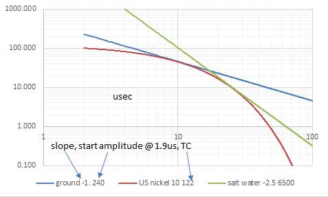

        Sometimes a picture helps. Charted saltwater slope -5/2, ground slope -1 and a nickel TC=10. The decay slope for the nickel is the same when delay equals nickel TC times power slope. Nickel decays faster at longer delay time.
        • #79
          Thanks Green. Yes, a picture does make things clearer. I have a sea water graph plotted at the time and compared to that of an underwater gas pipeline, which is not very relevant to hobby use. My problem would be finding the plot amongst all the papers going back the the 60's and 70's.
          Eric.
