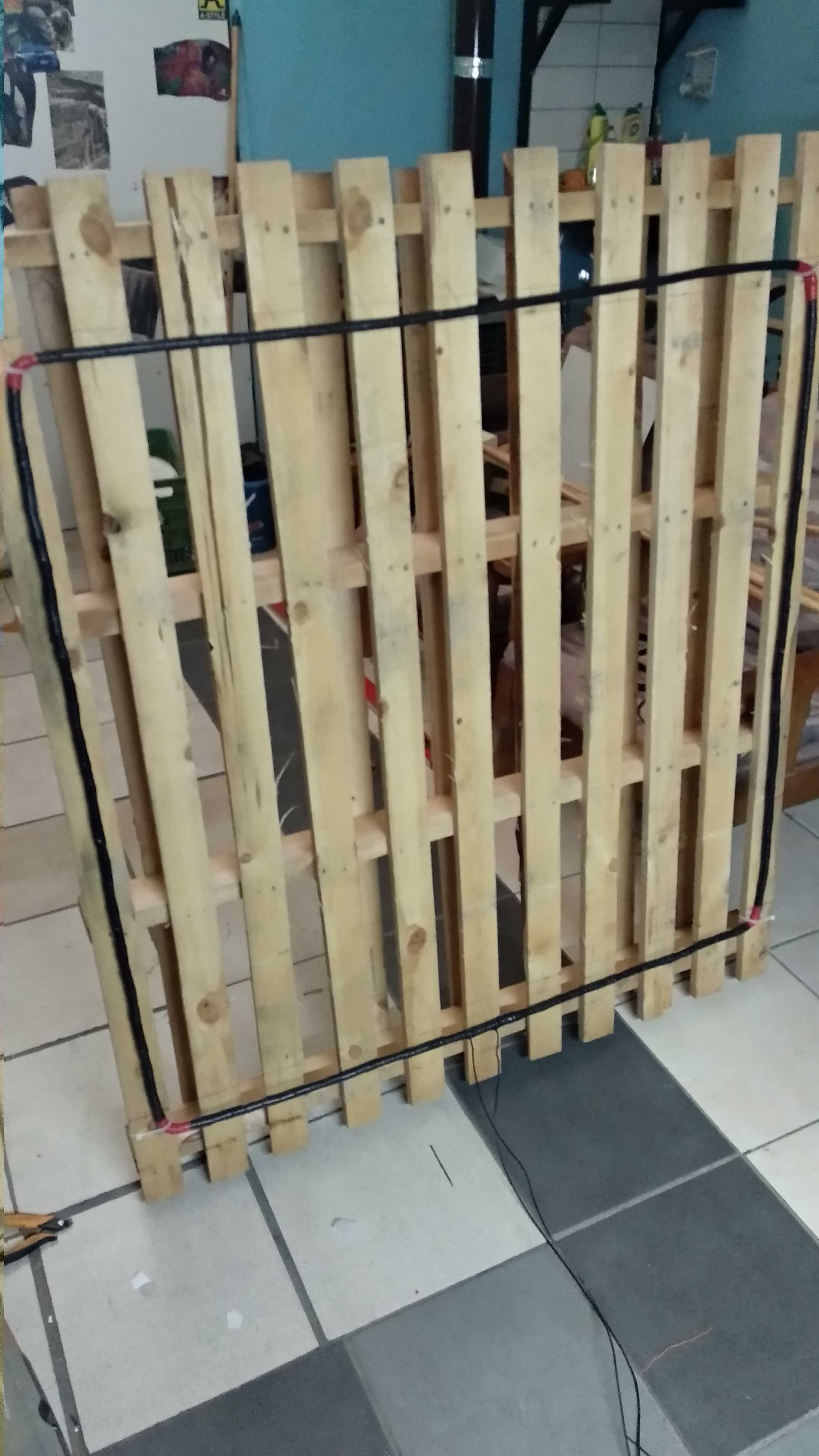

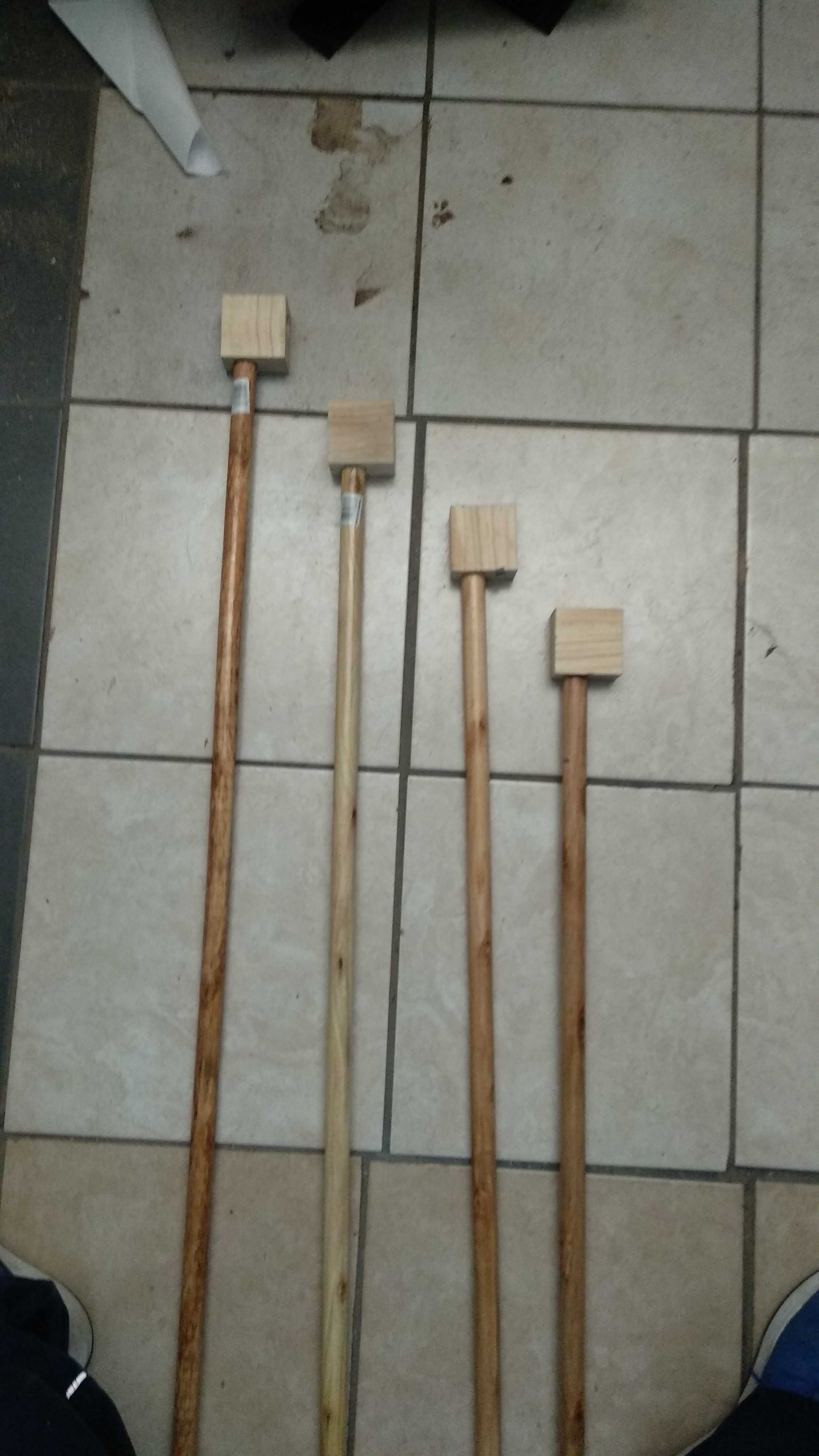

      Probaply demountable because i will have to dismantle it so it can travel...I made as the photo below 4 pieces that a square wood is glued to one wooden broom stick.Then it can be assembled and locked with pastic pins.I think it would be ridgid..
      My question is what kind of wire (single core or multistrand) 1mm?1,5mm? And how many turns.

      • Tried a 1 x 1 with 1.0mm multistrand wire PVC insulated,10 turns gave 370uH and 1.1 Ohm resistance,should the resistance be that low?
        • The resistance of the coil is correct.
          I built a similar coil and the resistance and inductance values ​​are similar too.
          Experiment, with the damping resistance to get the correct value, and it should work fine.

            Just tested indoors the square coil,i have it supported on a wooden pallete because my other coil carriage isnt glued completely.

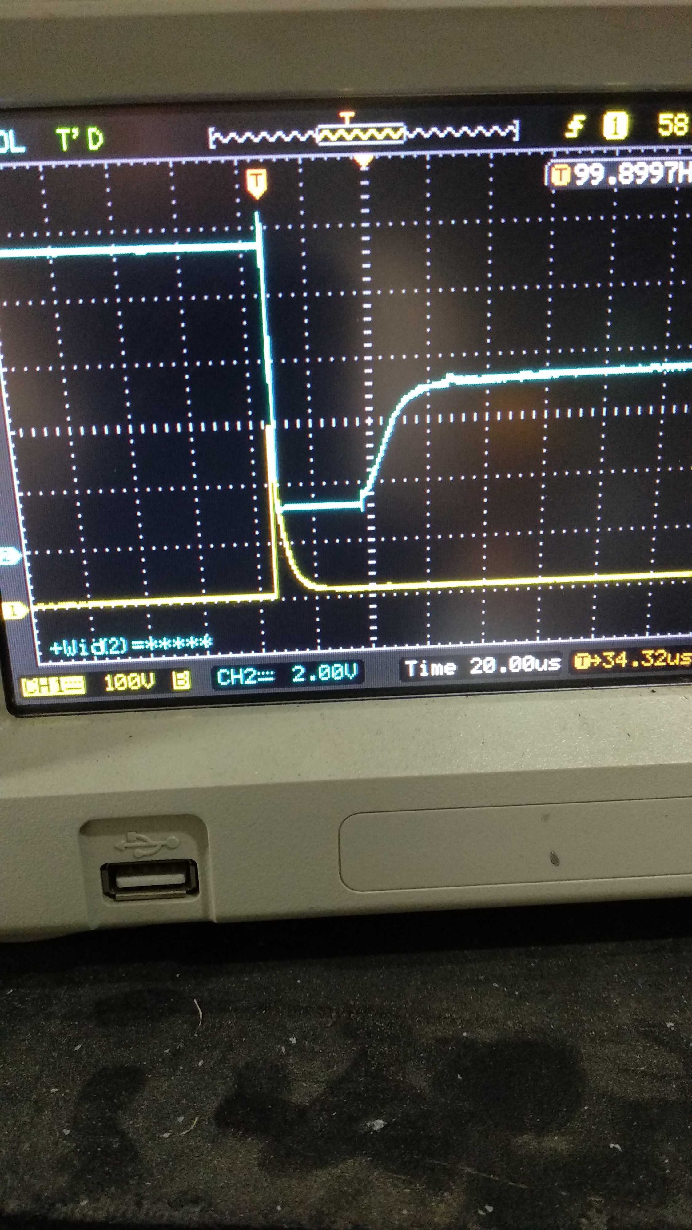

            It damps near 128 Ohms,strange thing my other monocoil for delta i built (50cm OD 0,55mm double enameled coil wire 375uH 2 Ohms) damped with same resistor value,is that normal??
            The damping precedure i make with 3 different pot-resistor sets..
            It seems to work great but it "hits" many ferrous targets as my workshop is mainly constructed with steel.

            • The damping resistance of 128 ohms is low.
              For medium or small bobbins from 30 to 50 cm. I use CAT5 cable. The resistance is around 2; 3 ohms and the damping resistance of 400 ohm, more or less.
              You can use common cable with PVC insulation, 0.5 mm in diameter, or larger.
              The enameled wire greatly increases the capacity of the coil. This may be the reason why it requires low damping resistance.
              The coils of 1X1 mtrs, requires less resistance of damping, because it has greater capacity between turns. A normal value would be between 200 and 400 ohms, I do not remember the exact value of my coil.
              What I do in my DP, to use coils of different sizes, is to install in the DP box a dampening resistance of higher value than normal, for example 560 ohms.
              Then I installed resistors in each coil that determined its value experimentally.

                  If I understood correctly, the 50 cm coil is made of enameled wire.
                  If so, the coil would be the cause of the high capacity.

                    Yes Jose you understand correctly,please excuse my bad enlish..I meant that porsion of this capacity is also from coil leads i left long to connect them directly to detector...Took it for a field test with the 50cm coil,it has great depth on large targets..Think i noticed is that GEB doesn seem to affect anything,when i lowered the coil near to earth i got continuous sound,lift it 10cm and the sound stopped.Tried to calibrate via pot the GEB but i did not notice the difference,i did a mistake not to shield the coil before i potted into mdf
