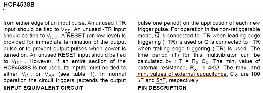

    Dooley, I thought you were right but I had to look that up.
    According to the Intersil data sheet, CD4098 uses a different time delay formula (t=0.5RxCx, vs t=RxCx for CD4538 ). But, that means that we could double either the Rx or Cx value and then everything should be OK. (Double Cx and then use the same potentiometers as before.)
    There are several other '4538' devices out there (such as MC14538, CD14538, HEF4538, HCF4538.)
    These other devices have some minimum restriction on either the Rx or Cx value, or both. Some will work and some will not. For instance HCF4538 has a minimum Rx value of 4kΩ, with Cx minimum 5nF. (Ouch. I wish I knew that before I purchase 20 of them.) Don't try and use that here.
    HEF4538 has a minimum Cx value of 2nF and also should not be used.
    I believe the MC14538 and CD14538 are alright to use because they have no minimum restriction on Cx and their restriction on Rx is high enough that they can still be used on the DP.
    My information may be erroneous - I am not setting myself up to be an authoritative source, that is what manufacturer's data sheets are for. My point is, anybody wanting to substitute one of the other parts would be wise to peruse the applicable data sheet before doing so. Don't assume anything.

                • HCF4538 is not one to use. Datasheet states that minimum timing capacitance is 5nF which is higher than the 1.5nF used on the DP. This is stated on page 2 of the datasheet.
                  CD4538 and HCF4538 are not equivalent. They perform the same function, but HCF4538 imposes constraints on timing components where CD4538 does not.
                  (Don't know for sure but this restriction on timing components may be due to HCF4538 having schmitt trigger inputs where CD4538 does not.)
