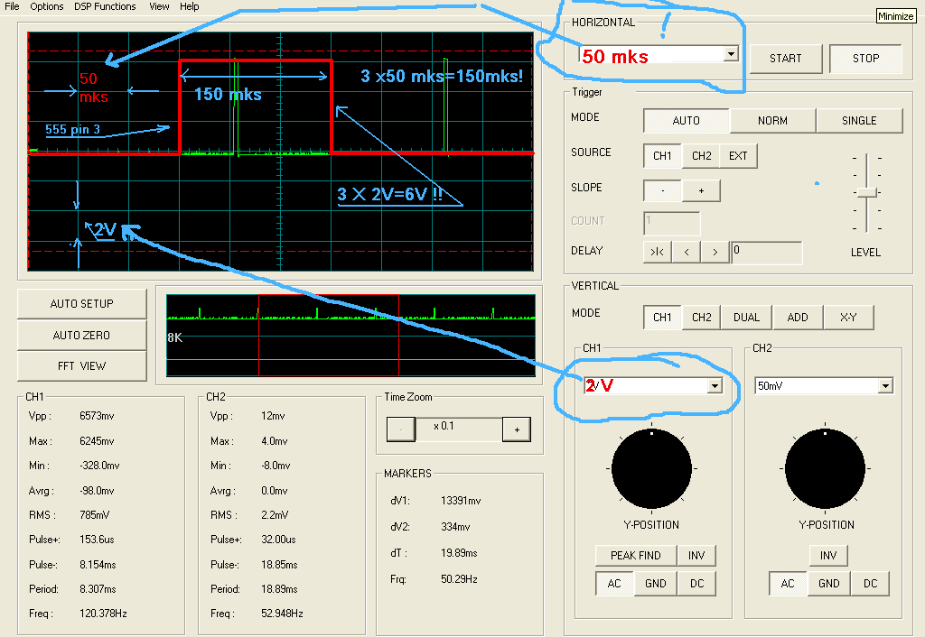

    is this osilograme for pin 3 ic 555 ok?
    • PS-G
      mesyna, until now all is well. Oscilloscope: "HORIZONTAL", including a 50mks

            • PS-G
              Mesyna, sorry, mistake. Not the pulse width is 150 mks, corrected it to 150 mks.

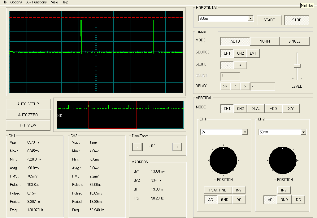

              • hi dear georgi.g.zhelev
                150mks What is the difference 150mks They both are a form?

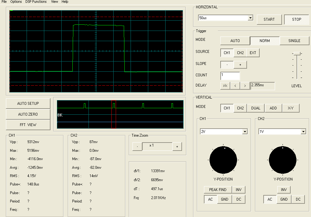

                    • tank you dear georgi.g.zhelev
                      now this osilogram for pin 3 (555) is ok?
                      • ps-g
                        mesyna, all ok! ne5534 pin 6 + 0,2 v (trimer).
