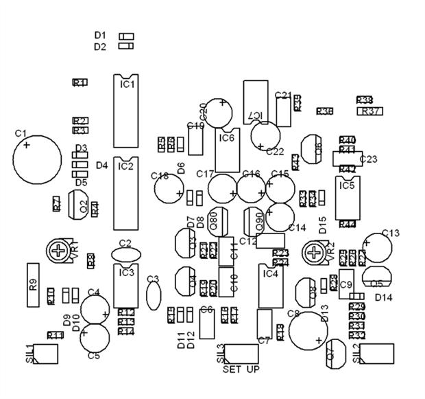

    Bump! again! sorry! just got a virgin pcb created from gerber from this project an a poorly drawn schematic an an error prone pdf for components on this.an need to confirm before component placement?Thank!

          Ok,as mention before,I have a new pcb,created by gerber files from here,The issue with incorrect tracks layout an 14 pin to 16 is corrected an the track error to leg of fet,is corrected also.
          now all components are loaded an soldered carefully into the double sided pcb.Ive tried to ensure that both top an bottom tracks are soldered accurately.
          the issue is the unit doesnt work! not a peep? only faint click thru speaker on switch on.
          Ive noticed an tested in preliminary checks that the audio output transistor BC214 pnp is increase in temperature to 100c alarmingly to critical after switch on.ready for destruction at this temp!
          Ive traced the track layout top to bottom many many times,as per all the pics an data here!all apears ok. trackwise an with no solder bridges,viewed thru x5mag lens.
          Ive used a thermal probe over all the components to check hot spots an this is it!
          By the way i do have a working CS6 as a comparison,thanks to good forum friend Draco.this unit works well an probe over this working component BC214 audio output results in 23c degree running temp.
          Whats wrong here??
          Ive replaced the Bc214 audio transistor an configure the base an collector pins around the oposite way with no result at all?
          then again another new replacement as per original with same Hot result!
          Ive built another complete new PCB Again a No2 with again all new components,exactly same result?
          Ive had another Technician check an Proof the track layout for all!
          Working purchased unit,both gerber created pcb,all schematics an pics from Here!
          Nothing untowards was found all apears ok.
          Now their must still be a lurking ,Critical Fault in the Gerber created boards.
          Has anybody else Here at Geotech ,created an built a working pcb an unit from these files an what was found??
