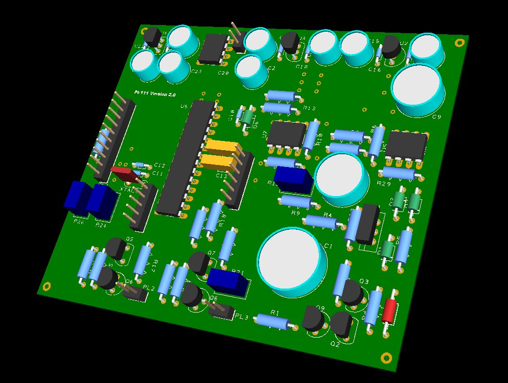

            • PI-111 Version 2.0
              As promised, here is the latest version of 1843's PI-111 detector:
              • u5 u7 opamp
                u5 and u7 = ?ad797 ?ad844 ?lf347 ?ne5534 ? ? ? ? ?
                • Hi Qiaozhi,
                  There are some errors... please see the changes needed to apply:
                  http://www.geotech1.com/forums/showp...&postcount=159
                  Thanks a lot!
                  Unregistered,
                  Any op-amp can be tried. I would use two NE5534's at first.

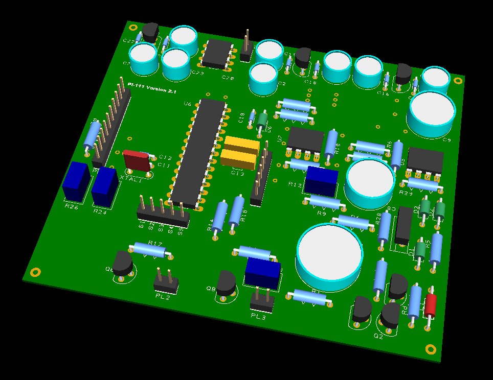

                  • Version 2.1
                    Updated schematic and PCB.

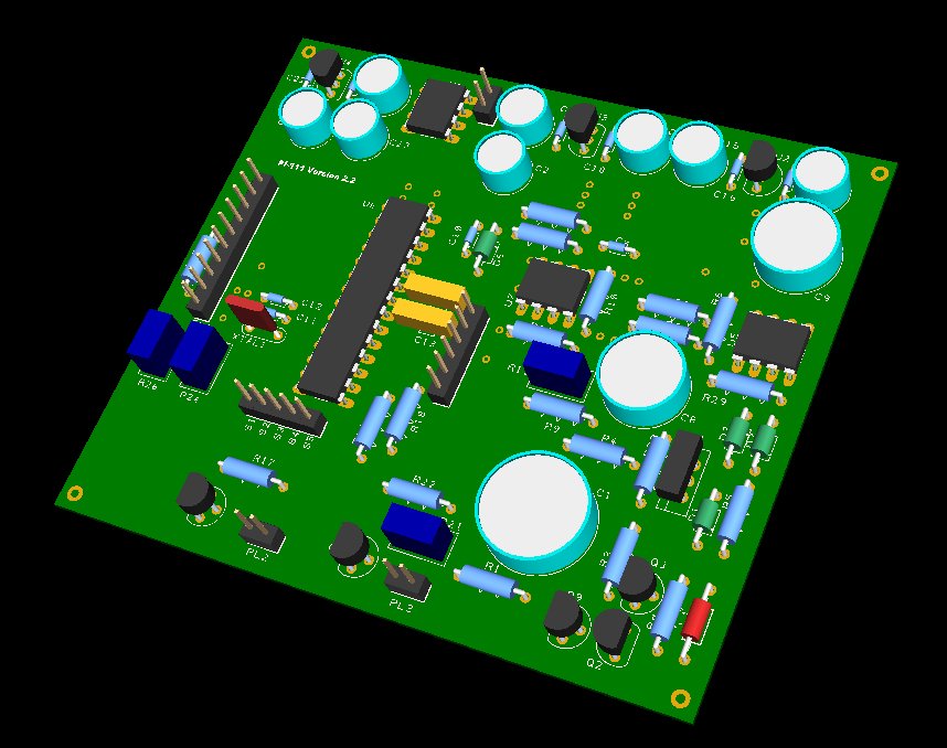

                    • Version 2.2
                      Here's the latest (and hopefully last) update for 1843's PI detector.
                      Changes made:
                      1. Swapped over S2 and S3 on schematic.
                      2. Added Cx across R10 as optional component.
                      3. Tidied up component placement / silk screen.

                        • hello i have on question,what dimensions have this pcb board thank you
                          • Great!

                            • Originally posted by Vermeer111 View Post
                              The board dimensions are 4" x 3.5".
                              This is slightly wider in the y direction than the Hammerhead PI RevD PCB, which is double-sided.
