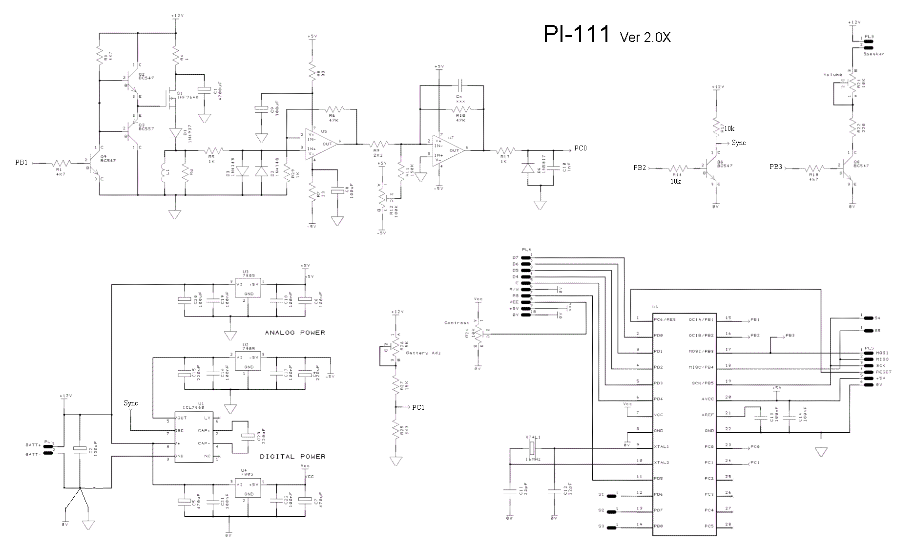

      You're right....I missed a pcb too. Some tracks are thin and that's because of the ground plan. You may want to design a pcb using star topology methode rather than ground plane.
      The new schematic below indicates different grounds for that job:
      And also the pin Sync is connected to Q6. By this way, the PB2 can be implemented to generate a frequency twice the PB1's, so the frequency of DC converter will be the same with the detector.

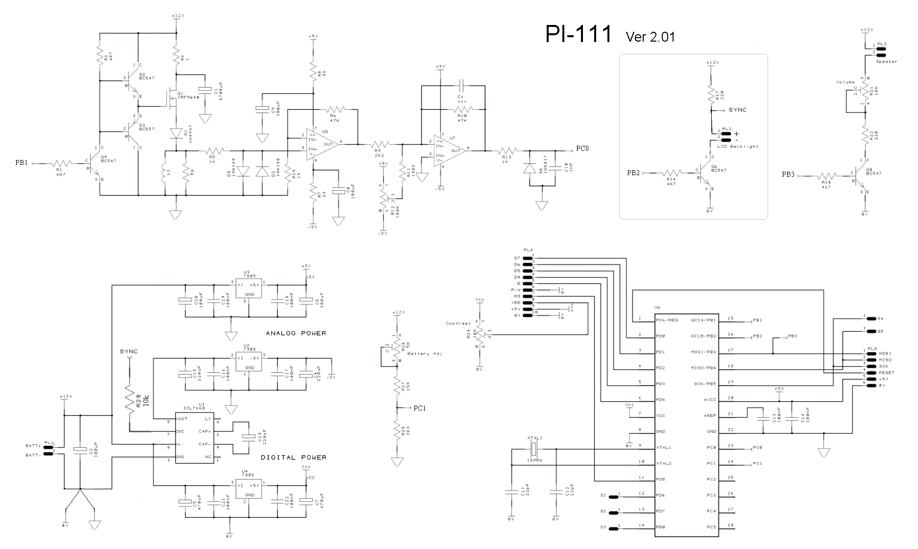

                    • New Hex and sch
                      The syncing resistor is connected to PL2. (The reason is as the Pulse-Width is varying over the time, it may causes some instability.)
                      The frequency of PB2 is doubled.
                      R28=10K.
                      Please have a look at the schematic, the backlight circuit is modified:

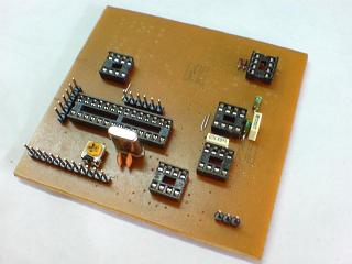

                      • new board being built,for P1-111,an supply of Atmega8 for programming.A bit rough around the edges,but trackwork from the etch was best of 2 tries of pcb
                        bit by bit,will get there?Cheers! everybody!
                        Rov
                        • Originally posted by Rov View Post
                          Rov
                          A half built board... I don't have enough time to complete it. maybe in the summer...

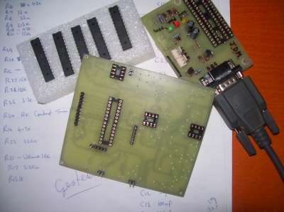

                          • hi 1843!
                            Updated schematic and PCB!
                            • Originally posted by kingsage View Post
                              Hehe, this board isn't belonged to PI-111 ! But later I will be using it for testing PI-111.
                              • Updated PCB and Schematic?Where? I thought I was On the Last of Revision of this!
                                Maybe I missed something?more Ic sockets,Im lost an confused!
                                I must be wasting my Time,Oh No!
