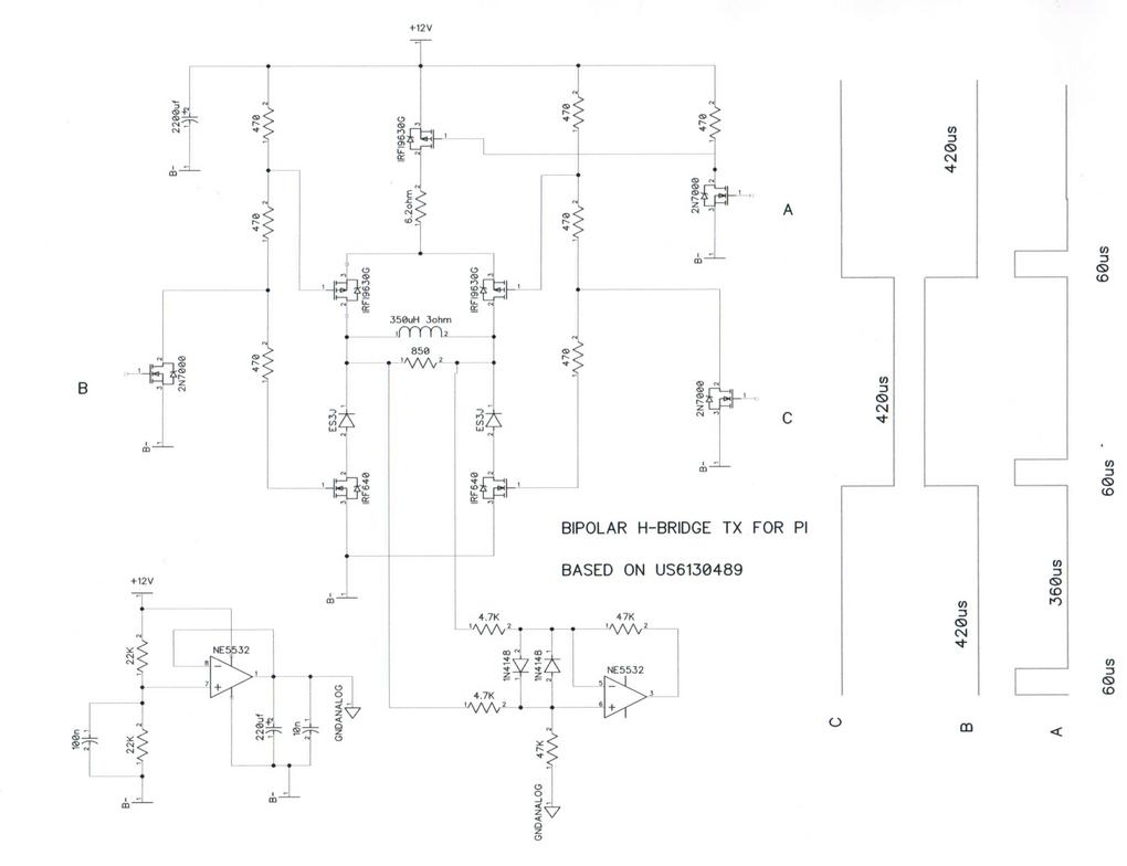

          Taking the schematic from patent 6130489. I came up with this interpretation. I left out the zenor diodes, which as far as I could figure, had the purpose of snubbing the flyback.
          Common n and p channel fets were used in place of bipolar transistor. Supply voltage 12v, 5v switching logic to the 2N7000s. I used a pulse frequency around 2.3khz and pulse width 60us. These could be adjusted up or down. I had timming program already done and just adapted it to this circuit.
          The circuit operates by alternating the polarity of the coil using an h-bridge. The
          h-bridge is then pulsed on and off with a p-ch fet. One side of the coil is always connected to B-. So this operates like the p-ch Surf-pi with a coil that reverses after each pulse. A differential amplifier is connected accross the coil. The output is true bipolar and centered about +V/2
          I need to play with the preamp some more. Lots of parts, but it works on a single supply.

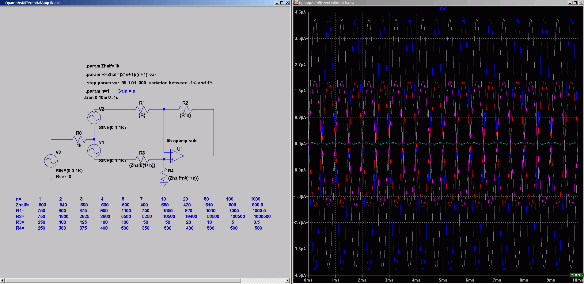

            Anyway, to make your differential Rx really differential you may want to supply each branch an equal impedance, and traditionally it is achieved by duplicating resistances in inverting and noninverting branch. Due to the nature of a noninverting branch to exhibit some interesting properties of current being dependent upon several other things, including the noninverting voltage, in effect the impedance of an inverting branch is lower than the input series resistance. You may fix this by using instrumentation amplifier, or make the opamp truly differential. I may have a solution for that, and I already put my solution on Bandido 2 topic, but here it goes again, a LTspice file with an accompanying picture, and some solutions for various gains and a total input impedance ~1kohm. There are several gains with "nice" resistor values, but many more with "naughty" ones, so have it your way.
            You are free to play with this solution as ever you like.
            Just a note, CMMR gets spoiled a bit when there is a series resistance of a source added to the calculated values. To maintain the best CMMR it will be OK to introduce Mr. Thevenin to the equation and transform that dumping resistor into two series ones, and substract that value from the opamp ones. Just a thought. (instrumentation amps do that without any math)

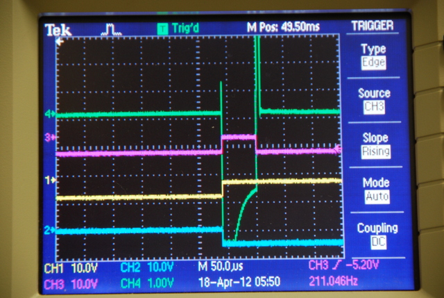

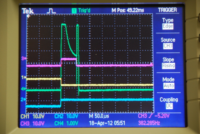

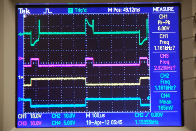

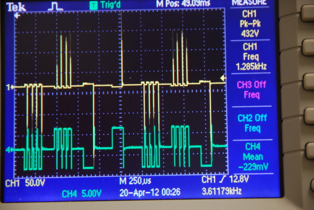

              Hi Altra, good circuit but I think it may still have a problem. If you look at your first cro shot and the top green waveform the first and third pulse looks ok but the middle one should be an exact opposite to the other two. Like what mine looks like.
              Mick
                Mick
                That inverted flyback spike is happening in the differential amp. When metal
                is near the coil it moves in the right direction. The scope hooked directly to
                the coil looks ok. The pulses are not square because I'm using current limiting.

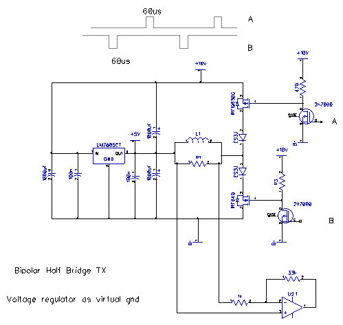

                    Thanks, to Mick's outside of the box thinking. I revisited the Dave Johnson halfbridge transmitter. This is decribed in the patent US4,868,504. Dave was way ahead of the times. In my opinion,(fwiw) this patent is miss titled. When you get past the energy
                    saving aspects of the regenerative halfbridge driver. He then describes
                    generating different step functions and demodulating fundamental and harmonic frequencies to eliminate resistive and reactive ground minerals.(dual frequency). He also descibes time domain sampling as applied to PIs.
                    Anyway heres what I came up with, it can be improved with proper fet drives
                    and I going to replace the LM7805, with an Analog Devices OPA547(ebay) high current op-amp. This will allow the virtual ground to track the supply rails. This circuit can also generate a combination of continuous wave and PI TX signals to create a true hybrid detector using a balanced IB loop and a filter or two.

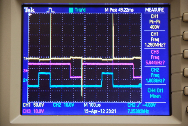

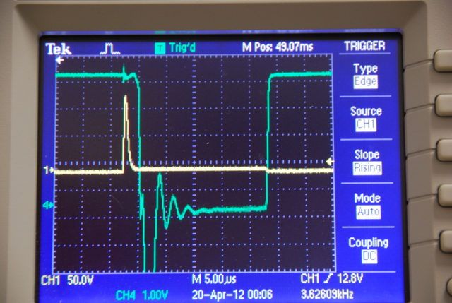

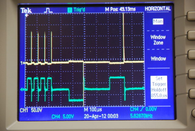

                      Hi Altra, thats a good result, now the only problem left is the P-channel limitations. Here's a couple of cro shots the top one is on the coil showing about 280 volts on either side although my cro wont show it. The tx is running at about 100us. The other shot is just of the cleaned up output of the clamping diodes. I'm still using a 6 volt power supply to run it at the moment but will be making up a 7.2 volt pack and a DC-DC converter to run the opamps etc.

                                Hi Tepco, thanks for the reply, the previous cro pictures were of the all nchannel version, the version in my last picture is a P/N version it's first sample is being taken at about 8us and the second sample is taken approx 35us after TX. The ferrite rod shows up in both primary target and secondary GB sample's. This particular ferrite rod must have a high iron content because magnets are attracted to it and I could balance it out to show no response from the output of the last diff integrator.
                                I guess the only way to really test it is to finish the audio stage box it up and go out to the goldfields and try it.
