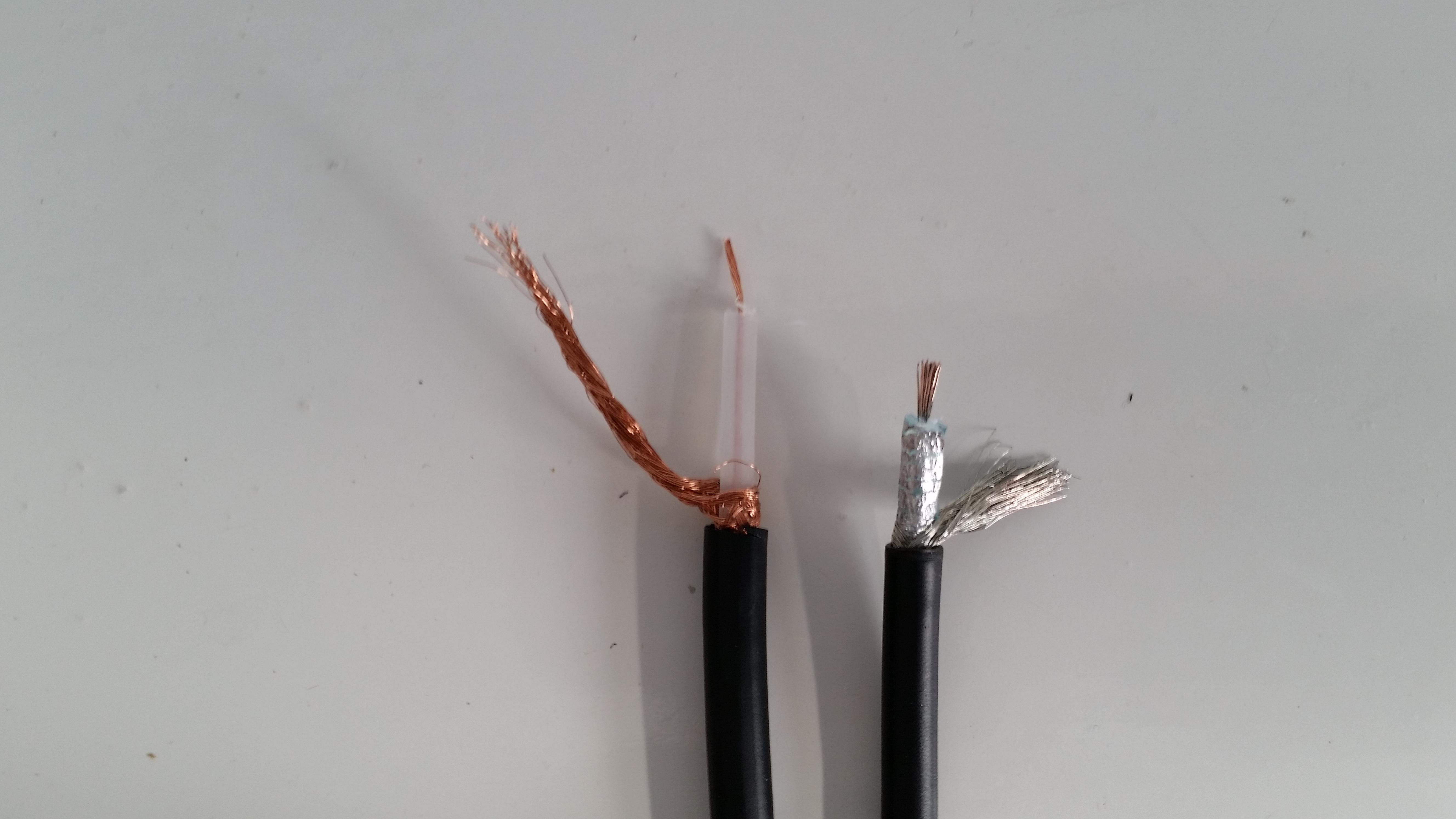

                        I have two types on is a bit thinner and is steel braided and steel cored, or I have some 75 ohm which is all copper, but the overall diameter is a bit bigger.
                        I was wondering if I could use the steel, but I thought connecting steel to copper wasnt very good as you get some electrolytic action because of the two dissimilar metals. So I will maybe give the 75 ohm a go.
                        • Originally posted by chrisw View Post
                          Thanks George.
                          Is the steel coax actually steel or just tinned copper?
                          • I had scraped it to see if there was copper underneath, and I coudnt see copper. But after you posted this message I tried again and scraped harder and it is tinned copper. This also has a layer of foil as well. I dont know what the impedence is. It is a linking tv aerial cable.
                            So I have a choice now, Im not sure which would be better.Click image for larger version
