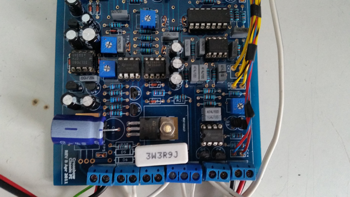

  • I did all this when I set it up but the resistor is still too hot to keep my finger on it. Maybe it shoudl get hot; it is a 2W resistor so should be able to manage the heat. I checked the pulsewidth again yesterday and it is bang on 120uS. I was just a little worried about this heat buiding up in the sealed box.
    • I decided that if a resistor is too hot for my fingers then it is too hot to be sealed in my box.
      So now I have replaced the 2W resistor with a 3W ceramic resistor. I could only get this locally if I had a 3.9 ohm instead of 3.3 ohm, but I dont think this would make much difference? Please correct me if im wrong.
      Maybe this is a bit of overkill, but it is only mildly warm now, feels much better. The power transistor is lukewarm also. And performance wise I am still getting 19 inches on my £2 coin so I cant tell any difference.Click image for larger version
