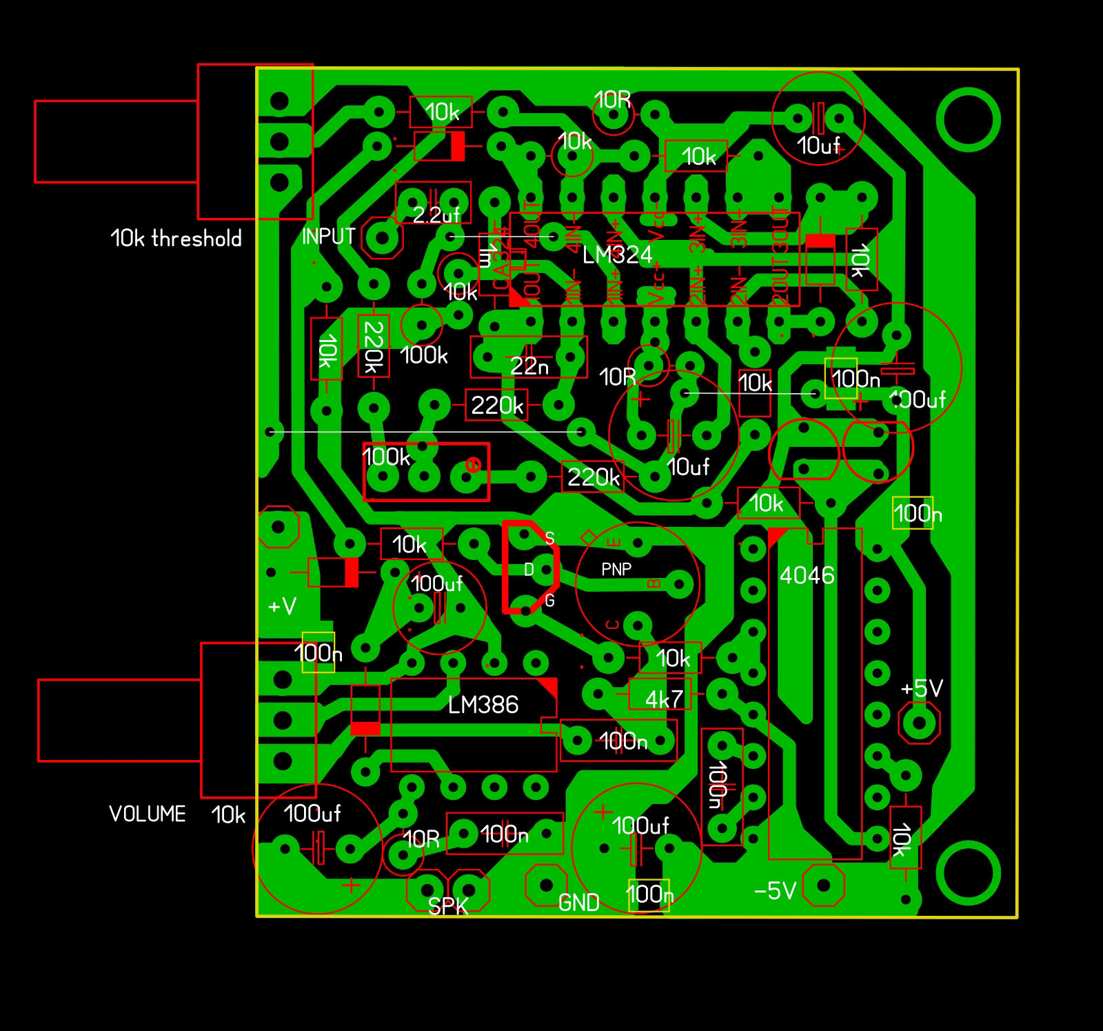

    Maybe give yourself a bit more clearance around the +5v input pad too Dom44, I would shuffle it away from 4046 now that you have increased board size ...it looks like you are using pcb pins ... If not then probably OK..
    Are you get the boards made or will you do yourself ? Should be great little through hole board
    cheers
    mdtoday
      I make my own boards I find it easy now made hundreds of boards over the years just for fun for me. I prefer pins makes it easier to solder wires or re-solder when they brake off. good thing i checked it forgot to reconnect the 4046 -V pin after moving the pad.

        Hi Mdtoday,
        You've done a fantastic job with the PCB. It's great to see someone here continuing what I started.
        I can't remember whether I mentioned in the original thread or not, but the primary purpose of this design was for the final stage of a ground balancing detector. At some stage I'll redraw the rest of the circuits and post them up.
          just tested my board with the error fixes works great, Hi mickstv you did a good job with this design thanks

            Hi Mick,
            thanks and thanks for the original design, great to hear you still visit the forum , mate your output stage is rock solid, I've used it on my bench for do long on an old veto board lash up, it finally gave up and I thought I should put it to PCB and share. So
            great design and yeah you did mention it was part of a gb balance machine you were working on.
            If you post up I'll do a board for you if you like, no worries at all.
            Also if you pm me with a postal address I'll send a couple of loaded vco boards.
              dom44
              [ATTACH]45457[/ATTACH]
              Thats good to hear, its looking great and glad it's working..

                I would like to try this neat circuit and nice to know it works great. Nicely done with the layout too.
                I went into town today to purchase 4046 at local shop, and guess what, they don't have any in stock! Rotten luck. I will try common 555 with some magic to see if I can get similar result, otherwise I will have to order the chip.
                I can't even find PIC chips on entire island. Everything has to be ordered from overseas.
                  If anyone wants the board here it is
