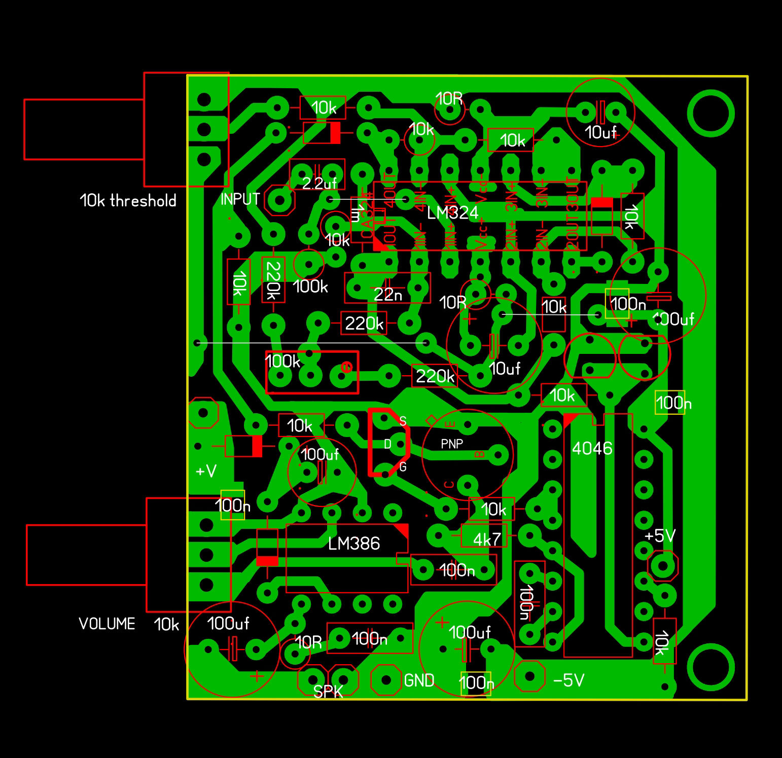

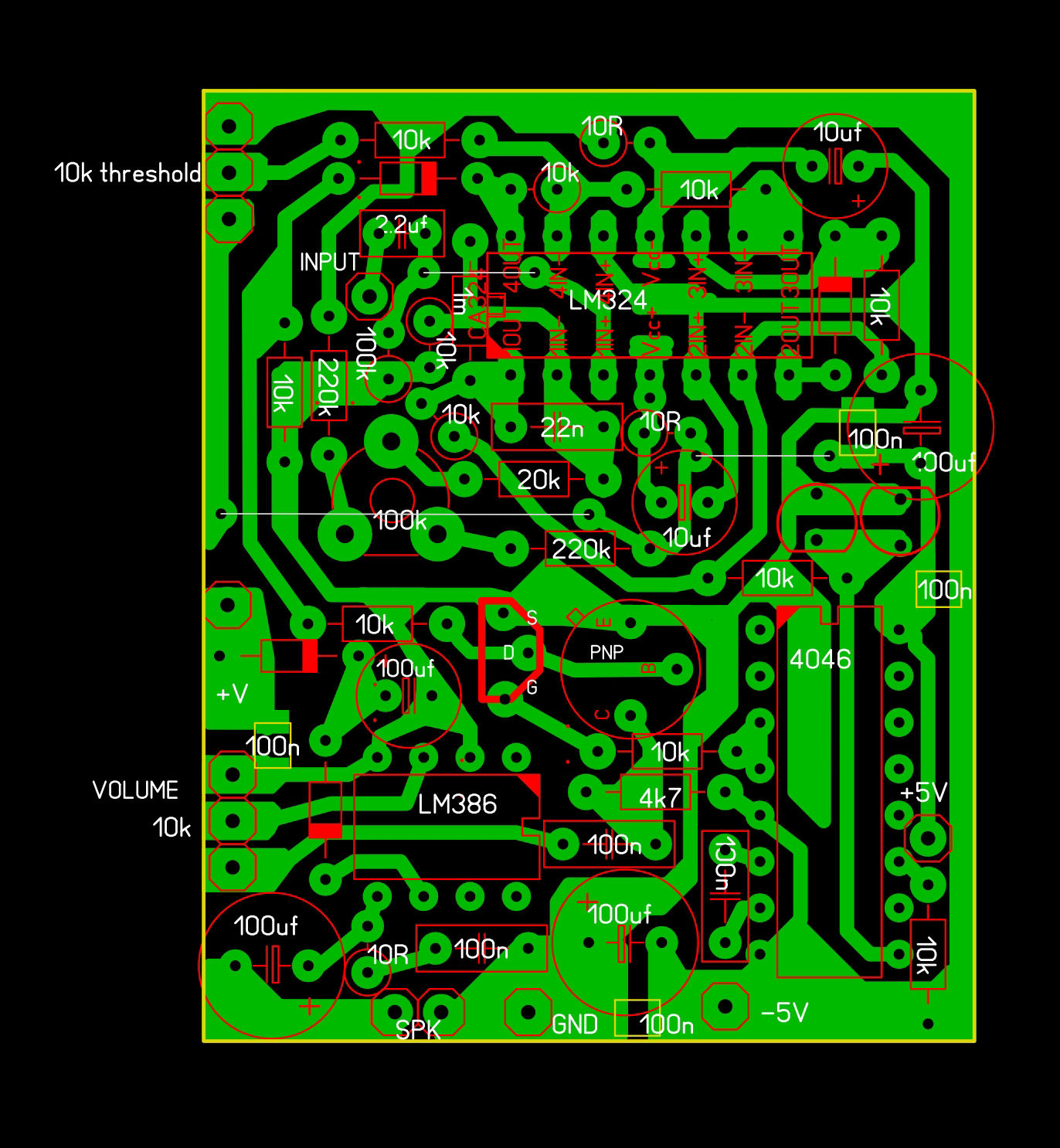

    this is how i made mine but i added a LM386 amp stage this VCO is a good circuit,
      [ATTACH]45447[/ATTACH]
      Great work Dom44, thanks for sharing
      cheers
      Mdtoday
        I made it as compact as i can using standard components you should check it i tested on the bench but haven't installed it in a detector yet.

            I will draw it up give me some time, it is the same circuit you posted just added the LM386.
              Dom44,
              I noticed you don't have the 2.2uF input cap on the board, was that intentional?
              I'll build up another couple of boards and try a few different Opamps too.
              cheers
              Mdtoday
                I was going to put it on the detector end ran out of room I will see if i can fit it in.

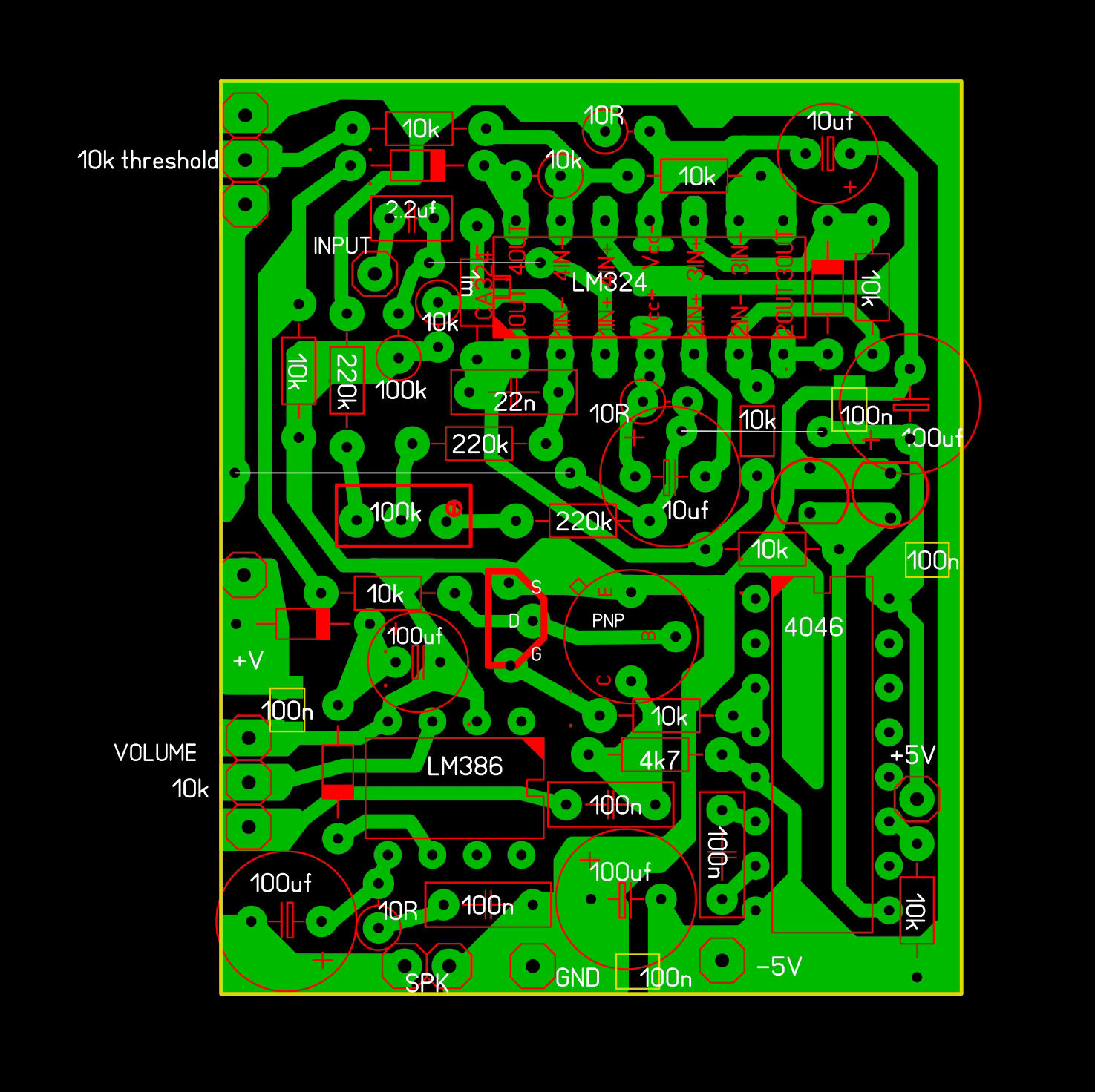

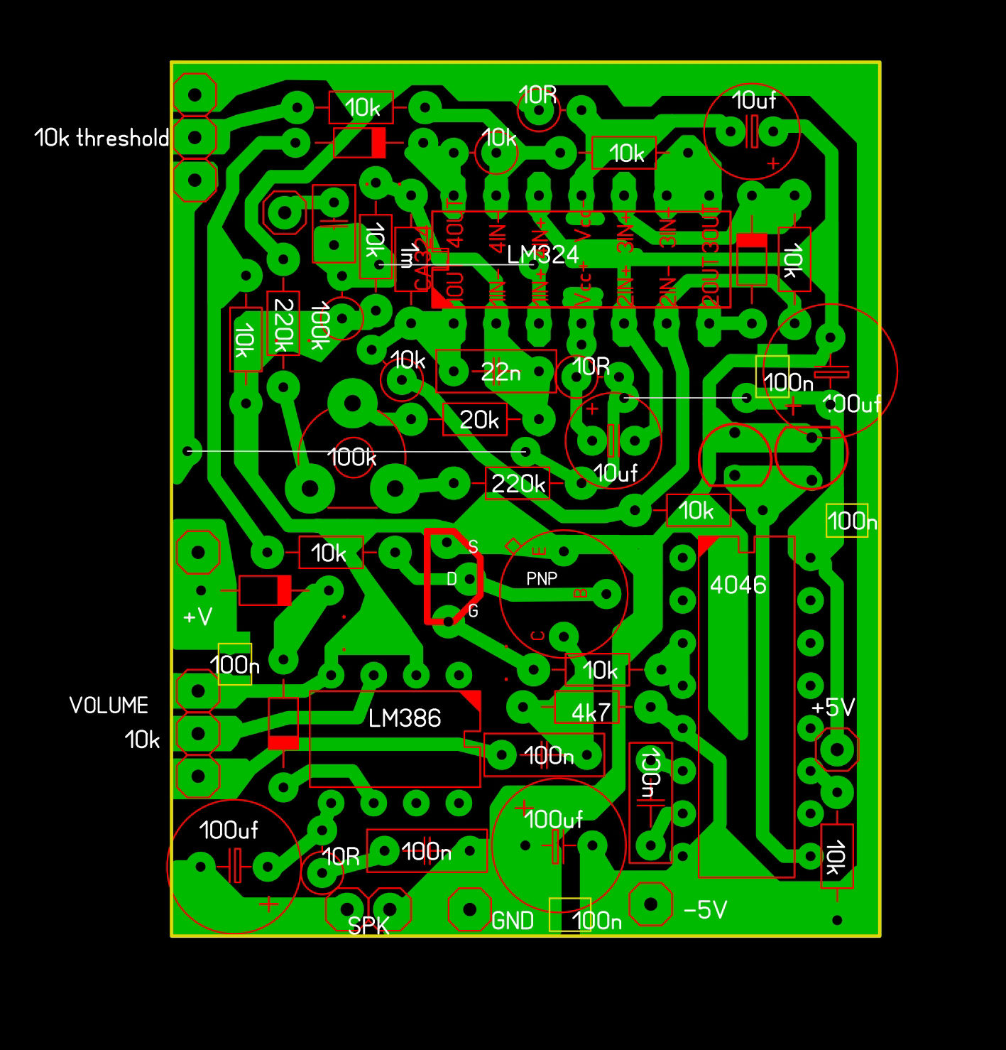

                  just squeezed it in bit better vco- added a 100uf decoupler cap to amp on this one should be it now
                    just squeezed it in
                    [ATTACH]45449[/ATTACH]
                    Good job and thanks
                    cheers
                    Mdtoday

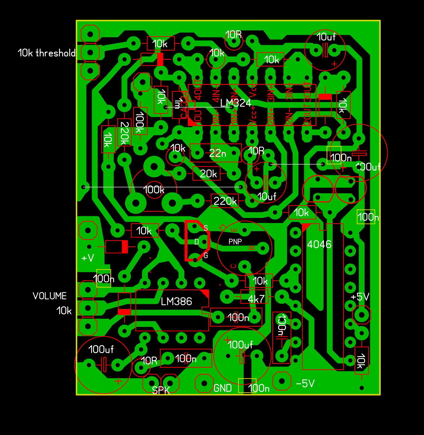

                        [ATTACH]45451[/ATTACH]

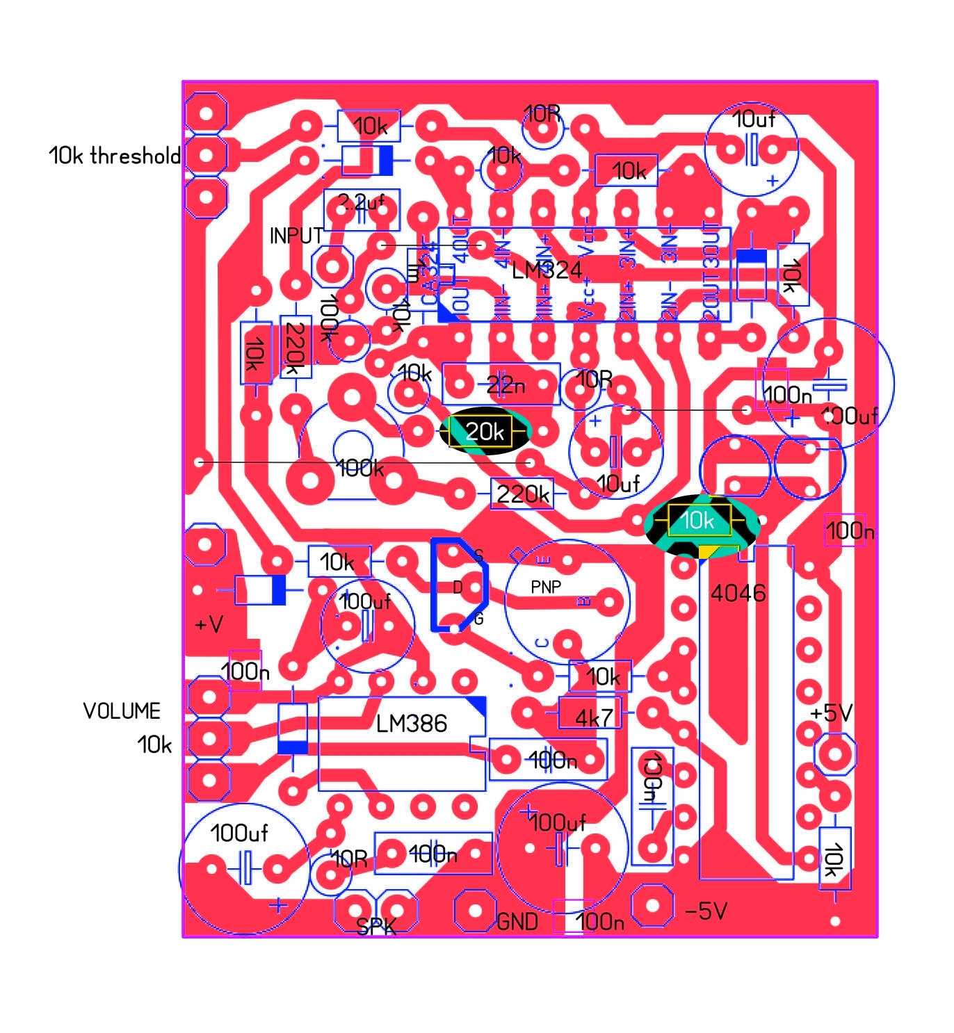

                        Hi Dom44,
                        Just a couple of things I spotted, see markup
                        1) the 10k input resistor to 4046 pin 9 should be direct to output of first opamp
                        2) You have a 20k resistor marked instead of 220k.
                        3) I would suggest using a 10 turn preset for the input offset for finer zero adjustment
                        Cheers
                        Mdtoday

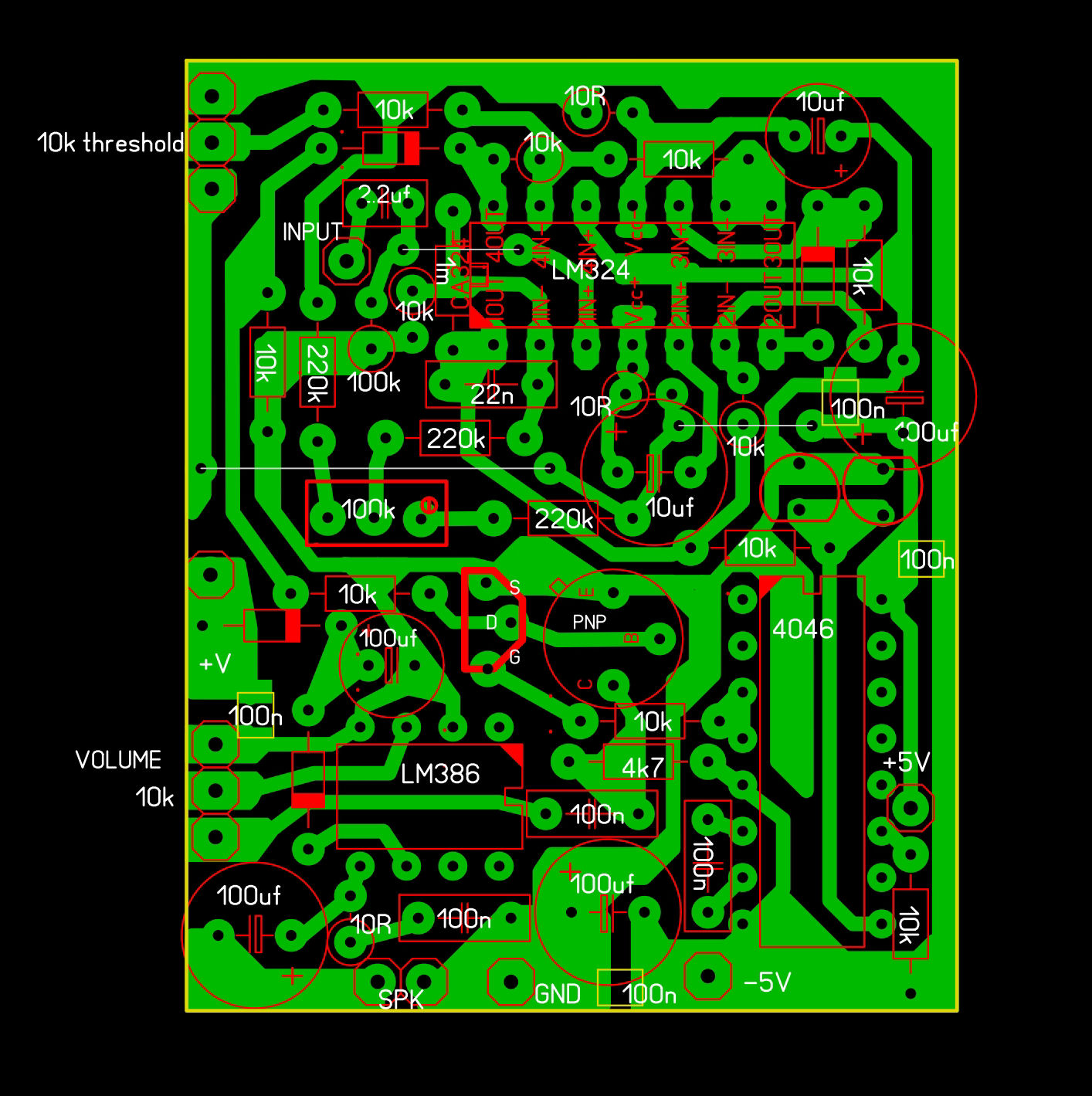

                          thanks Mdtoday i think i have sorted it you are right my circuit is the hand drawn one the 220k looked like 20k should be ok now put in a 10 turn and moved the 10k resistor the 10k explains why my the LED's where not working correctly.
                          Dom44
                            No worries Dom44, I did a quick spice of your circuit with lm324 and it appears to be fine, didn't check drift but should be ok
                            One last suggestion if I may, perhaps 3.2mm mounting holes in or near corners if you can increase pcb size, that way even with panel mount pots, you can relieve stress on them using the mounting holes and spacers to main board or enclosure.
                            Even a couple on oposite side to pots would do it.. 8 mm corner clearance will avoid shorting -5 v to case etc. Hope this helps and good work btw
                            cheers
                            mdtoday

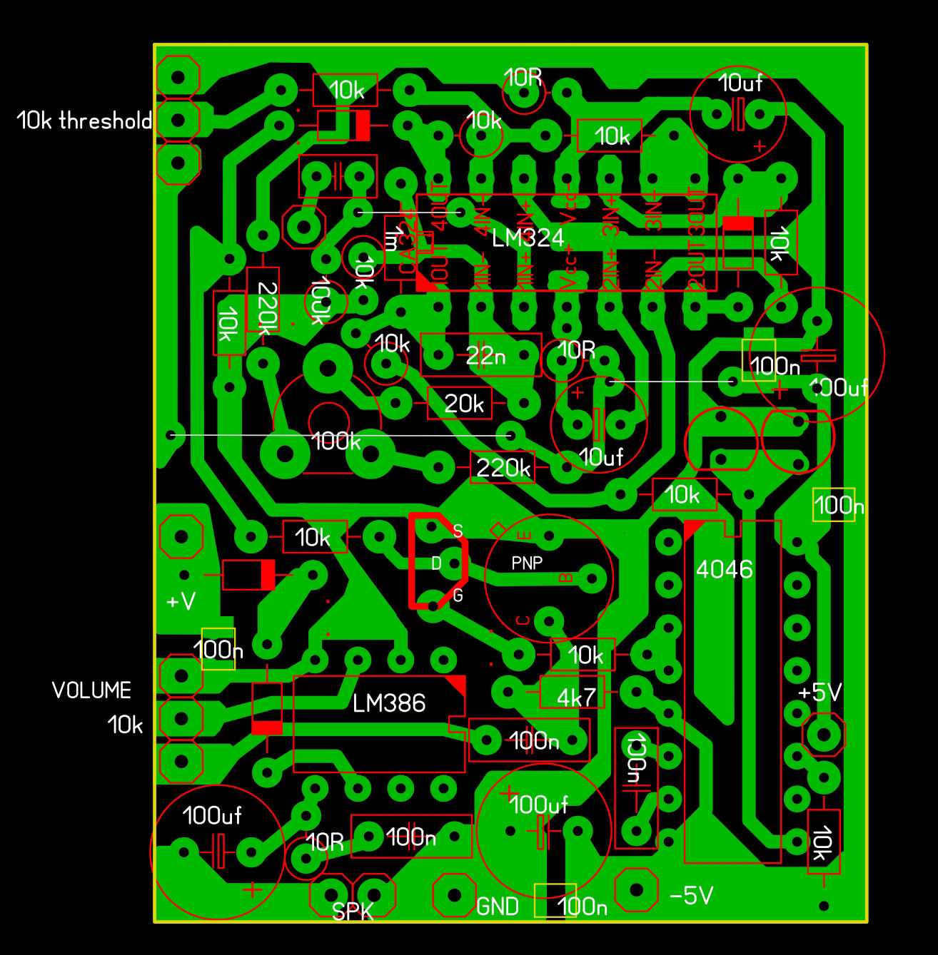

                              how about this one?
                                how about this one?
                                [ATTACH]45456[/ATTACH]
                                Yes, that looks more robust, good job
