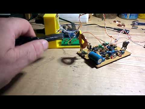

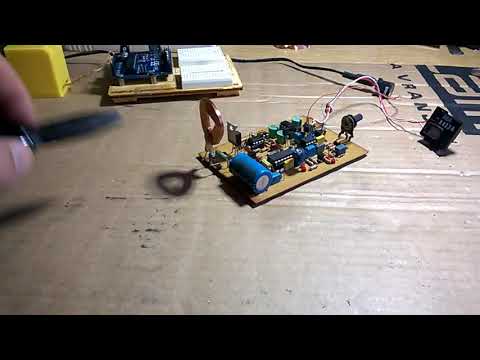

    First, here is how it works with CD40106 originally:
      Second, here is how it works without CD40106 and hooked to Arduino.
      Blast! It behaves "reversible"!
      Duddddeeee!!! I made Minelab Sovereign now!!!
        If you pay attention on details; you'll see the one of orange wires (which is GND at Arduino) is put to socket in place of pin 14. of CD40106.
        And like that i got "Minelab Sovereign" lookalike behavior.
        But if i take out that wire and put it in place of pin 7. of CD40106; than i get normal behavior, similar to what you can see on first video with CD40106 on place.
        But in this case i can not turn delay pot too much and get proper detection in whole pot range.
        Obviously this is the signal level problem. Arduino provides 0-5v range while at this version of Barracuda levels are ... in shortly WEIRD!
        CD40106 is supplied inversely to provide proper signal swings to switch the fets.
        This can be fixed. Funny ... i didn't pay attention on this earlier, that's why i don't recall it... and now am surprised!
        Blast!
          Man, that's a damn good dept with such a small coil. What about the coil data or it is sort of improvisation?
            It's a coil taken from old 5.25" floppy disk. Several of those at each disk.
            Good for testing on the bench various things.
              LoL, i know I've seeing it somewhere.... On my "Правец 16" ;-). One 360k and one 1.2m are rolling in my spare part boxes, if my wife do not throw them already. The NEC V20 project is already doomed(my father give gift my precious EGA monitor), so i just find new use for these ;-))). Thank you.

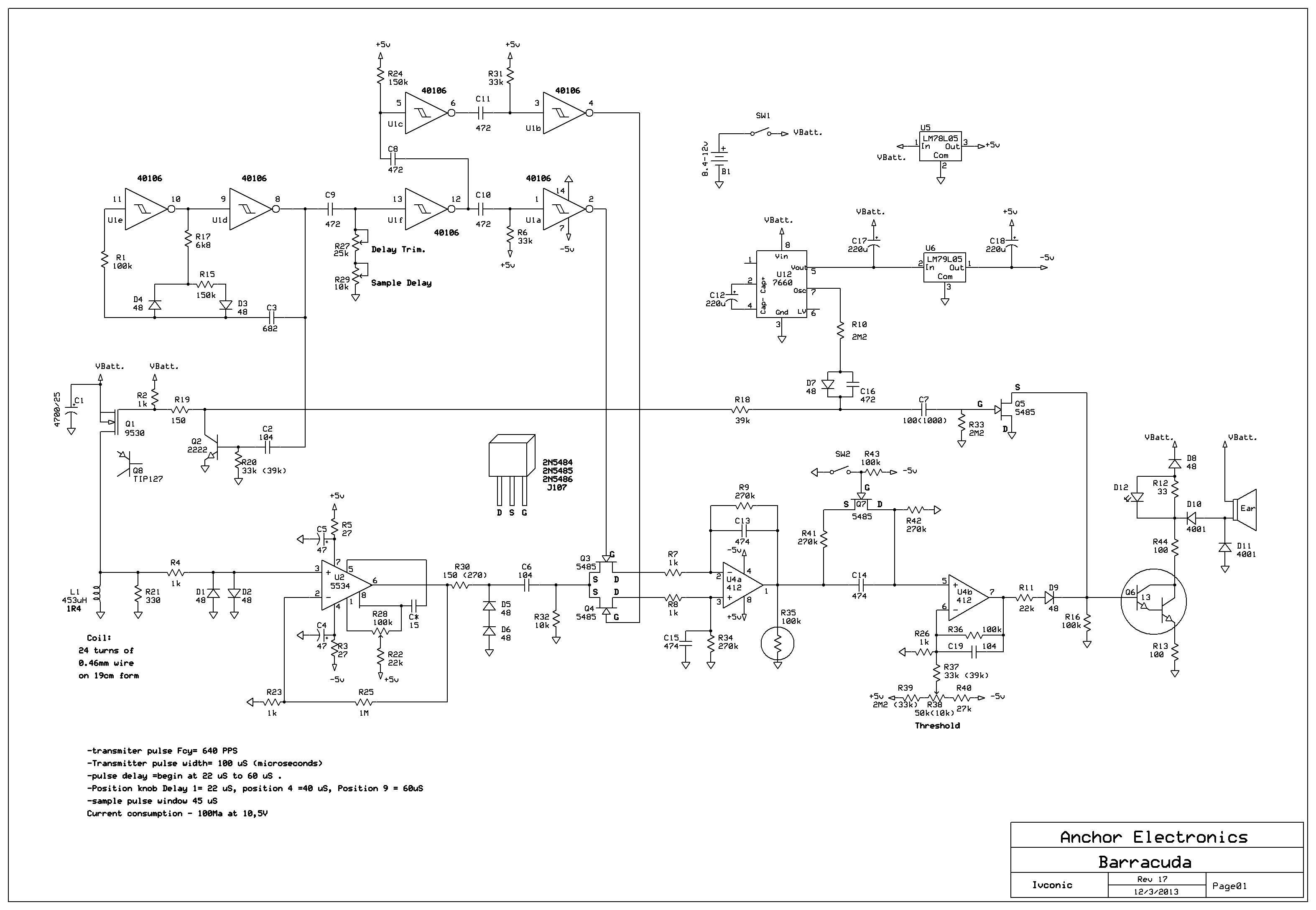

                  Hi all,,,Does anyone know where I can find the schematic for the Barracuda layout that Ivconic posted please? Thanks in advance.
                      @Ivconic,,,,CONGRATULATIONS on the EuroMag,,,I have always followed the knowledge in all of your posts and have learnt a great deal from your skills and your kindness in sharing,,Best wishes for you and the EuroMag for the future.Regards,,,Marty
                      It takes time me to locate it on the disk. I think i posted it in the post, somewhere on the forum.
                      I tried to trace out it from the pcb directly, hopefully no mistakes.
Name:	Barracuda Original.JPG
                      Than there is Qiaozhi's post too, here: https://www.geotech1.com/forums/show...roject-Details
                      It would be productive to compare those two and see if there are differences.

                        Resistor 35 is a bit of a mystery, it is shown on some circuits and not on others, it also is shown on different locations on the circuit.
                          Not present on my working pcb, probably that's why i draw circle over it.
                            Thanks, I guess the circuit works ok without that component
                              @Ivconic,,,,Thanks for the schematic,,Regards,,,Marty
