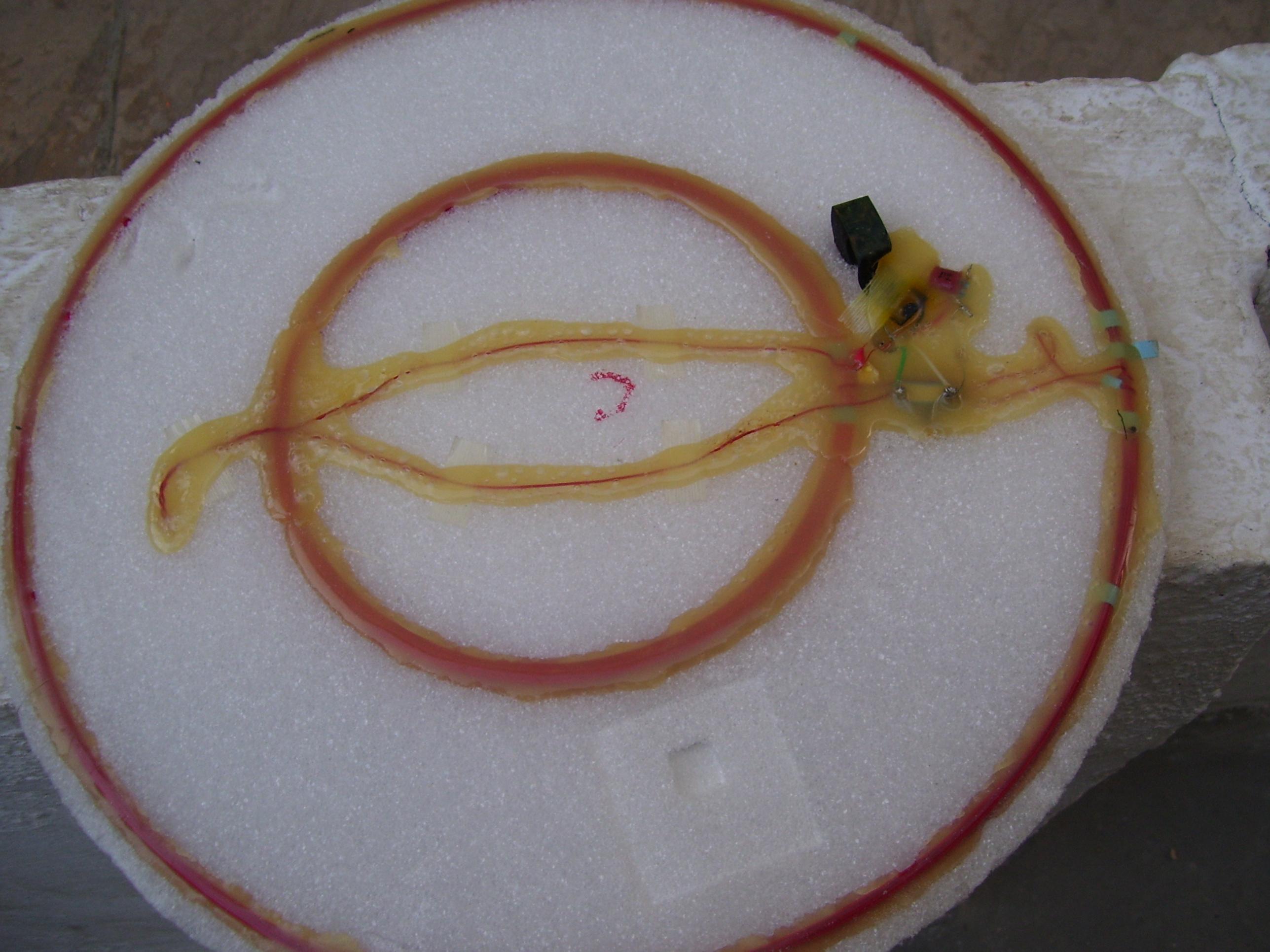

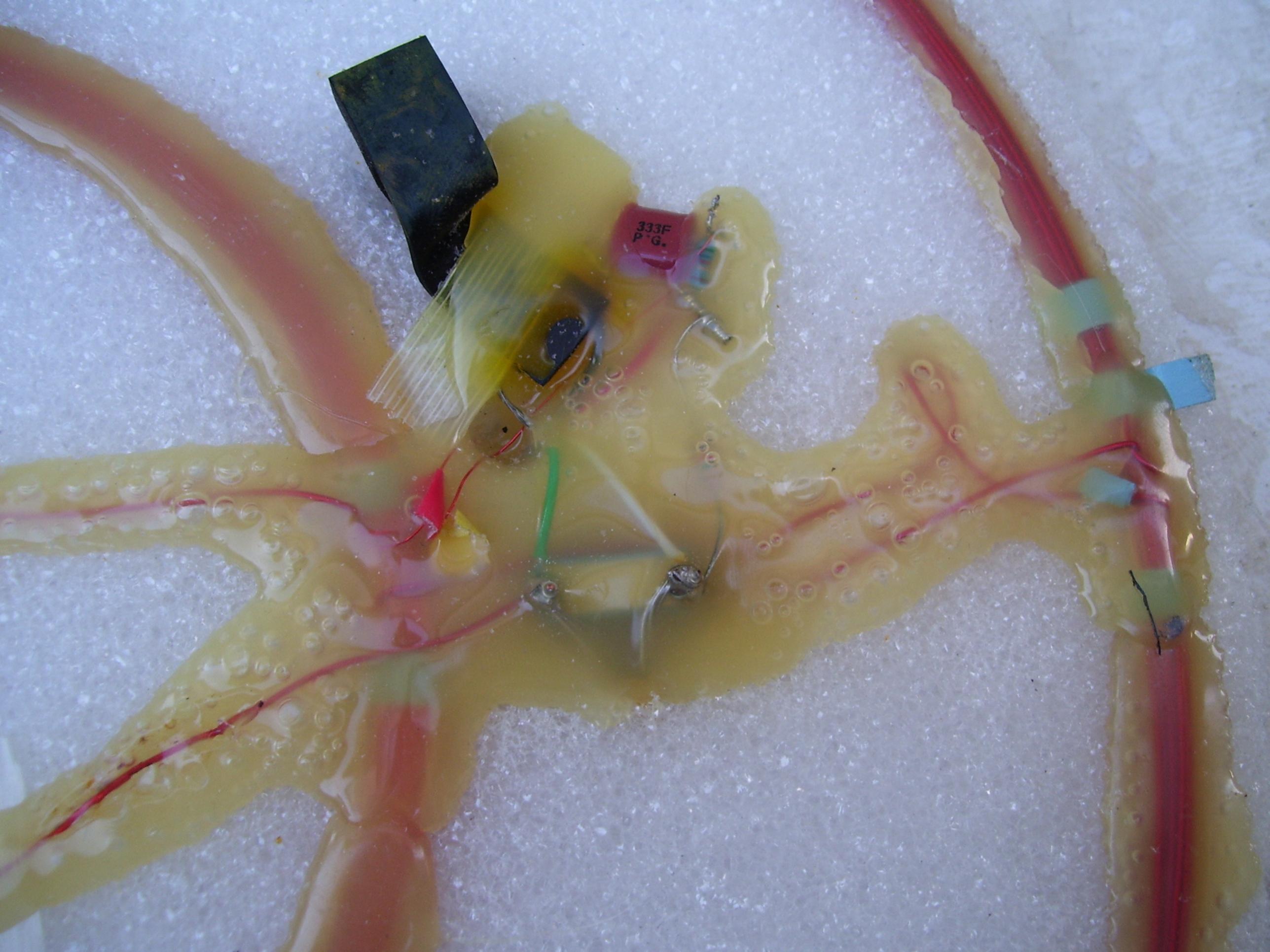

    what type coils you see in this video? STANDART 6.59Khz. NOT 6B COIL. so your point is a fantazy.

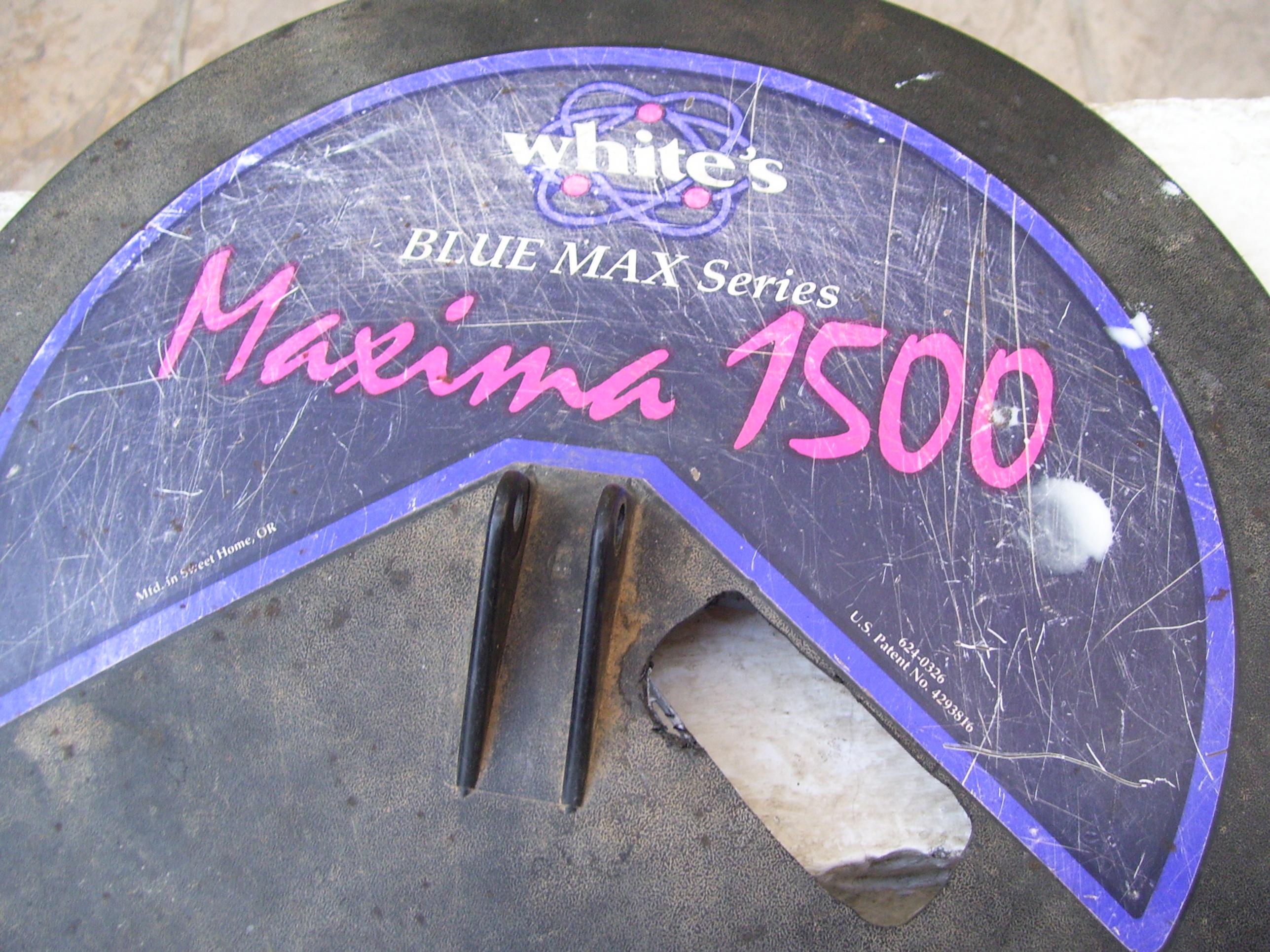

    • 15 maxima blue coil. on RX part we see 33nF cap.

        A few points here.
        Firstly, the patent US4293816 describes the physical construction of the concentric coplanar coil design, along with the theory of balancing, due to the buck(feedback) coil arrangement. It does not mention signal phase because that was not the intention of the patent. It's intention was to demonstrate the balancing of a coil so constructed, with minimum residual voltage, by means of a feedback coil.
        Secondly, it is mentioned in the patent that the operating frequency of the oscillator is 5.125kHz, and thus the Tx coil is tuned by means of a parallel capacitor for resonance of 5.125kHz of the oscillating Tx circuit.
        Thirdly, the Rx coil in the patent, based on Qiaozhi's coil calculator (Brooke's equation), has an inductance of around 11.8mH.
        If you tune this Rx coil with the 27nF cap stipulated in the patent, you get a Rx coil resonance of 8.9Khz. Right away you see there is "off resonance between the Tx and Rx coils " when coils are balanced. THIS WILL RESULT IN A PHASE SHIFT of the Rx voltage with respect to the Tx. So a phase shift, although not expressly stated, is implied.
        Lastly, I believe there are only two conditions which result in zero phase shift, these are 1: when Rx is non-resonant, and 2: when Rx and Tx are at equal or "full" resonance.

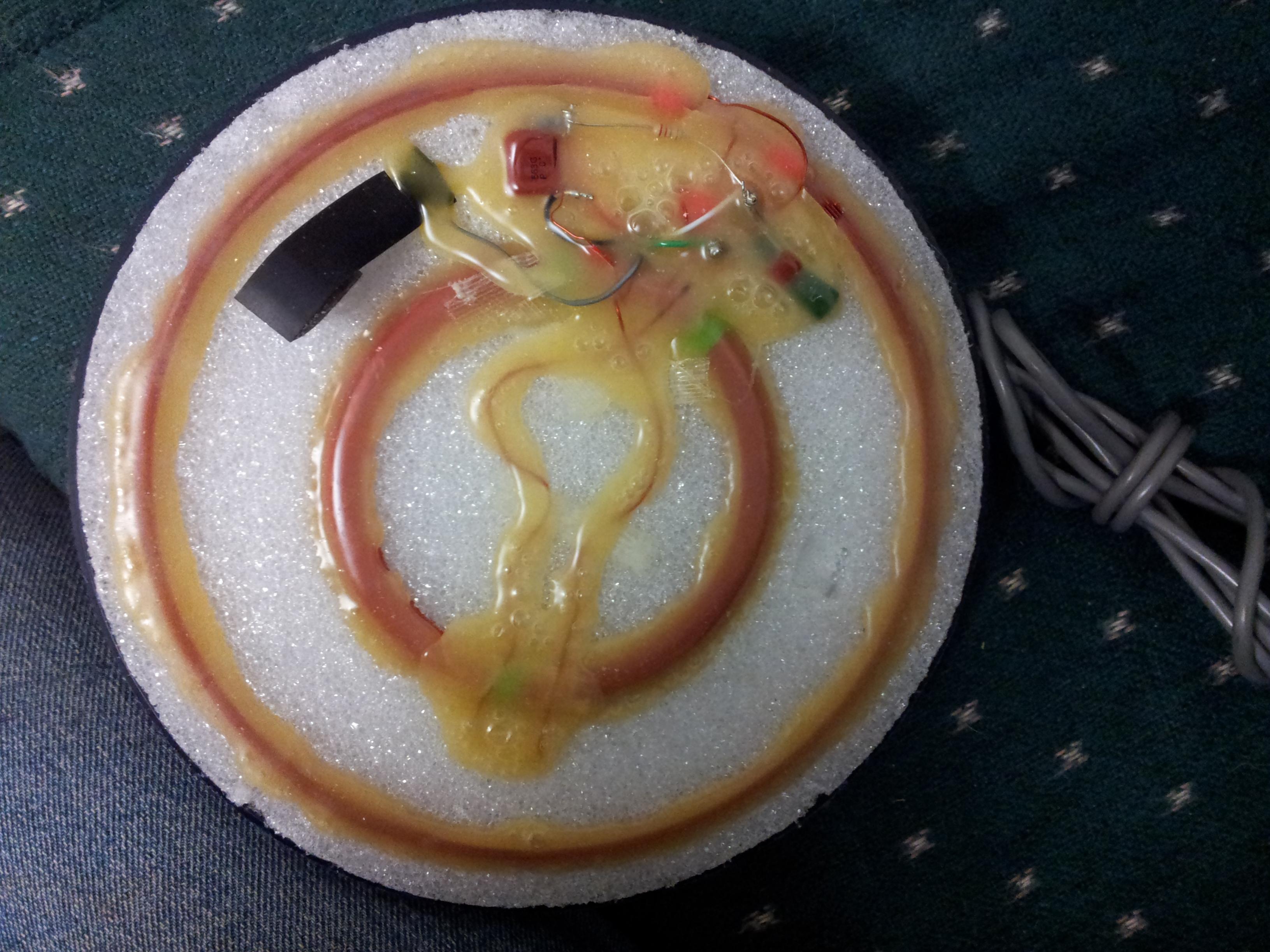

                        now another coil. 8inch blue max. on RX part we see 56nF cap.

                        • She does not balance the coil.....
                          The coils are very close to balance simply by knowing number of turns, wire size feedback turns etc,etc, in the manufacturing process.
                          They make their coils to very precise quality control standards, so that in the end, the inductive balance is there merely through controlling the coil making process. The trimmers take care of the rest. That's my assumption.
