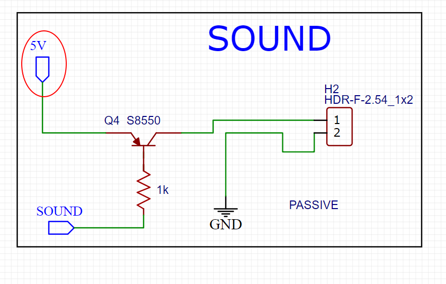

  • Friends, If you have some troubles with volume, connect your Q4 emmiter to 5V Instead battery

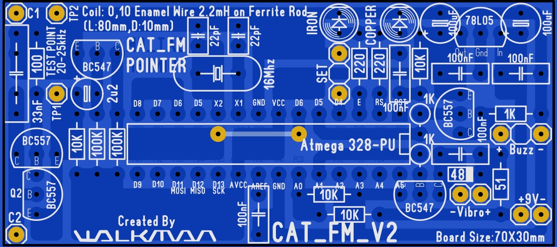

      @Void118 and @Walkman,,,,Thanks for the great project! I made your 1st original pcb and it works great! Thanks Walkman for your layout,,it works great too! Really pleased with both of them!
      @Walkman,,,Would it be possible for you to make an SMD Version with Vibro motor instead of LED's please? Sorry if I'm asking too much. Thanks and regards, Marty.
      Hi MartyJ1963,
      I did not draw SMD, but if you want the dip V2 version, it is in the message.
      Good works.
      • Hi, guys, I'm working on new schematic with separate power supply and SMD layout. I think next week I will show new firmware. Now I tried to connect vibro and It works great!, I just need to add few functions to Cat-FM menu.
        • @Walkman,,,Thanks for the layout. I like the Vibro addition! I will build and test,,,Thanks again. @Void118,,,Looking forward to seeing the new SMD Layout! Thanks again for the project! Regards, Marty.
          • Walkman,
            What is the reason why Turkish specialists prefer to offer their developments with PDF files, instead of with the popular programs for drawing circuits and boards. In my opinion, working with a PDF file does not provide any options for editing the board under its own case.
