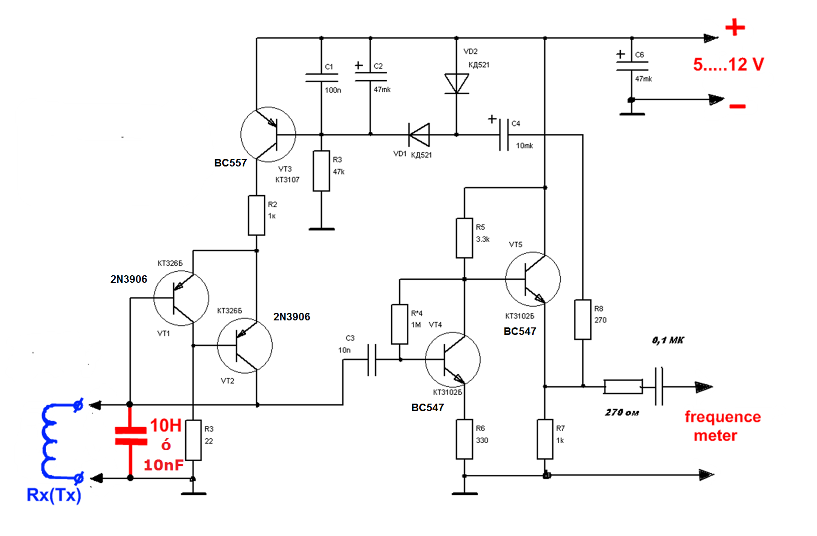

        I want to use the FOMA data:
        RX: 51 Ohm. with a 10nF capacitor parallel to the winding = 14.65 Khz.
        TX: 11.9 Ohm. with a 42nF capacitor parallel to the winding = 17.88 Khz.
        Is this information correct?
          Hope it has good results. looks like a good project

                      Hi friends I made the coils and ran them with the coil generator with this data:
                      TX = 17.83Khz + 40.9nF (+ 10nF in generator)
                      RX = 14.62Khz + 10nF in generator.
                      Other data obtained from the coils:
                      TX = 51 turns, 0.255 mm. (30AWG), diameter 207mm., 51.1 Ohm., 1.588mH.
                      RX = 145 turns, 0.202 mm. (32AWG), diameter 207mm. , 11.03 Ohm., 11.615mH.
                        I put a 52nF capacitor in TX to tune to 17500Hz.
                        For RX a 6.48nF capacitor at 18100Hz.

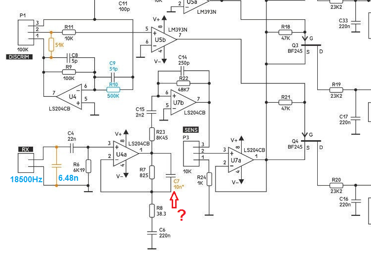

                              Friends, I don't know which capacitor should go on C7.
                              In some schemes they say that it should go 10pF in others 3.3nF-10nF.
                              What will be the right thing to do?

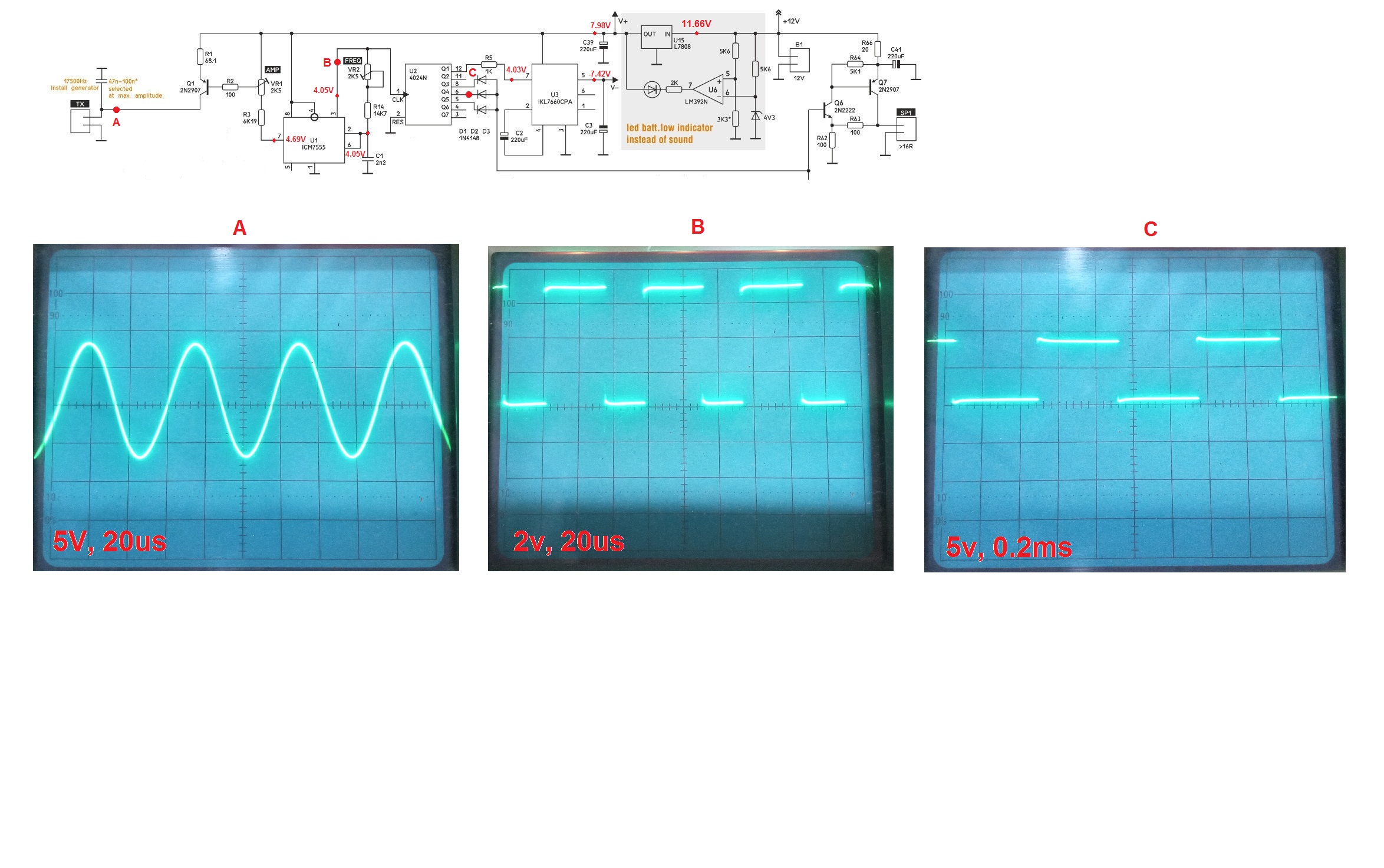

                                I can't get GB to work.
                                Any advice would be helpful !!!!
