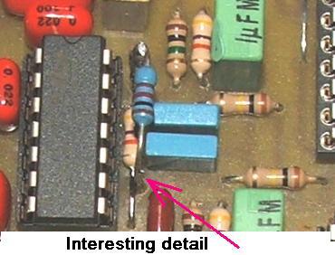

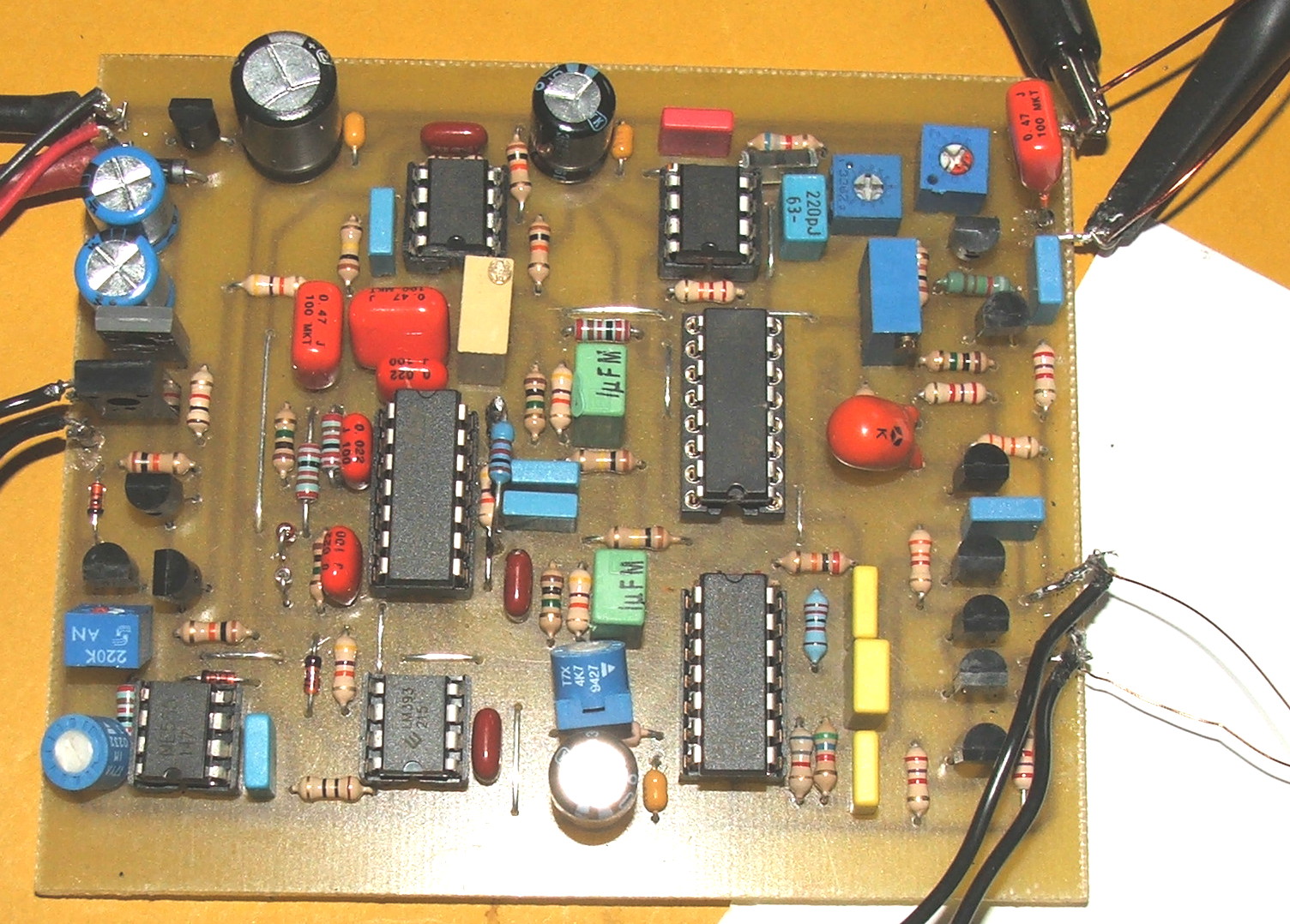

      • Hello Friends,
        Together with friend Nakky we made Caesars most wanted. It is as Ivica say's a sensitive detector, think it wil do a good job on ‘heavy ground’ ,but the disc is not as good as the teso's. The audio part... I love it; it is the version with the 555.
        If you use a piezo (with trafo) you can adjust the right freq. and volume ,....
        The neighbours love me for that sound…..

          Splendid job!
          "..the disc is not as good as the teso's.."
          I agree! No DIY that can beat Tesoro's Disc! Also agree.
          Now you make second version with 1265/66 audio and you will be even more satisfied!
          Regards!
          P.S.
          I see that you put my favorite type of caps there! Right!

            Hi Appie, hi Nakky. Nice work!
            Esteban
