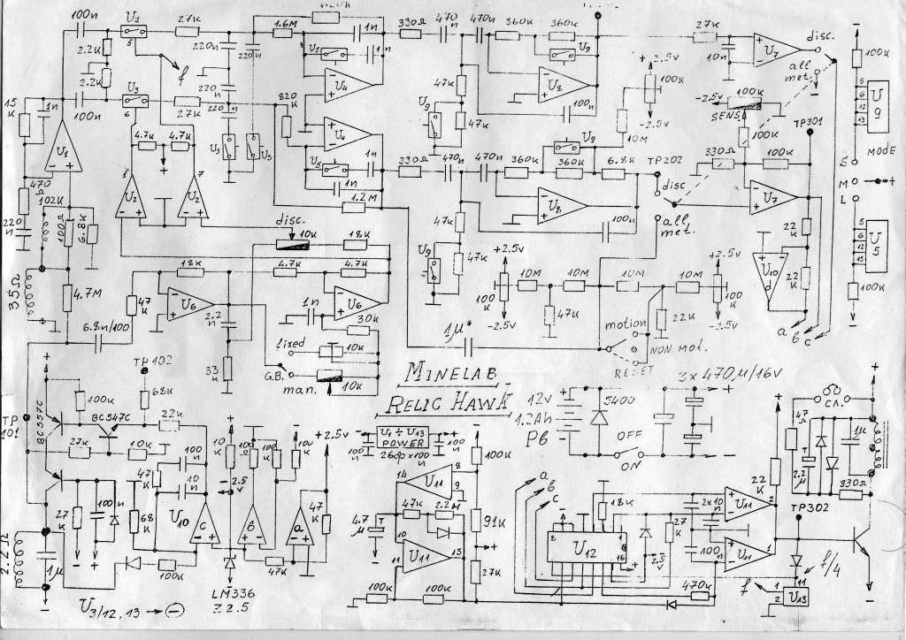

    • #47
      Max can you tell me whic IC which is?Please!
      On this last schematic.

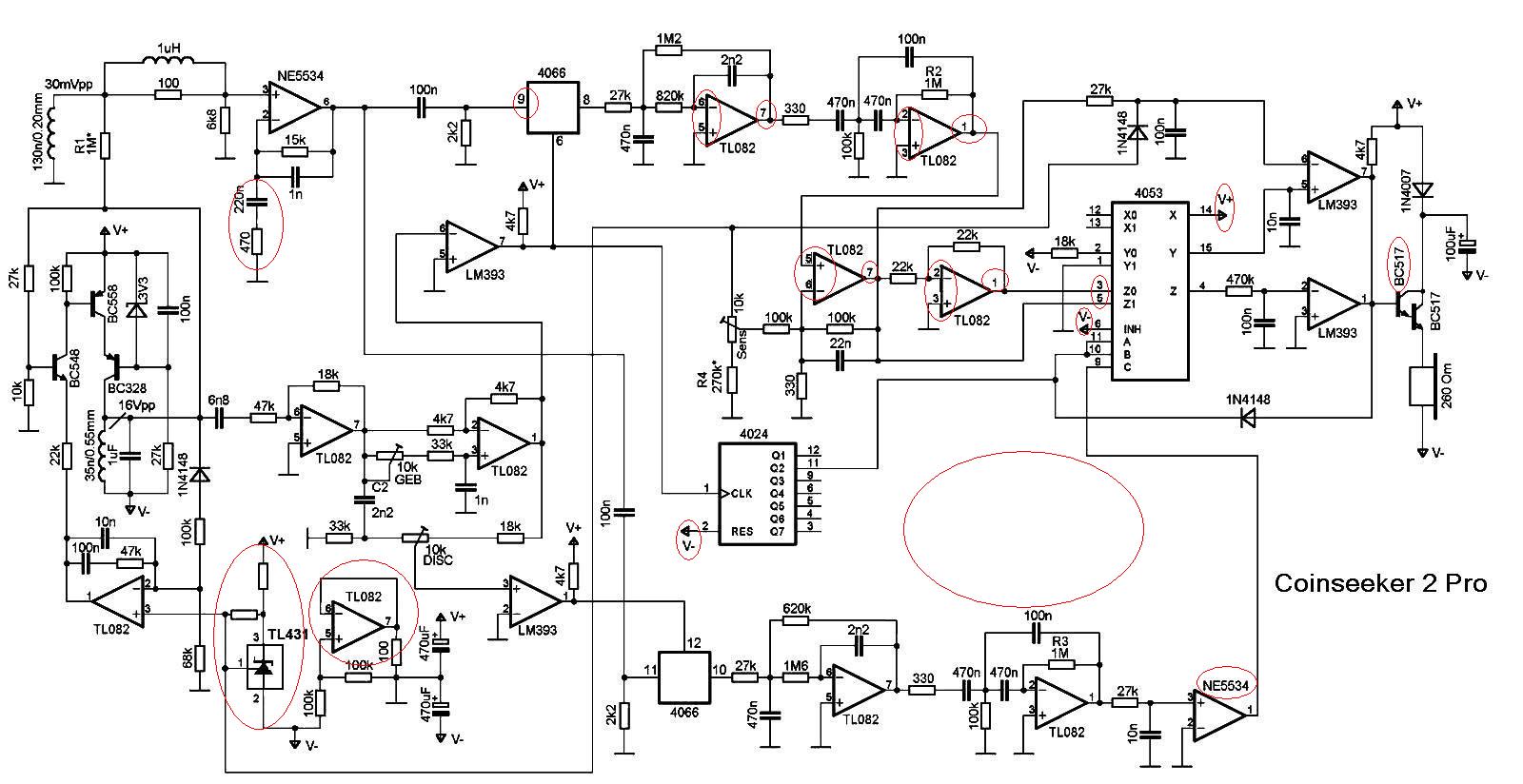

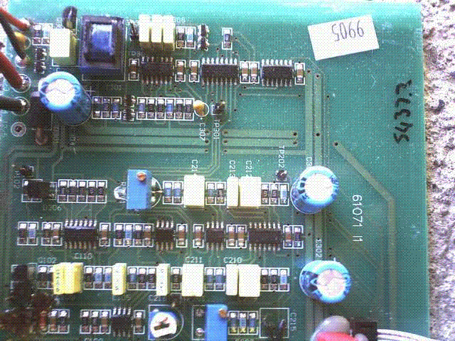

                  Here is corrected schematic of Coinseeker2Pro. I traced PCB in your "post#27" & used schematic in "Amtech2005 post#16" in this thread as basis. It is 99% correct. Please check! Can you check component values? Do you have values for the 2 resistors connected to pin 3 of TL431?
                  • #54

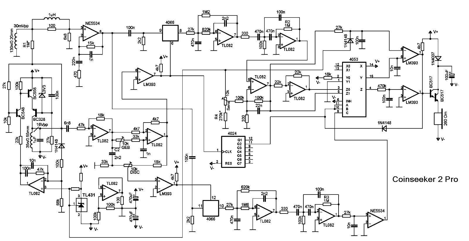

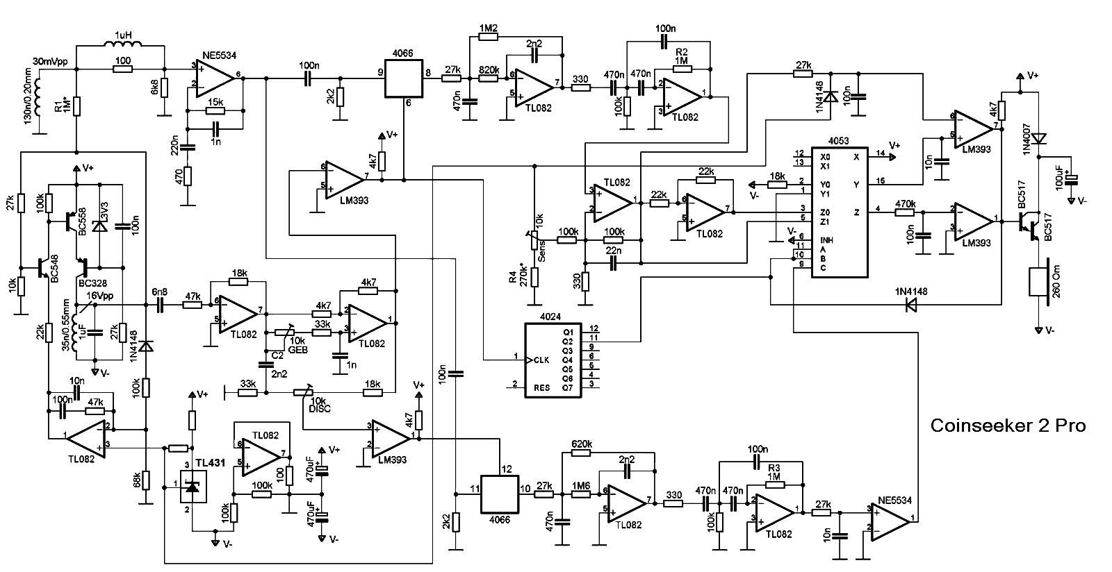

                    I make mistake in schematic.
                    New schematic & changes shown.
                    • #55
                      RELIC HAWK
                      HELLO, ON THE BOTTOM LEFT NEAR THE TL431, 2 RESISTOR VALUES ARE MISSING . DO NOT FORGET THAT A NEW CORRECT SCHEMATIC HAS BEEN POSTED AND IT IS COMPLETE. JUST NEED THE IC'S MARKED U-1 TO U-12 ETC............. THE NEW SCHEMATIC SHOULD CORRECT ALL PREVIOUS ERRORS. WE ARE ALL ON THE RIGHT TRACK THOUGH, EVERYBODY CONTRIBUTES HERE . THAT MAKES THIS FORUM SO GREAT!!!!!!! THANKS ,EUGENE

                        NEW SCHEMATIC HAS ERROR -
                        NE5534 in bottom right corner:
                        Output of op-amp is pin 6 on PCB not pin 1 as shown on schematic.
                        4053 - inputs for Z0 & Z1:
                        Pin 1 of TL082 connected to pin 3 of 4053. CORRECT
                        Pin 7 of TL082 connected to pin 5 of 4053. CORRECT
                        In that case for pin 3 & 5 = Z0 & Z1 mislabelled on IC or schematic needs redrawing to have pin 5 = Z0 & pin 3 = Z1. CONNECTIONS TO IC PIN NUMBERS ARE CORRECT.
                        Lots of pictures of Coinseeker 2 Pro PCB with & without components at:
                        http://www.snimka.bg/album.php?album_id=113396 http://www.flickr.com/photos/2057000...7603136862931/

                          Eugene wrote -
                          "ON THE BOTTOM LEFT NEAR THE TL431, 2 RESISTOR VALUES ARE MISSING."
                          When LM338 is substituted for TL431:
                          resistor from TL431 pin 3 to V+ is 10k
                          resistor from TL431 pin 3 to TL082 is 100k
                          I have no idea what values to use with a TL431.
                          DO NOT FORGET: This Coinseeker2Pro schematic is Bulgarian cutdown version of Relic Hawk.

                              THIS IS THE SCHEMATIC THAT I WILL BUILD FROM!!! I AM NOT GOING TO BUILD COINSEEKER-2 PRO BECAUSE TO MANY THINGS ARE MISSING !!! PEOPLE ARE COMPLAINING IT IS NOT GOOD COMPARED TO RELIC HAWK!!IT WOULD BE A BIG WASTE OF MY TIME . MAYBE THE COIN SEEKER 2-PRO WORKS GOOD IN EUROPEAN SOIL ,IT WILL NOT HELP ME OVER HERE . I NEED POWERFULL DEPTH WITH DISCRIMINATION. THE OLD SITES I GO TO, "THEY SAY ARE HUNTED OUT" OR "CLEANED OUT". BUT I KNOW THEY ARE NOT!! .................Eugene
                              • #60
                                RELIC HAWK
                                DOES ANYONE KNOW THE EXACT PART NUMBER OR ANY RESISTIVE MEASUREMENTS ON THE BLUE TRANSFORMER SHOWN . SCHEMATIC SHOWS A CENTER TAP. AND I ALSO DO NOT SEE A SECONDARY WINDING ON THE SCHEMATIC???SO IS THE PRIMARY WINDING USED AS A CHOKE OR LC FILTER ???? THANKS...................... EUGENE
