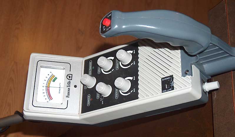

    I have Famous and Trails metal detctor, like the one show below.
    Today i opend it and i tried to perform some mods has is show on a Russian forum.
    The translation wasn´t perfect and here i m posting what i got:
    That has made at once after forum studying: 1. - In the transmitter has reduced R8 about 4.7 clod to 2.7 clod. The amplitude of a signal on the coil has increased about 4 volt to 11 volt, it is possible and more but the sinusoid form is strongly deformed. 2. - In the receiver has taken a bite absolutely the resistor parallel to the coil - R7, 220 ohm. 3. - included consistently with regulator SENSITIVITY face value nearby 22 clod has replaced the resistor with 470 clod. 4. - has disassembled the coil (And it has been stuck together very qualitatively!) The hair dryer has warmed up thermoglue which the reception coil is fixed and moving it has tried to balance. To supervise a signal on condenser S10, in my case разбаланс has reduced about 4 volt to 0.3 volt. It is possible to reduce in "0", but it is necessary to clean old glue and to fix the coil anew
    From this what i understood is the following:
    1.- To replace R8, 4.7K with 2.7K. This was the easy part, no problem.
    2.- I can´t find R7. Im also not shure if i have to replace the R7 value or i should place a 220 ohms btw the RX leads of the coil.
    3.- Has i understood, i had to replace resistor of 22K with 470K. This resistor is very close to sensitivity pot. I also had done this.
    4.- Finally i read something about the coil, but i m not very shure what to do here.
    The test with this two mods, show very poor sensitivity and also i had to keep push the auto tune switch to enable the meter to go to the center.
    I know this two mods are ok, but i had missed poninst 2 and 4 of the presents post.
    So, i request from you people that speaks Russian, if you can help to translate the instructions to perform the full mod of the detector show below. Here is the text from the Russian web site:

    Sorry for my english and i hope you can understand me.
    Nelson

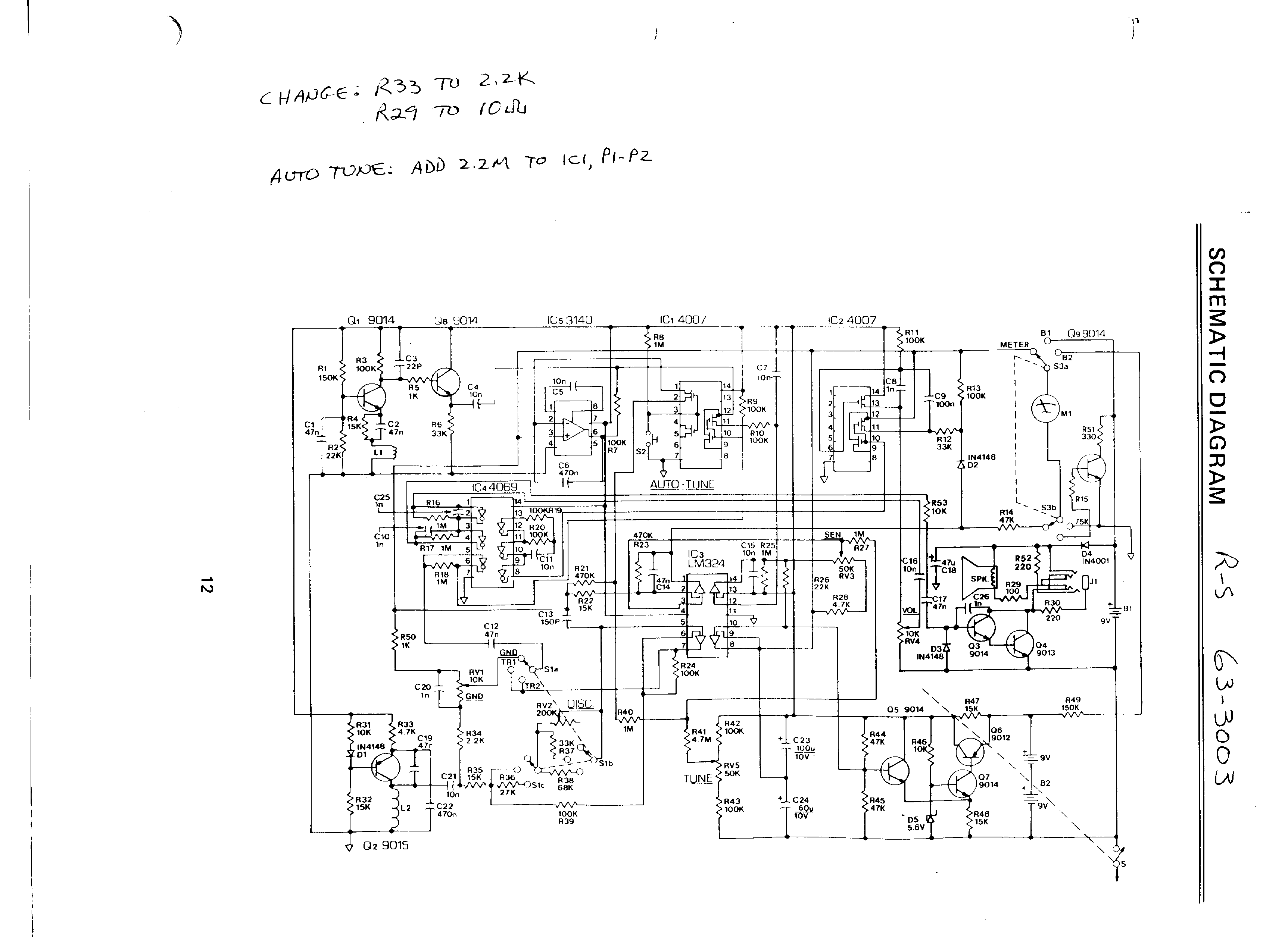

    Nelson, The modification for this 63-3006ss should be identical to the 63-3005 modification posted a few months ago. Kt315 will translate the russian page when he reads your post above, if not I will post some of the information later...These are the 4 "Cheapest" Micronta VLF'S from Radio Shack that I know of. And now a bunch are being "Made in China" for Harbor Freight , Vellemans, and the Famous Trails in the last photo which is identical to Estebans also !!!...........Eugene
      Eugene51
      Nelson , Your English is not bad . Your Russian is Perfect !!! You made a "Big Post" here , bigger than any of my posts ever !!! The first thing you should do is try a 8 inch or 10 inch open face "Bounty Hunter" Search coil , Just make sure the 4 or 5 connector pins are the same , check your tx and rx continuity so they are not crossed . The 7 or 7.25 inch is Bounty Hunters Cheapest Coil , I would not mess with it !!!!!!!!!! Test with a 8 or 10 inch then work on your Transmit circuit Modifications. The famous trail detectors are more expensive than Bounty Hunter !!!! I guess they have to be copied over in China and then shipped back over here again !!!! Please look for the "VLF-SHADOW" detector schematic I posted and compare the Schematics , use the shadows TX circuit , or the russian mods . It sounds like your tx transistor is being overdriven , or you have drifted off frequency , check if that detector is 13 or 15 khz ????..I cant remember ???..............Your Detector will work very Good after the Modifications are correct..................Take Care..................Bye............Eugene
        Спасиба для схема
          Hi Eugene and thanks for your help.
          Yes, people who know this detector, said that has a good hiden potencial after a few mods.
          I ll follow your advices to see if i can make this MD work has a champ.
          Russian id hard for me to translate, so i just tryied online translators, but this is not has good has a native speaker translation.
          I wich some of the good friends here can traslate my previus post to english.
          Take care
          Nelson
          Santiagp-CHILE, SA.

            Hello Nelson , I think your detector is very similar to the schematic of the "Shadow project" I posted here ...I think It is one of the best vlf detector projects Carl has posted over on the Thunting site . For 1980 , this was ahead of its Time . The shadow article says it detected a single coin to 12 inches maybe??? Anyway check out the very close 'similarities" and best of luck............Eugene51
              yes it was interesting. Coil data are not available from the article but I think really it was capable of 12'' in air detection over a coin like an half-crown (32mm).
              It was also about simple respect to others but sure with good disc features.
              I think it's limitation was about the 4 batteries required... not that good , and of course, weight issues and complexity during use.

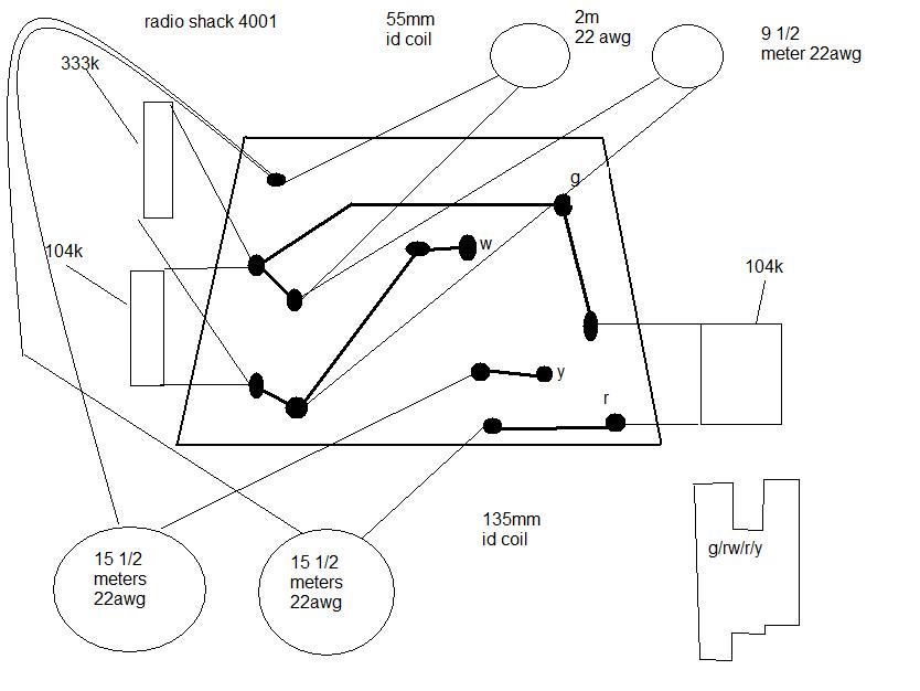

                  hello all ,
                  just been reading this thread regarding varius micronta detectors ,
                  has anyone got the schematic for the 4001 model ??
                  i have the 4001 model , and would like to study schematic and try to make it better so it's more useable ,
                  the coil is also a little confusing if anyone has some info on it , looks like standard arangement with bucking coil , but when testing , it would appear that the RX is connected to the TX , about 8 ohms or there abouts , confusing.
                  have tried to give her more power by changing the TX transistor to a higher gain higher power type , but with no real success , still only 4 inches on a 20mm nickle or copper coin.
                  any info greatfully recieved , i use a home built PI and "the boy" uses the 4001 , we also use it for pinpointing and FE indication , but due to the lack of depth he is getting bored with the hobby , it's like fishing , catch a fish , hooked for life , so would like to improve on the destign if possible.
                  thank you in advance for any info.

                            hi nelson, did y finish MD-3006ss mod. how it works? I found lots of coins and sam silver on beach, so is it worth to modified it?
                            • #44
Name:	coil drawing.jpg
ID:	333467 i had the 4001 years ago i found an old coil drawing i made, this is it if it helps anyone out. you have to put the 2 small and 2 big coils on top of each other.
                              adam
