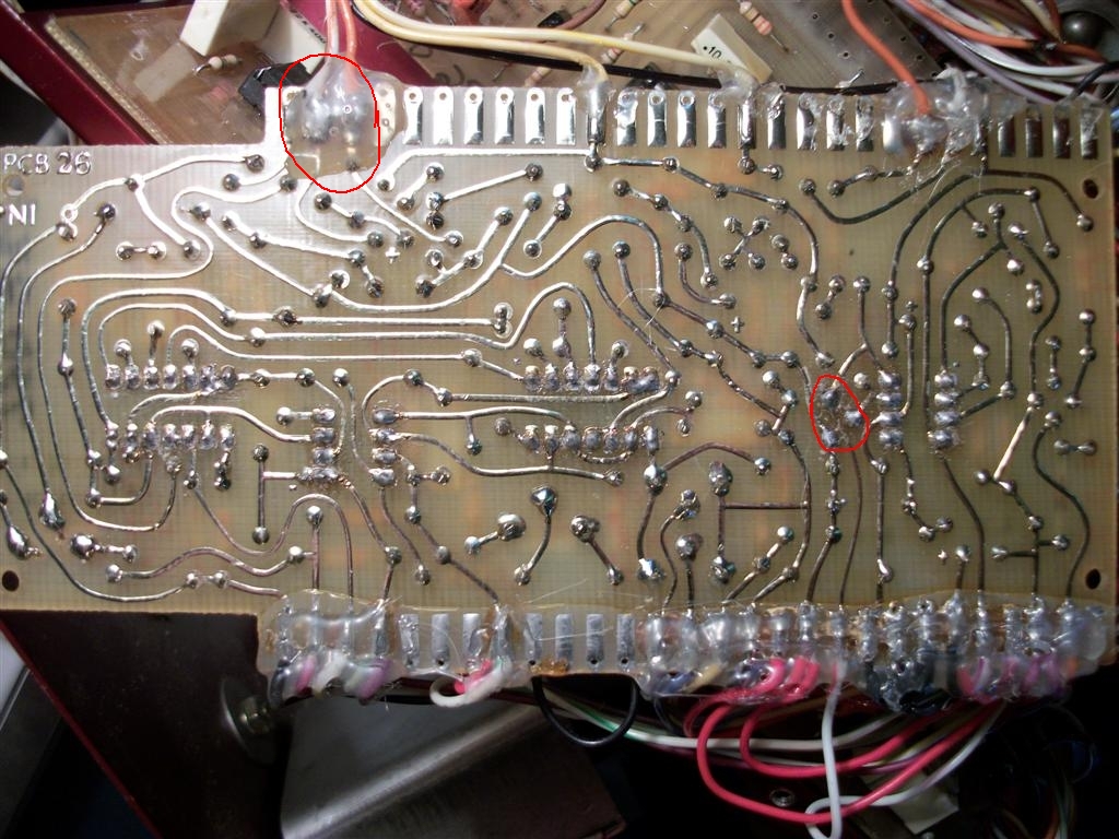

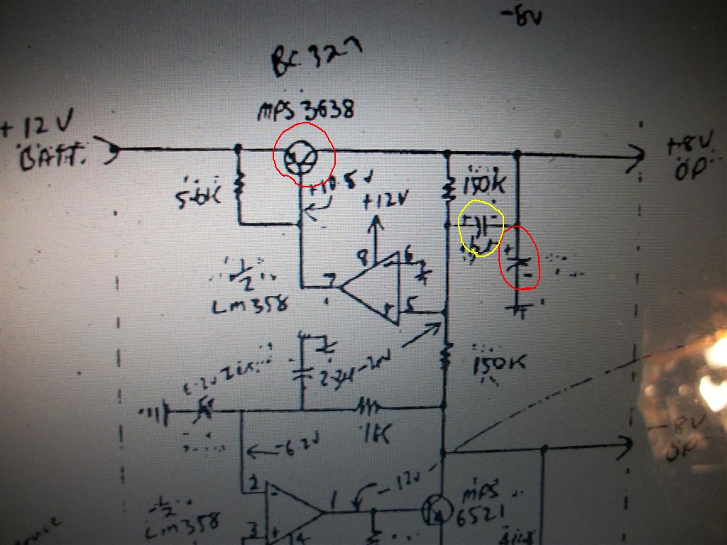

            Thanks Conan for getting back to me- really appreciated. On the point where where the + is on the circuit I have a positive red and an negative black hooked up from the battery pack. Might be hard to see from the picture of the top of the board but easier from the my picture of the bottom. Seems to be connected just like your single board (with the leads from one black and red connected) and seems to be like the one the other person posted (except their black wire is almost hidden behind the red in the pic). To be honest I don't ever recall messing with the power wires (and neither has anyone else- probably the first person to open it). Volume DPST/ pot is hooked up just like the pictures you refered to.
            Having said that some of the tantalums in the circuit seem to have a dead short- will remove them and test outside. from what I read if tantalums ever go bad its usually they short. About 4 appear to be. At least 2 on that board. All 10v 33.
            Don't know if this ever had anything to do with it but they say on my Nautilus (at least with the 15in coil) don't leave the coil plugged in during a lightning storm or else the detector can be damaged. Could that have caused it. Only other thing is maybe someone put some 9vs in and fried the tantalums, etc? They can't handle reverse polarity well or maybe they died from age. Before we took it apart my father said he took it out from storage and tried it some years ago and it smoked some back then as well- if he remembers correctly. Thanks.
            On another note that metal can (I believe IC- has 5 leads and the circuit is drilled out for a standard LM 358N socket) a tantalum cap seems shorted. The suspected Ic is labeled CA3140s RCA 019 (made by RCA?). A tantalum nearby seems shorted so if I can find a replacement rather than testing (as I don't have anything to test an IC) it would probably be best. Have all the other ICs and did the IC sockets you suggested- great idea by the way.

              After looking at it more Conan I could swear its connected how you first said it should be hooked up (with a pos and neg wire connecting in common on the board in the same place and the other 2 going to the pot/ volume). It is clearer in the picture of the bottom of the board. I think Dr Vel is correct. The Tantalums are probably shorted out (pretty common when not derated and sometimes just happens). Maybe they didn't realize they should be derated back then? The schematic says there is around 8v on that leg and the Tant cap is 10V. According to the current manufacturers specs of tantalums they should be de rated to around 16V in this instance. So I should be replacing them with 16V 33uf tants (or 10V electrolytics as yours seems to have and some of Mark's are). Think that is my problem. If you look at the picture of the schematic I attached you will see the poor MS3638A which is forced to act like a fuse when the nearby tant is shorted (I believe its the one circled in red). If the tant is shorted then one leg of the Transistor is receiving 12+ and the other around -12. No wonder it keeps burning out. Center leg (B) doesn't seem to get quite as hot as it still has silicone on it after burned- other two (C and E) didn't on one. Makes sense. When I take the ohm meter to the tant on the board its a dead short and it says that leg (connected to the tant cap) of the MPS3638A Trans is dead shorted to the ground as well. I think that is my problem. There are about 4 bad Tants inside my RB7 out of 10 (and all of the 4 out of 10 are the 10V). Sounds like they should either be replaced with electrolytics (like most of yours seem to be and some of Mark's) or replaced with derated Tants (in this case 16V). I will not be taking them out of the boards till the new Tants arrive so as to not make a mistake mixing up polarities- pretty sure its the problem though. Will let everyone know when they are replaced if that was it (should take a week or so to get new ones). Open to suggestions and advice though.
              ANOTHER ISSUE. One of the 4 shorted Tants is bridging the metal can IC CA3140S. I don't have a tester so it would be easier/ cheaper to just replace it. 8 pin holes are in the board so at least that is easy. Problem is I can't find one. According to Mouser NTE7144 might be a possible replacement for a CA3140 but nothing on a CA3140s (unfortunately a 2 week delay time and $7 to ship anyways). There are some different varities of according to Digikey. Here is the link:http://search.digikey.com/scripts/Dk...eywords=CA3140 Not sure if any of those are compatible though- codes are all different at the end. Anyone have any ideas? I'd rather order it as the same time as the caps to save on time and shipping. Thanks
              So close and so far at the same time. Oh well.

                  Thanks Porkluver. Everything came here today from Digikey so I started replacing the caps, etc. Seems like only one was bad. It was the 10V one next to the MPS3638A transistor as suspected previously. Replaced all of the 10V and 16V with ones that were derated properly (since it happened once and don't want it to occur again). Looks like eveything is almost ready to fire her up again after all those years.
                  One final dilemma- 2 of the wires going to the coil were broken when I first took it apart and I can't remember which spot they go to. Not sure if they are mixed up. Mark's picture of them is how I have them now but the RB7schematic someone was kind enough to post says they go the opposite way. Does anyone know where they go for certain? Don't want to fry anything else now that I have got this far. I attached a pic. Its the orange and white (with orange stripe) and they are circled in red on the picture. Any help will be greatly appreciated. Thanks.
                  Once I get her fired up I'll let everyone know if it went well or if she melted down again. With all the info on this thread it should be possible for people to save more of these detectors.
                  • #69
                    Well. The SPD/ Disc works now (beeps when a penny is waved past the coil) but no all metal or threshhold..... Impossible to Ground Balance as of right now. Any Ideas anyone? At least the MPS3638a transistor isn't burning up anymore- it was the Tantulum cap that was shorted out near it. Weird thing is one battery pack registers on the gauge when the switch is flipped but not the other though it still will not work when either one is unplugged at all. At least no more smoke for now but does anyone have any other ideas? When I check a few spots on the meter board with the multimeter (and the battery packs unplugged) there is a slight humming sound when I touch a few points- must be the multimeter supplying a little power to the circuit. power. So close and yet so far.
                    All the 10v caps have been replaced as well as the 16v electrolytics, all the ICs, two MPS3638a (one on the meter board) and an MPSA13. Also made sure the DPST 500 ohm pot is working correctly (on/ off volume switch). Only transistors not replaced yet are the MPS653 and the MPS6521. The MPS 6523 are on their way but does anyone know of a substitute for the MPS651? Mouser and Digikey don't have them- obsolete. Any help on this is greatly appreciated. All diodes have been checked and one of the zeners was replaced. I know there is a special way to test them but this one read the same both ways out of the circuit- probably fried as it shouldn't do that (the other one didn't). Thanks again.
