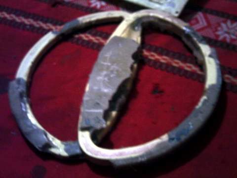

              If you have a faulty Arado, it is ALWAYS the coils. They sucked!
              try tuning to mid range then slide a copper washer (around 3/4 dia.) around the TOP of the SH ...SLOWLY at one point the detector will tune. if not try a STEEL one and do the same. the heads go out of balance due to the foam in them, it shrinks with age and the coils move.
              Should be easy to make a new on, if you do I'll buy one off you I have a duff Arado and don't have time to fix it.
              Depth is GOOD on low mineralisation soil, but rubbish on anything else. Not as good as say a TGS though.

                    "....the heads go out of balance due to the foam in them, it shrinks with age and the coils move...."
                    I had coil fixed in joint filler and than in foam. Looks like it is impossible to move, yet it moved in time!? So you are right about that.
                    I tried to fix it up in the past and destroyed it completelly!
                    It would not be a problem to make another for those with good will to do that.
