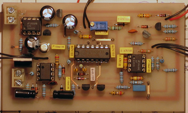

    HI
    Thank you Geo and Michael.
    Michael: I verified the 7xL05 pinouts and as I see from here both are installed right (no mistake). Please download both datasheets!!
    79l05 (gnd-in-out)
    78l05(out-gnd-in)
    To your list I would add:
    C1 is missing but this can be easily installed off-board.
    Have put 1M resistor and C8 on solder side..
    Can not understand that power supply:confused: ...
    ICL7660 Vout is at -11.7V
    79L05 Vout (Vss) is at -2.5V ... Why use two negative converters in row???
    78L05 Vout (Vdd) is regular +5V.... Should not be Vdd and Vss opposite (-5/+5V)??
    NE5534 pin6 is at 4.5V and no pot no matter how much I turn it makes no difference... also constant 337hz from speaker - same as coil.
    Almost forgot Geo:
    Oscilator is working! at 337Hz completly stable. It's driving coil (measured with DMM) with 6.6V at 0.43A So at least this is working..
    I have replaced 2N transistors with appropriate BFs.. Maybe I should use originals??
    So this is sadly it ... Opened to any ideas .... Can someone figure out that power supp.
    Is this working circuit at all??? :confused:
      Your 7660 sounds like it is working correctly if you have -11.7v out of it. That means the problem has to be with the 79l05 regulator. First, I would recheck and make sure it is wired correctly. If it is, then look again at the part number and verify that it is a 79l05 soldered in there. If it is, then I would unsolder the output leg of the regulator and pull it up out of the board. Measure the voltage on it. If it is still -2.5V, then replace it. If it is now reading -5V, then you have a problem elsewhere loading the output of the regulator. These 79L series regulators can only source 100ma so it wouldn't take much of a problem somewhere else to load it down and read low. That is most likely going to be your problem.
      Good luck,
      Boattow
        I just looked at the datasheet, the power supply schematic, the PCB layout, and your picture of your PCB. The negative supply circuit looks correct. I would double check to make sure the part is a 79l05 installed on the PCB and if so, pull the output leg out of the board so it is contacting nothing and measure the output. It will most likely read properly indicating that the power supply is working ok but your PCB had a problem elsewhere.
        Good luck,
        Boattow
          79L05
          Thank you boattow for your time..
          I folowed your advice and guess what - bad 79L05, I replaced it and voltages now are +5/-5.
          But detector is still not working.
          I compared datasheets for original transistors and used BFs. There are some big differences - will order original 2N transistors (fet's) and try it...
          ..or maybe the hammer will finish the job.
            Hi Leto.
            1. First put R27 and R29 at a middle position. Then with the coil connecting and far from metallic objects regulate R28. Now how to regulate R28?? Connect a voltmeter (multimeter) at the output of NE5534 and regulate R28 so the voltmeter to read a voltage between 0.1....1V (0.5V is better). Now if you put an object near to coil you must see the reading of voltmeter to differ. If is ok go to next step. If not look around the NE5534.
            2. Put the voltmeter at pin 2 of U4a. Now if you put an object near to coil you must see the reading of voltmeter to differ a little. Make the same with pin 3. Make the same with pin1. Now if you put an object near to coil you must see the reading of voltmeter to differ very much.
            Because i suppose that the problem is between two first stages i stop here. Try it. We wait your news
            Wishes
              Burnt IC No. 2
              Thanx Geo..
              As I could not trim output of NE5534 I replaced it with new one.
              Now I can trim voltage well to 0.5V.
              Also frequency of coil now (after 79L05 replacement) is 673Hz
              Frequency of pin10(U1) is 335Hz
              Frequency of pin12(U1) is trimable with R27/R29 from 340Hz to 1kHz+ here the freq is bit unstable.
              What should be appropiate frequency for the sample delay?
              I try them all but still no detection at pin6 of NE5534.:confused:
              Can not find any problems around this IC :confused: but maybe there is another damaged part there. I'm really not sure.
