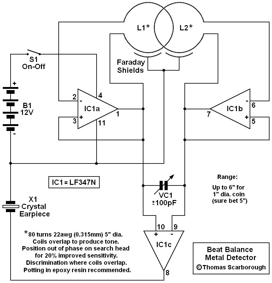

                        This is BB (old version) not CCO. BB(Beat Balance Metal Detector) at a critical position of the winding.CCO is not as critical position of the winding (but need a bit of effort for the best performance). Experiments to find the direction of winding rotations. CCO better detected by BB (the greater the distance detected coin).If an interested, on this picture is a newer version of BB metal detectors:
                          These circuits are basic regenerative receivers. There is an oscillator adjusted on the edge of starting to oscillate. When a metal target upsets the coil balance, the oscillations start. It is the huge gain derived by this setup that makes them so sensitive.

                            Here's another BB metal detector by the same author.There are more details for beginners.
                              This is the one I was searching for to show nabiul the coil construction.
