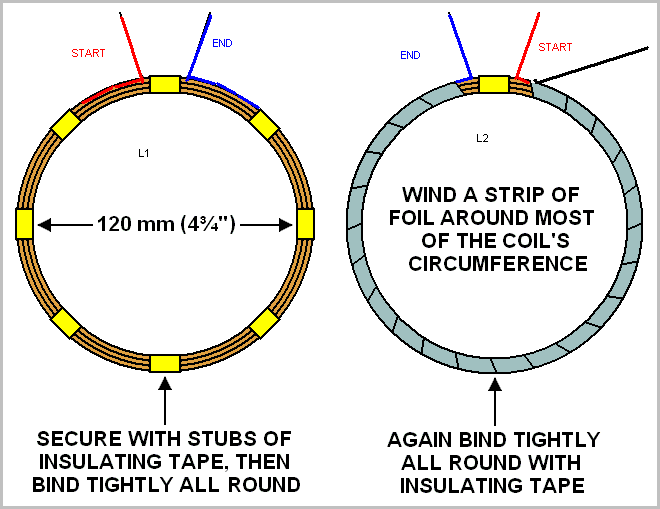

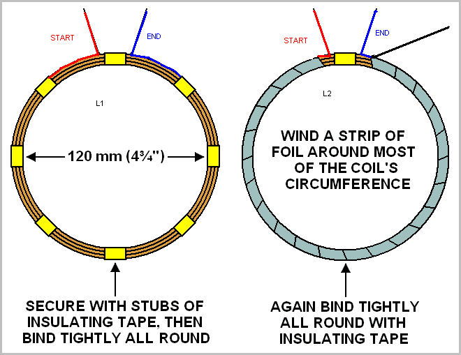

    I think the direction of winding as shown. Try a combination of both and will see the difference.When testing the detector in the vicinity should not be metal.Do you have Fédéré bed?

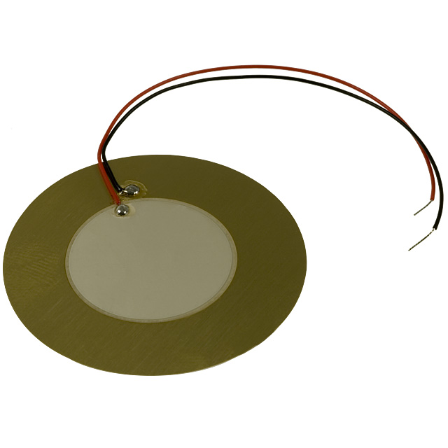

      A crystal earpiece is used for sound
      output. While a piezo sounder may be
      used (without integral electronics),
      this is not likely to offer good volume.
      If the volume in the earpiece is too
      high, use a suitable series resistor to
      reduce it. An inductive sounder orearpiece is not recommended, because
      it could overload IC2.18 ohm and 24 ohm impedance is much low.Try it with piezo as shown, impedance several thousand ohms (try different sizes of piezoelectric).

                The author says:
                "Both the characteristics of IC1 and the inductance of the coil influence oscillator frequency, which lies around 260kHzwithout a Faraday shield. The Faraday shield approximately doubles the inductance of the coil, thus roughly halving the frequency." => ~ 130 kHz
                "Wind the two search coils. They are 70 turns of 30SWG (0·315mm) enamelled copper wire on 120mm diameter formers."
                If I use
                0.21mm (35 swg)wire, how many turns do I need to make to achieve the same result ?
                • #83
                  Originally posted by TRX View Post
                  The author says:
                  If I use
                  70 turns of 0.315mm (120mm diameter) = inductance 1.522mH
                  67 turns of 0.210mm (120mm diameter) = inductance 1.528mH
