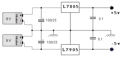

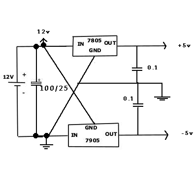

      Hi
      can i use this shematic for power supply (+5 and -5v), if yes, what is better?
      • #63
        hello, first scheme does not work. the second works but have batteries

                      Hi all
                      today when i used the second shematic for + , - 5V instead of 7660 power supply, finly it work fine and both ofset and dely work fine and can detect a 1inch brass coin at 15 cm, but it is short distance so any info to increase my detection depth is very helpful for me.
