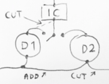

                    nalag46,
                    the 1266x has a 3 way switch: pull: pinpoint (static), no action: disc1 & push back: disc2
                    the schematic shows only 1 IC but the DISC input (poti) isn't exactly duplicated.
                    the simplest way for you is just leave that faulty switch as it is (ignoring not working
                    DISC2) and add an additional switch so you can select between poti1 and 2 directly.
                    the way you can see it on my little drawing above.
                    there's just one discrimination circuit on board and it works either via poti1 or poti2.
                    just take care that if the signal uses poti1 the second is switched off and vice versa
                    but most manual switches are constructed to work for such requirements anyway.

                      Hi Funfinder,
                      I have found the reason for my Disc 2 problem and now everything is working 100%.
                      I thank you for your advise etc. but I don't need now to bypass the switching IC and I am very relieved to have found the cause in the end (I always do, but sometimes it takes longer than other even when the matter can be so simple??)
                      Anyway, just so that everyone interested knows, I bought this detector in a sorry state of affairs (completely dead and badly damaged front panel pots, switches, phone socket, broken mode switch, knobs, everything, and not to mention the terrible condition of the connecting cables inside the box).
                      As I explained in my last one or two posts, my new mode switch was working fine selecting Disc 1 (center position) and Static (to one side of the 3 way switch) but would not select Disc 2 on the other side. The IC responsible for this selection is UC303 and looking at the diagram, Disc 2 Select should only be on (high) when pins 5/6 (Disc Select 1) are grounded by the switch, but it was coming on as well when in the Static mode (grounding of pin 13) so I replaced the IC but did not change anything.
                      When I reconnected all the loose and other wrongly soldered wires to all the new fitted components, I found I had all the wires except for the two that go to the switch (not counting the ground wire). I thought it to be stranged as no cable were missing from the main connector block, so I soldered to new wires to the switch from the underside of the IC (one to pin 13 and the other to 5/6) and after much checking and searching, I found that the two "missing" wires had been soldered to the battery charger socket right across the bulb (l501). As I had no need for using this socket and since the detector was functioning ok, I never paid any attention to that wiring and assumed to be ok even though there were 5 wires coming out of it, and there you have the reason for having a "high" pin 9/12 (Disc 2) on both sides of the switch.
                      And the moral of the story should be (yes, I keep hearing it all the time) never take anything for granted, specially after someone else had left their dirty prints everywhere.
