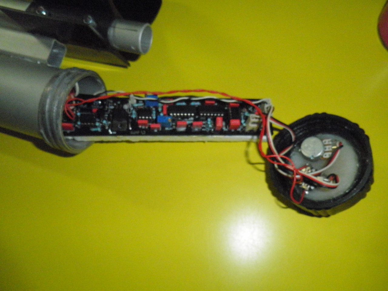

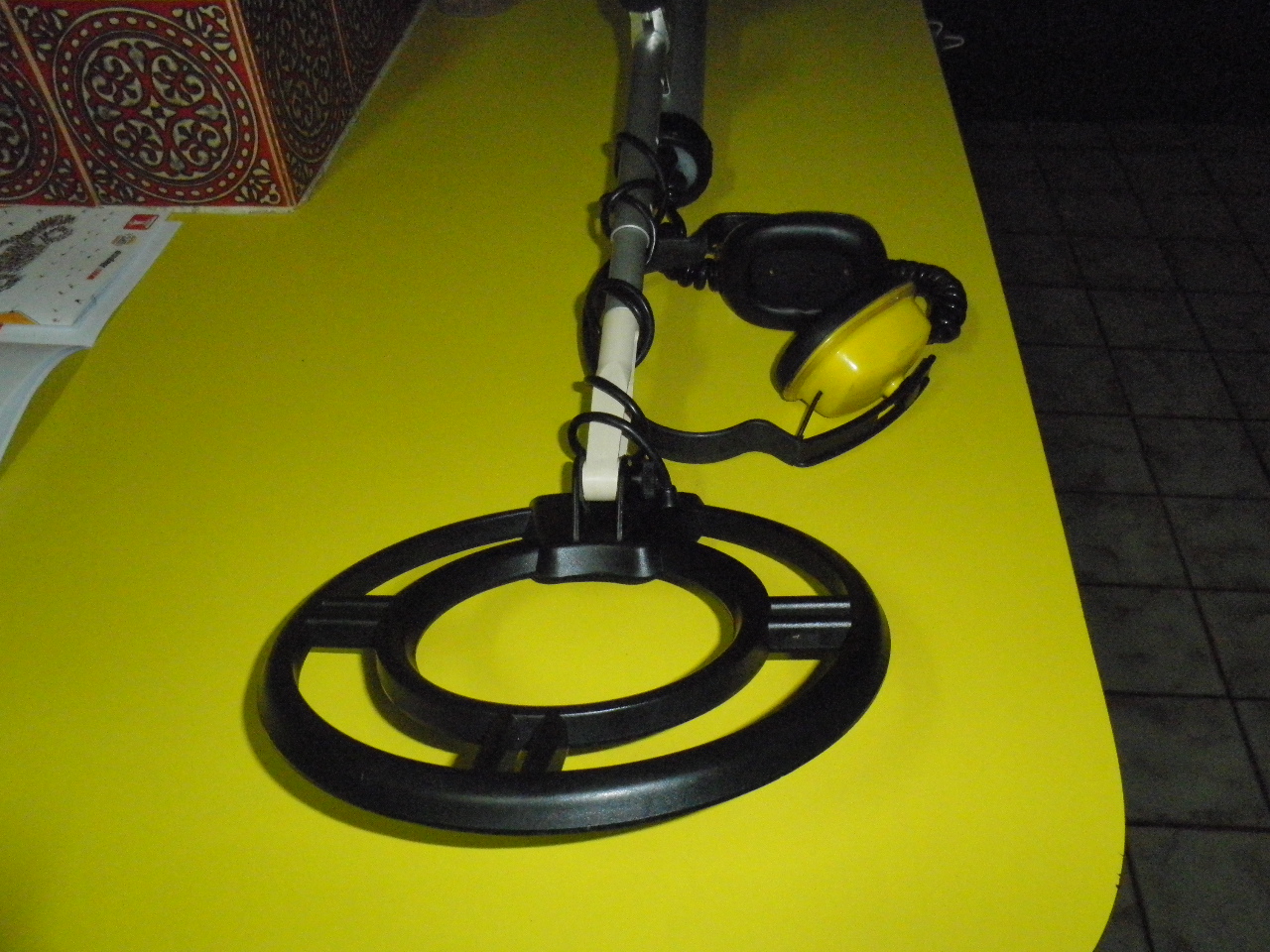

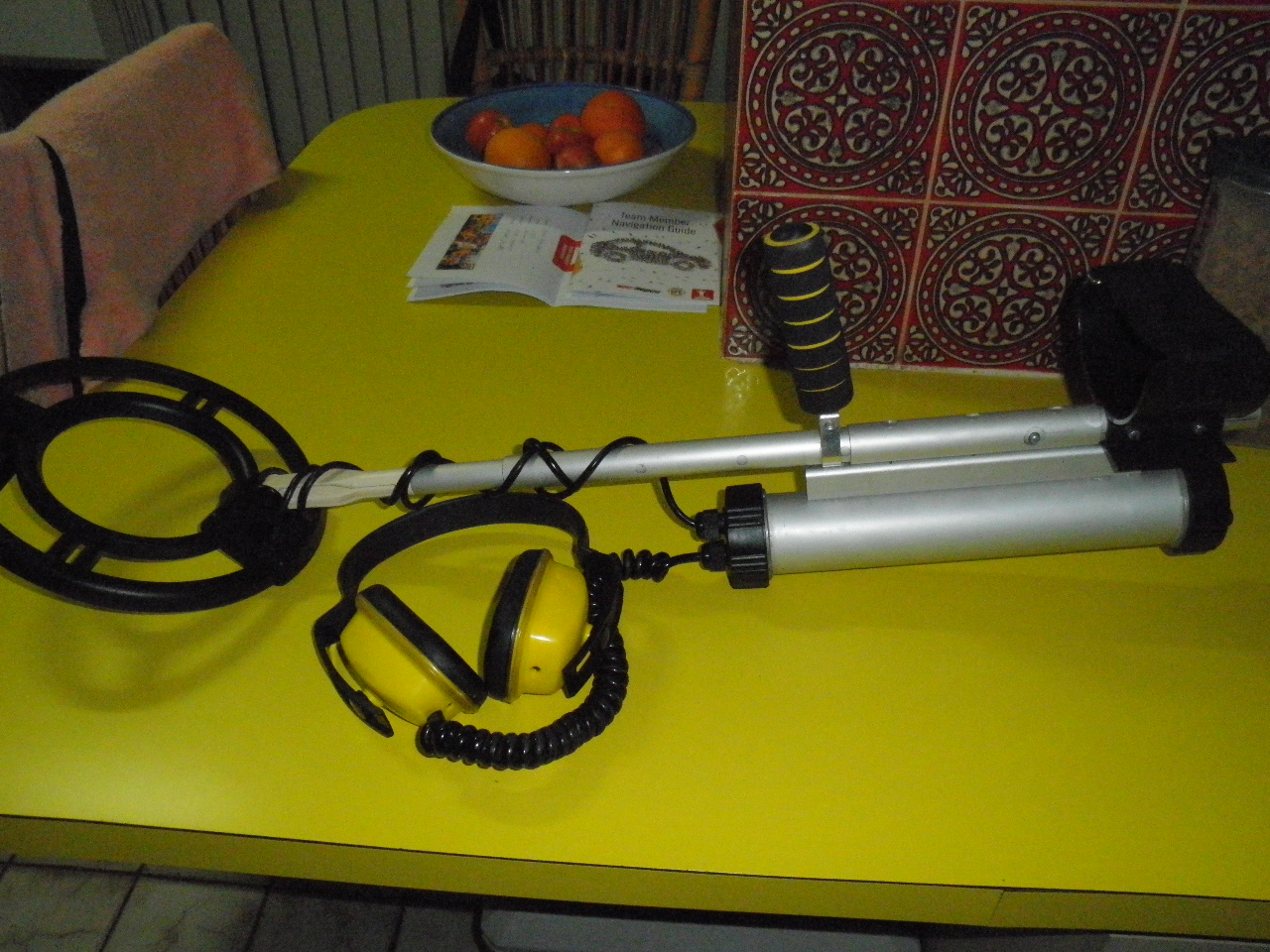

                    • new coil an old one die grinded it out re resined it 11 turns with the wire out of old whites coil works great and looks great

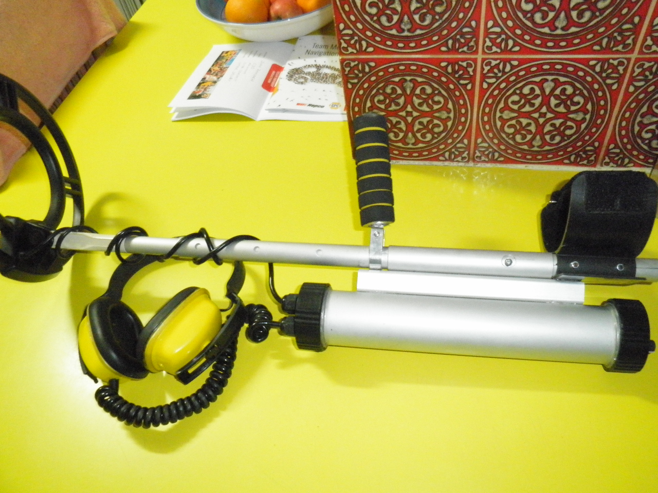

                            • i looked everywhere and then found this $11 au .had to cut it down heaps and pop rivet ends on with sealer so its water proof cut 2 end caps and c4 auto tranny pump seal perfect size .8 aa batties

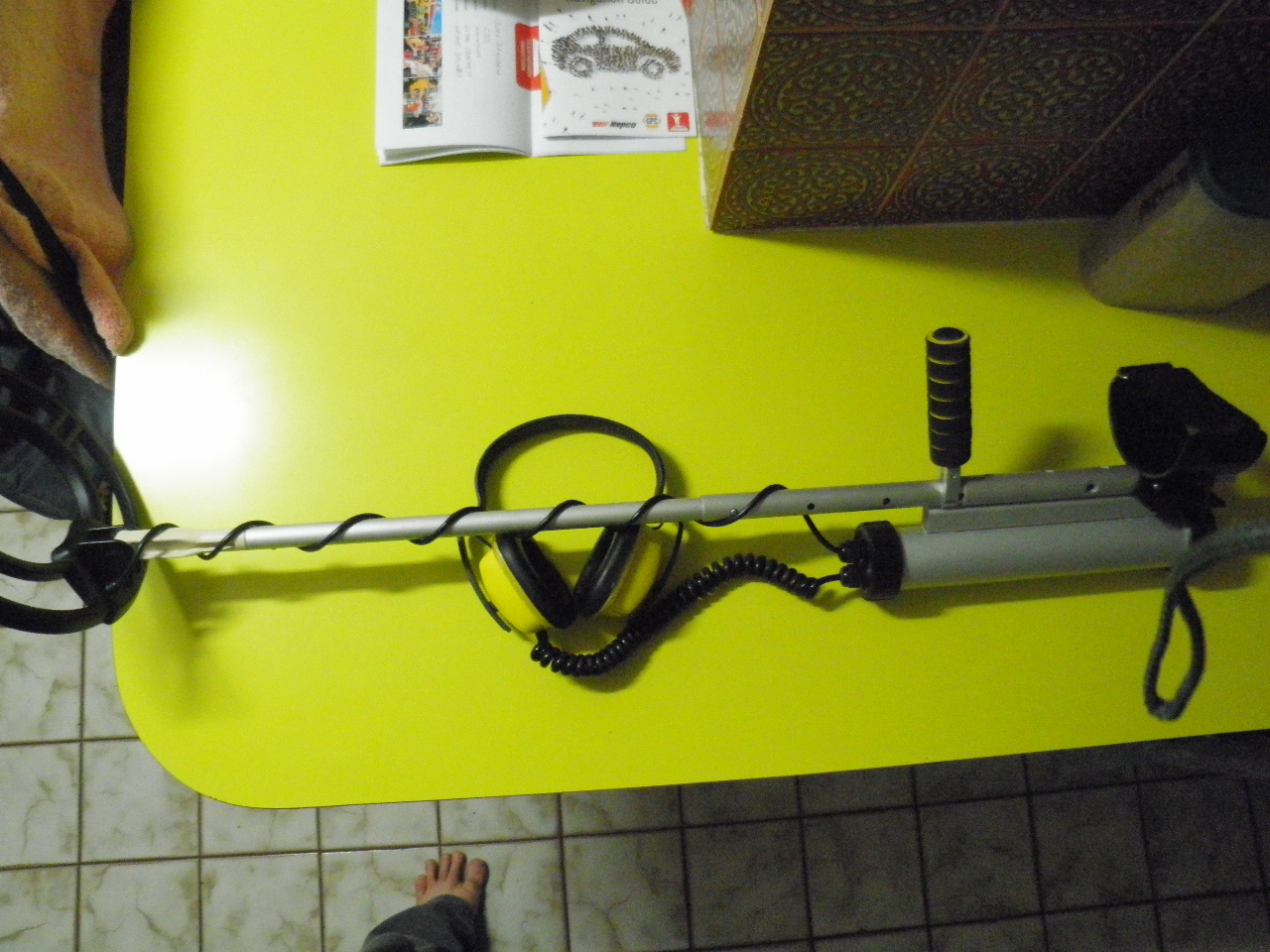

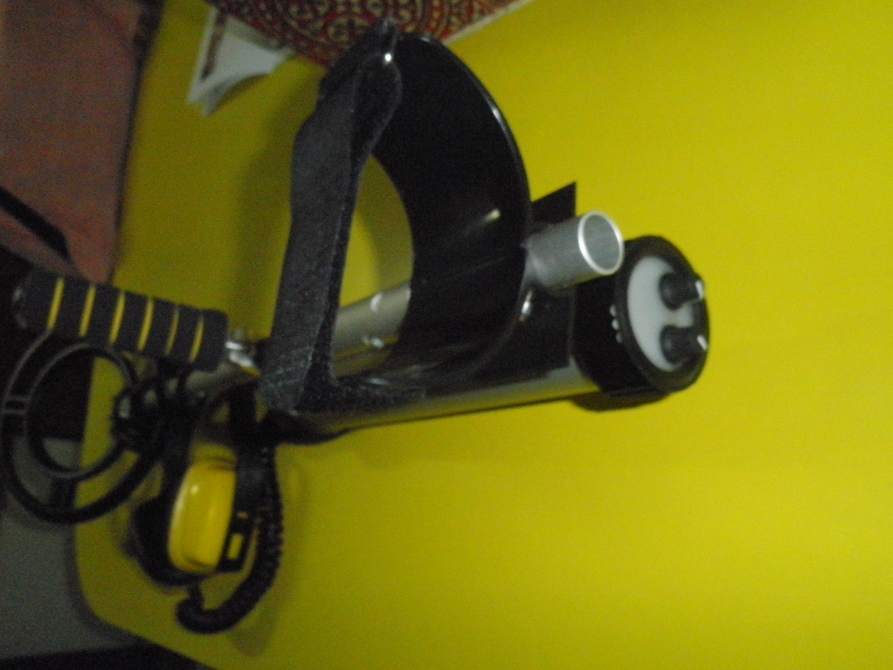

                              • everything housed in tube and comes apart for waist belt one bolt to take apart
                                earphones are ear muffs with two buzzers sealed still quite loud under water on full vol
