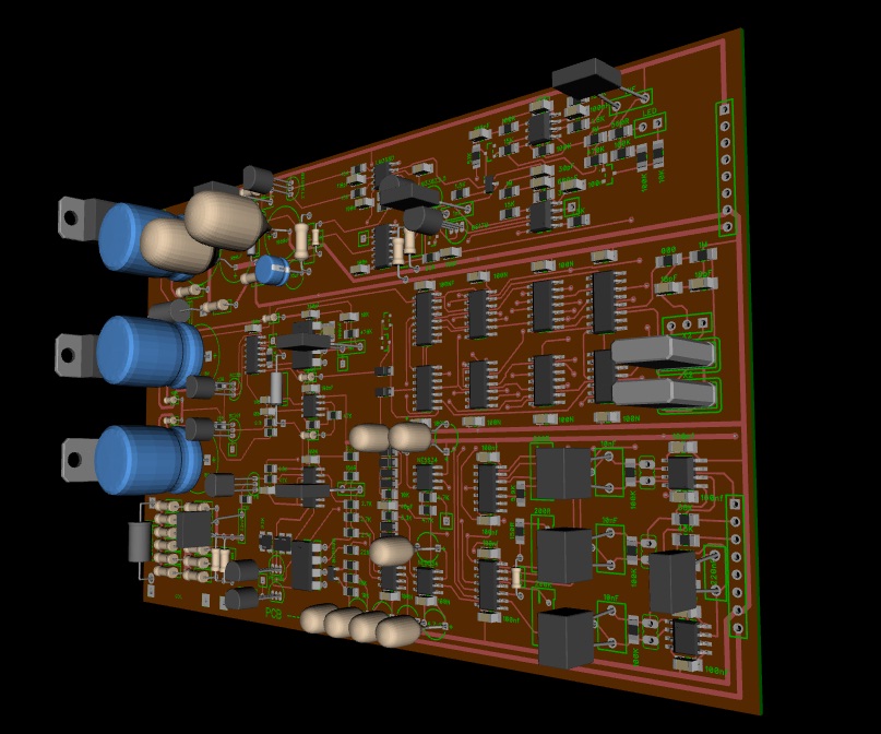

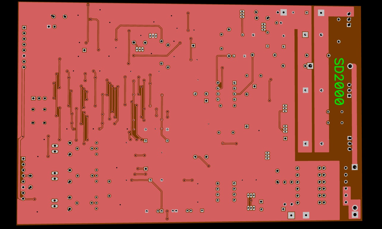

      Here is my PCB, for now i only finished main board i am working on this abouth one month, audio board is not complited yet.
      When i finish all and make one working device i will post all documents needed for building.

          What software did you use?
          Do you have source files to this project ?

              Looks great, better than those from source. Congratulations.

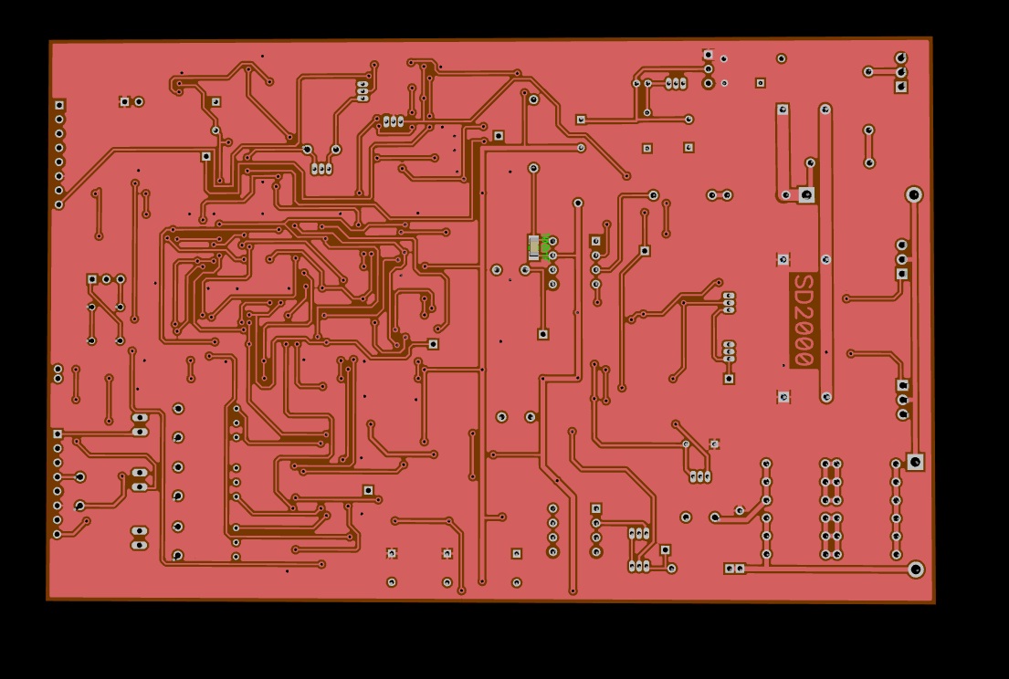

              Can you post view of bottom side too?
              Why you decided to mix SM and TH design?

                Thank you WM6
                I just try to match the original,
                Here is bottom side

                  Thats a nice tidy board, i hope it works for you. Make sure you thoroughly check your drawings for errors. Good to see you got bypass caps to i.c's which are not shown on zed's schematic. If anyone is using hole through components, take careful attention of pins on lt1057 - they are not identical to that of a smd package. I drew my boards on autocad and ironed on the artwork. I used 1/2 watt metal film resistors throughout except for a few 1/4 watt carbon film. Use a high capacity battery as the unit draws approx. 600ma. - i decided to used a 12volt sla battery with a regulator set at 6volts.
                  I thought of making a smd version later on, but I'm quite happy with my creation. I'd rather save my money and get second hand gp/gpx minelab. I have been making electronic gadgets for over a year and this has to be the best project so far.

                    For draving PCB i used Diptrace, it is god software, no way to make mistake, simply you can compare schematic to PCB and nets too, pretty handy software.
                    When i start building this machine i will use high quality components, ultra lov noise OP amps, +- 1% resistors etc etc.
                    When i finis device i will share whole project as i said.
                    Also i am planing to make another version with MCU (probably PIC) with programed timings etc etc...

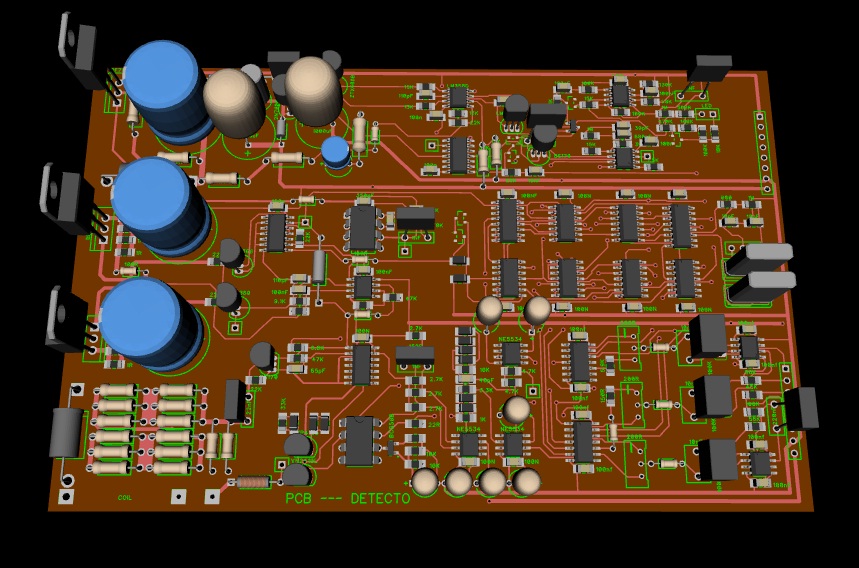

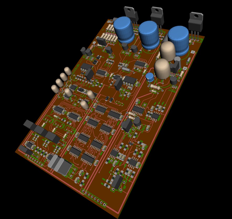

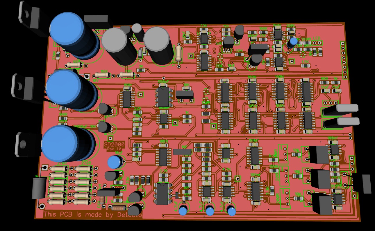

                      SD2000 PCB UPDATE
                      Here are my last updates.
                      Soon whole project will be complited. (with no errors :P )
                      Afther that i will build SD2000 according to PCB also i will share results and clear PCB files.

                        Enjoy to look at your work detecto.
                        Did you found all parts needed for SD2000 pcb in DipTrace parts library or create some parts by yourself or you use compatible shape parts replacement?
                          Diptrace alredu was have almost all parts, except polarized caps and couple connectors.
                          It's easy to create any part using pattern editor.
                          Also i served with couple shapes.
                          I strongly recommend DipTrace, generaly i am new with DipTrace, but i like it from first use.
                          It's almost impossible to make error when converting schematic to PCB
                          Option compare to schematic and check design rules is worth of gold :P
                          BTW PCB drawed like this have less noise on output than original SD2000
                          As you can see from PCB i use big continuous GND plane and it is very good for high gain cct.

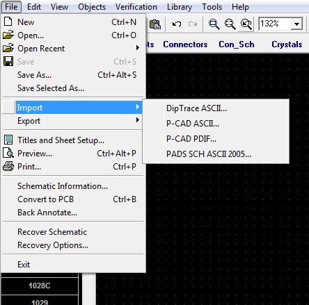

                            Where did you get dip trace? will it except other format circuits without having to re draw them?

                              You can find DipTrace here===== http://www.diptrace.com/download.php

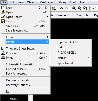

                              Here is what you can import and export from and into DipTrace
