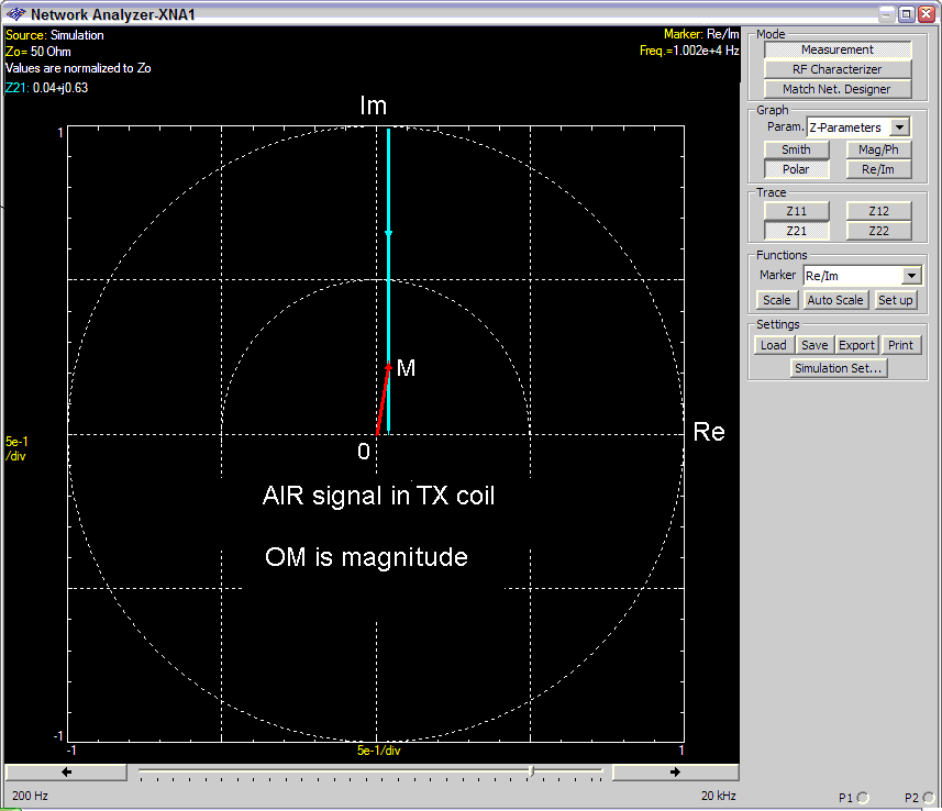

              AIR signal in TX coil
              Each TX coil is self-inductance, ie it operates as MONOCOIL and receives maximal possible AIR signal. The simple circuit in post # 42 shows TX coil as two-port network.
              The attached image illustrates how NETWORK ANALYZER displays transfer function Z21 of MONOCOIL (the worst sensing head for metal detectors ;-). It has Re component at all frequencies equal to resistance of TX coil. To calculate Re and Im component of AIR signal, you should multiply Z21 (shown in upper left angle) to Zo (scale factor).

                • #53
                  It is not technically correct to define monocoil parameters using network analyzer and transfer function. With good enough model, RF transmission line response can be derived this way, but that is useless. In normal PI operation, coil is “time divided” between TX period and receiving interval, only signal remaining is coils own LRC decay and tail due to eddy current decay in coil material. Nothing remotely similar to AIR signal, rather COIL signal, so to say.

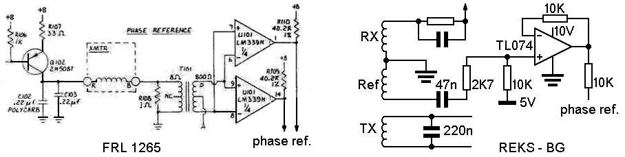

                    AIR signal as PHASE REFERENCE
                    Most designers of metal detectors prefer to use voltage across TX coil as phase reference for synchronous demodulation. For this purpose, they use a wire between TX coil and reference SIGNAL processor in RX. This makes the RX "nonwireless". However the NETWORK ANALYZER shows that voltage across TX coil is not the genuine AIR signal.
                    We need a genuine carrier wave to make proper demodulation and discrimination.
                    Dave J. uses in FRL 1265 a small audio transformer as current sensor. It generates carrier wave for two anti-phase reference voltages.
                    To make RX operation "wireless", Bulgarian designers use a DD search head with Ref winding as shown below. It receives the genuine carrier wave and this voltage is used for reference. However this design solution requires an additional wire in connecting cable and additional pin in cable connector.
                    • #55
                      Please note that a transformer is not needed because a common mode of LM339 inputs includes a negative supply rail. I didn't test it though.
                      • #56
                        I think Dave J. is participant of our forum and can explain this. However I prefer the Bulgarian solution because it involves GND signal as carrier wave for TGT signal.

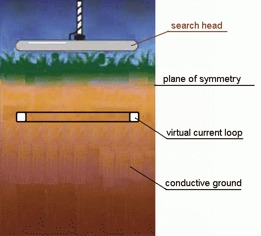

                          Conductive GND signal
                          When a TX coil is above conductive half-space, the eddy currents produce secondary magnetic field. The configuration of secondary field is as if a mirror current loop is placed (buried) symmetrical to conductive surface.
                          Virtual current loop has the same diameter as the TX coil. This is illustrated below.
                          The inductance and resistance of current loop form a time constant or cutoff frequency that can be calculated with formula given in other thread:
                          http://www.geotech1.com/forums/showt...462#post104462
                          The measurements confirm a more accurate theory that there are more virtual current loops with 9 times and 25 times smaller diameter. Since their influence is weak, in order not to complicate the analysis, we will ignore them.
                          The received signal that secondary magnetic field induces in a coil, we will call GND signal. To get a clean GND signal, the coil must be plced in induction balance with the TX coil. In practice we receive a combination called AIR&GND signal. Most powerful AIR&GND signal receives the TX coil, therefore the MONOCOIL proved most inopportune search head for metal detectors.
                          We can use NETWORK ANALYZER to explore the conductive GND signal. The method of study of conductive nonferrous object with a time constant was explained in another thread:
                          http://www.geotech1.com/forums/showt...773#post100773
                          • #58
                            The transformer seemed like a good idea at the time: and, it did work well.
                            --Dave J.
                            • #59
                              Hi Dave, I'm so glad to see all the key people in metal detecting design are here on this forum.
                              BTW, I do not doubt that transformer did well - my idea is to avoid parts that are difficult to come by, and in this case it is a transformer. Detecting a coil current by comparators to set a 90° phase is a brilliant idea.
                              • #60
                                Probably there is not much difference between current transformer and extra coil approach for reference generation. In order to get any valid reference at all, extra coil must be relatively closely coupled to TX coil, then ground influence to resonant tank parameters will be about the same, except usual 90deg phase shift generated by current sensing. (Also, in Fisher, TX is quartz derived, Bulgarian design is self-oscillating)
