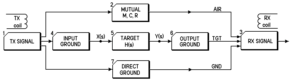

            WHERE IS THE CARRIER WAVE?
            To identify target, we should calculate its transfer function H(s) illustrated in the functional diagram attached below. In frequency domain, the calculation seems easy:
            H(s)=Y(s) / X(s)
            (like to calculate gain of an amplifier - simply divide its output to input).
            However in time domain the calculation of target characteristic is dificult. The name of transfer function is "impulse response" and it is calculated by a math operation called "deconvolution". [ If you know somebody who is participant in MadLabs Inc.(c)(tm)(r), he can explain this to you ]
            The problem is how to design phase reference in a narrow band metal detector. To make carrier recovery we should know where the carrier wave is?
            When search head is lifted far from ground and there is no target, we receive AIR signal and it is the carrier wave.
            When tere is target, the TGT signal appears as modulation with side band of AIR signal. This is true if we make AIR TEST of a metal detector.
            When search head is lowered to ground and there is no target, we receive AIR&GND signal. The Bulgarian designers of REKS think that AIR&GND signal is the carrier wave and they use it as phase reference. However this not true. Functional diagram illustrates that transfer functions of blocks 4 and 6 are involved in TGT signal (We should use MaDlab to solve the problem :-) .
            • #66
              Some ~10km away at these frequencies. In terms of radio we are speaking of near field. Actually very near field because our antennas have effective height of <<<λ. Also the mirroring effect does not function in the conditions of electrically soft surface. There is no reflection, hence there is no hard surface.
              Otherwise the diagram is OK.
              An electromagnetic wave initiated by lightning - which is a phenomenon of kilometre dimensions just right for the job, can interact with a plasma in ionosphere that consists of heavy particles that remain of the meteorite impacts, and create an "plasma wave" by exciting the plasma particles with their energy. When the heavy particles are excited, the ions, we get a ion wave that is electrostatic in nature (i.e. cyclotron movement) or electromagnetic nature (Alfven or Magnetosonic waves). These waves pick up energy in ionosphere by means of accumulated energy in ions and travel much slower than light, the entire Earth ionosphere is their "resonant box" and that's why we have so much EM noise in VLF.

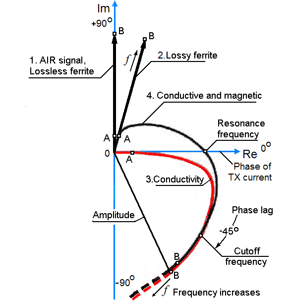

                    TWO FREQUENCY METAL DETECTOR
                    Let TX creates magnetic field with two frequencies A and B. Attached figure illustrates where points A and B appear in complex plane. The low frequency point B forms a signal with small amplitude OA. The high frequency B forms large
                    amplitude OB.
                    AIR and lossless ferrite signal
                    Points A and B lie on straight line 1. Both amplitudes OA and OB have phase angle + 90 deg relative to phase of TX
                    current (Re axis).
                    LOSSY ferrite signal
                    Points A and B lie on straight line 2. Both amplitudes OA and OB have phase lead almost but less than + 90 deg
                    relative to phase of TX current.
                    Signals from iron meteorites, hot rocks, bricks, terracota, dry clay and dry magnetic soils lie in 1st quadrant on straight
                    lines 1 or 2. If a signal, at two frequencies has the same phase lead angle, that means the object is magnetic and has
                    no conductivity.
                    CONDUCTIVE substance
                    Points A and B lie on straight line 3. At the frequency A, the amplitude OA has small phase lag relative to TX current. At
                    high frequency, the phase lag of amplitude OB is increased, but it is less than - 90 deg. Signals from nonferrous metal
                    objects and conductive nonmagnetic soil lie on line 3.
                    COMBINATION of conductivity and permeability
                    Each point on line 4 is vector sum of points from line 2 and line 3. At low frequency, the amplitude OA has phase lead
                    less than 90 deg. At high frequency, the amplitude OB forms phase lag less than - 90 deg. Note that there is a
                    resonance frequency which point lies on Re axis.
                    Signals from magnetic ferrous metals and magnetic conductive soils lie on line 4.
                    Both lines 3 and 4 have points with cutoff frequency at which the phase lag is - 45 deg.

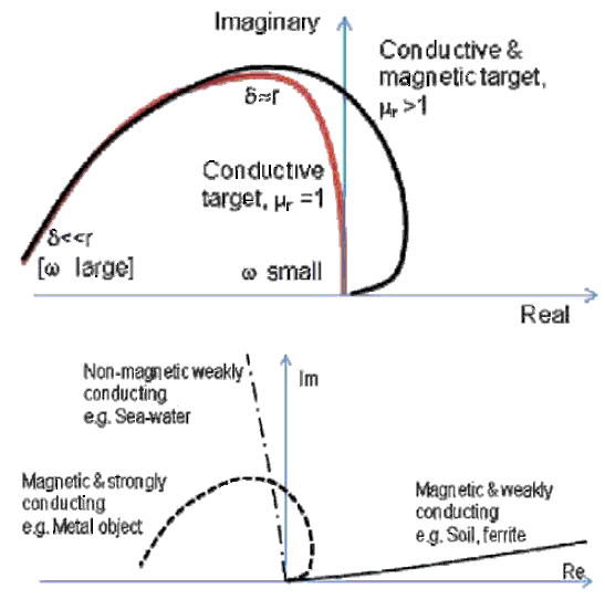

                      When illustrating theory, I plot the locus of conductive targets as that of a simple LR circuit target. R constant, reactance proportional to frequency. With such a target, max amplitude of the resistive component occurs when the magnetic loss angle is -135 degrees (electrical loss angle 45 degrees), at which phase the vector length is 0.707 of the amplitude at infinite frequency (and the magnetic loss angle is -180 degrees).
                      Real targets aren't simple LR circuits, but to explain how and why, the LR model is the starting point.
                      --Dave J.
                      • #71
                        Dave, please make a drawing!
                        Do you mean as is illustrated in attached publications? Their authors mean that AIR signal induced in TX coil is the Re axis.

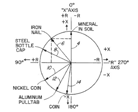

                        • #72
                          I don't have a drawing, but the one you posted a couple posts back was fairly good. However you didn't specify scaling nor did you state what sort of nonferrous target the red curve was intended to represent.
                          If the intent of the red curve was to model an LR circuit it should have been a semicircle in the lower right quadrant, the diameter of the semicircle equalling the R component of LR. Then you drop the whole chart into a circle of unit radius. The end result looks a bit like a Smith chart.
                          I often embellish the chart with vectors corresponding to the signals of specific targets at specific frequencies.
                          Many metal detector patents have phase diagrams and in most cases they're reasonably correct. However you'll run into a metal detector industry convention where, when phases are plotted as magnetic loss angle, zero degrees is vertical (the ferrite axis), and the loss vector rotates clockwise. Although this is not how trig is taught in school, in the world of beeps this abuse of what professors taught us is very useful because it's how you make magnetic and electrical circuit phase diagrams plot on the same axes and quadrants so you don't get screwed up switching back and forth between the domain of magnetic fields and the domain of circuit design. What is real in magnetics is imaginary in circuit analysis, and vice versa.
                          [edit] I'd suppose that the C & Q Beeper Bible includes phase diagrams, but I don't have a copy handy right now to check it out.
                          --Dave J.
                                Locus 3 in post '69 relates to a target which is not anular. The locus is scaled in normalized form.
                                FOR BEGINNERS:
                                Anular means something like ring, donut, bracelet, shorted turn of wire.
                                If anyone wants to know what means "normalized form", can use the following URLs:
                                http://www.uni-magdeburg.de/iwfzfp/EC/en/EC_fxEddy.htm
                                http://www.geotech1.com/forums/showt...1570#post71570
                                http://www.geotech1.com/forums/showt...047#post104047
                                http://www.geotech1.com/forums/showt...230#post104230
