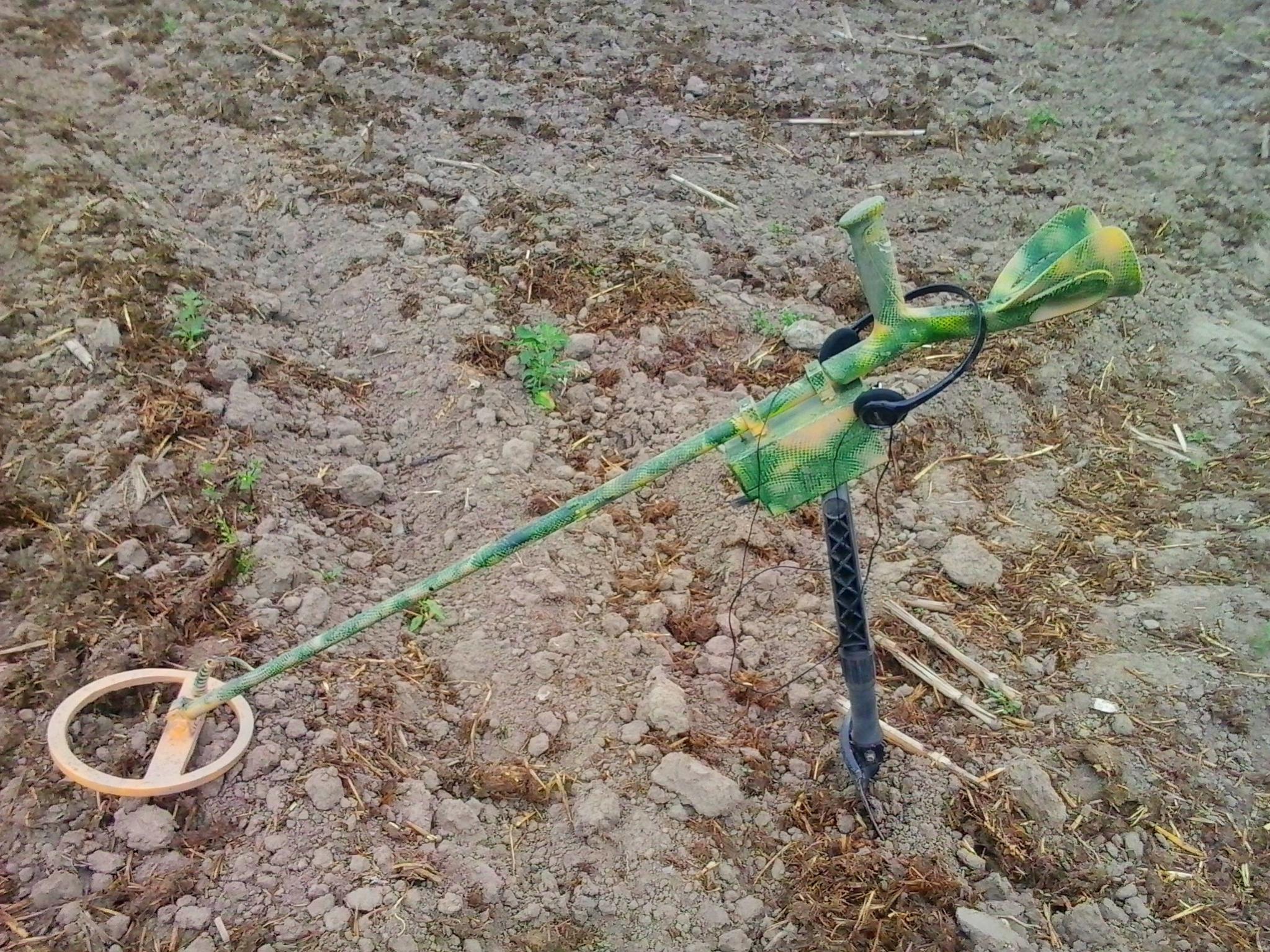

                • Field test of latest build with another elbow crutch / carbon fishing pole combination:
Name:	2013-06-16 17.17.50.jpg
                  Since this detector does not discriminate I had to dig a lot of iron trash together with some WW1 remains during this short field test.
                  Have fun,
                  - Bernard
